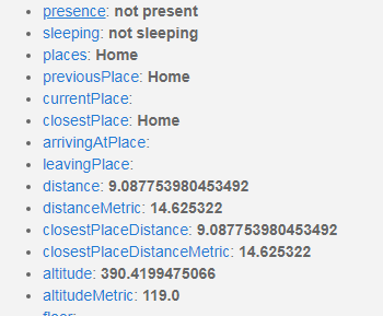

Webcore Presence sensor does not display each of my places in the smartthings api
I am trying to have my phone text me when I approach locations that I have setup in the webcore app under settings/places (I have 4 places)
Currently the webcore presence sensor can tell me I’m away from home and the distance away from home.
CurrentPlace and ArrivingatPlace never seem to have any values
Places only seems to have 1 value.
I did go back into the webcore app on the phone and hit apply to try to update the places but had no luck.

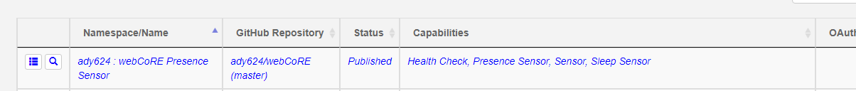

Are you sure that is the correct version of webcore?
this is what I have…
That picture is showing Device Handlers… I was talking about updating webCoRE as a SmartApp, and webCoRE as a phone app. (although it can’t hurt to also check the DH)

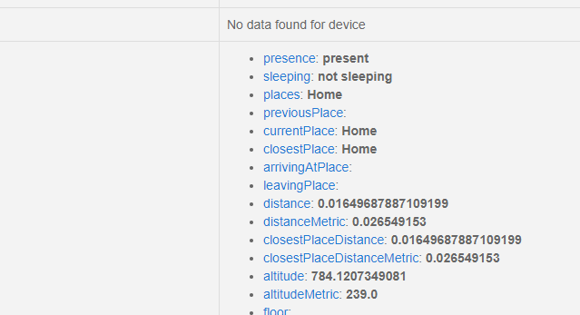

The presence sensor seems to be “working” as it tells me when I am home, when I left and the current distance that I am away from my home.
Now that im home it I am present

Do you have multiple places in your webcore app and do they display in the places state of your webcore presence sensor?
