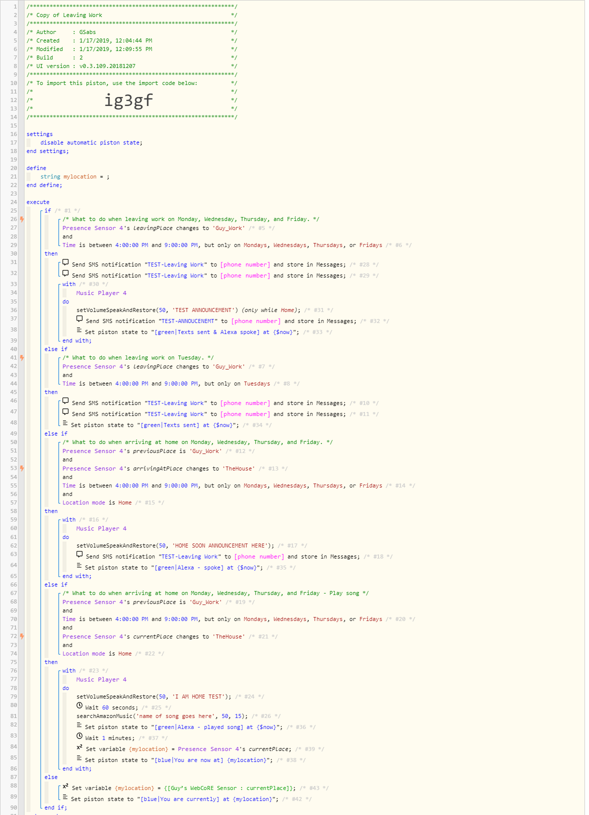

Creating a piston to do specific things when I leave work…
- Notify my wife.
- Play a sound on my echo.
Different things on each day of the week…
The problem is I don’t know how the WebCoRE sensor works, or stores information…
See the piston below, but the idea is to do different things each day when I leave work.
This is the basic idea, but I want to expand on this going forward.
The piston seems to be working, but it doesn’t appear to store ‘leavingplace’ or ‘previousPlace’ for too long… So when I use that in my 3rd and 4th IF statements, it doesn’t work.
…had it turned off! ugh…
