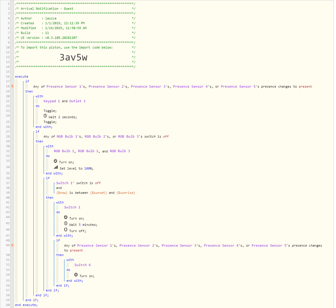

I am new to webcore, I would like to make sure that I am structuring things correctly
I have an if statement at the top. These are presence sensors to detect when certain people arrive. Based on their presence, I would like lots of things to happen. For example, the first thing that happens is a two lights will toggle on and off. The second thing that happens is our cabinet lights turn on to 100%. The third thing is our outside lights turn on (after sunset) for 5 minutes and then turn off). And the final thing I have set up is that a virtual switch showing that someone is present is switched on. What I am not sure of is the structure that this is. It, just doesn’t seem right the way I have it but maybe it is, looking for any help and input to keep it as simple as possible.
