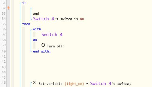

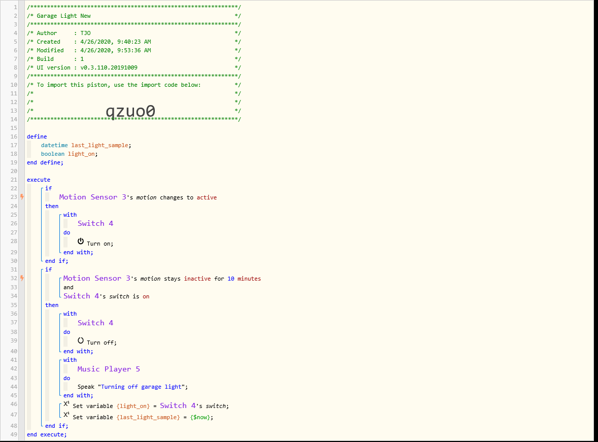

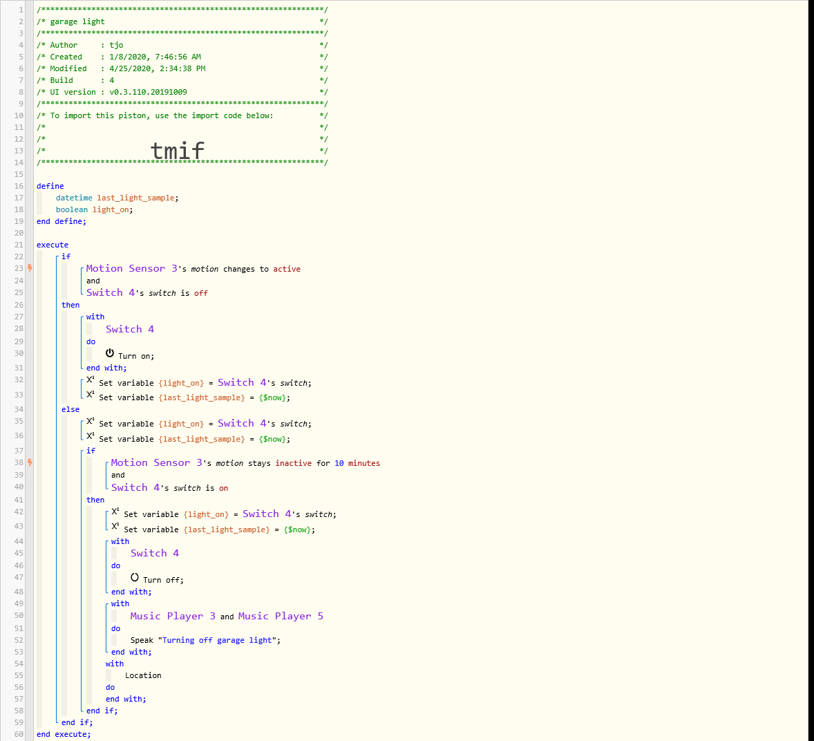

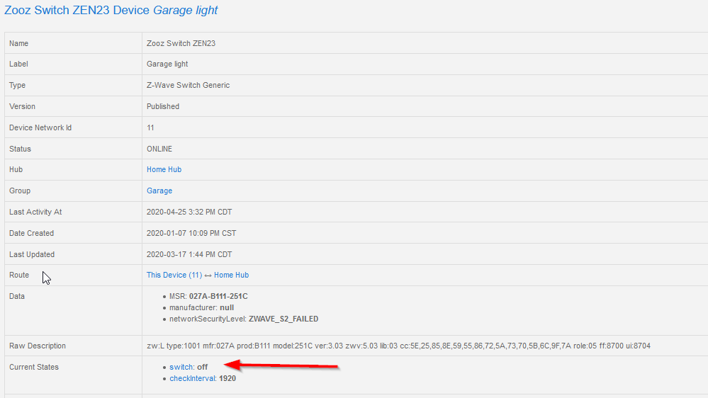

My garage light will be turned off if no motion AND the light is ON. Alexa will announce when turning off garage light. Well it keeps announcing turning off garage light … I’ve checked and smartthings on the web and the app, say that the light is off. I added a capture of the state of the light and timestamp when it goes down the leg where no motion and light is on and the variable says true (light is on)…
properly read the state of the light switch
detects light is on, when it is not
