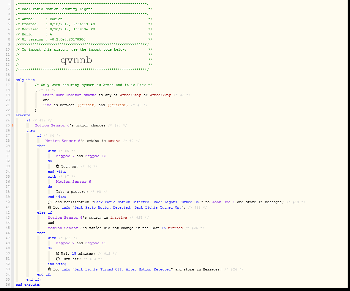

With Rboy’s Blink camera manager and device handlers you can ingrate the cameras into smartthings. Once there it is no issue to use them in webcore. In order for them to detect motion they have to be armed. Here is a small piston I created for my back yard to turn on the back lights if motion is detected.
Thanks… this was a huge help. With this I was able to figure out how to setup my own piston and half way understand what I was doing
