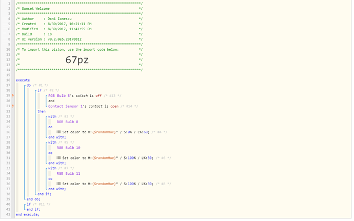

Hello,
I created bellow piston that welcomes visitors after sunset, with (random) lights.
But all the lights choose the same random color (ex: all the lights randomize to red). I want the lights to choose different random values. How can I achieve/approach that?
Thank you

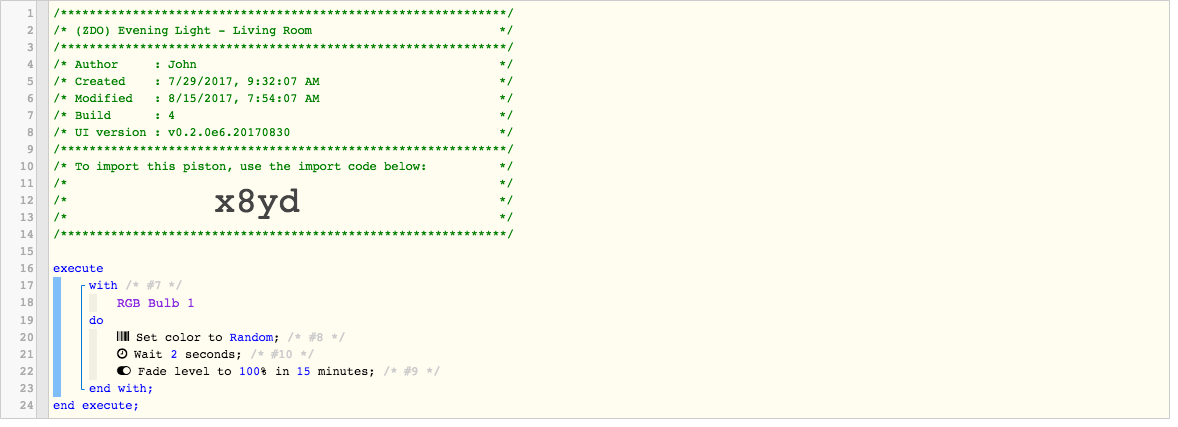

I use random color as well and I almost always get the same color. Occasionally I’ll get something new but not often. (I know this won’t run by itself. It gets called from another piston)

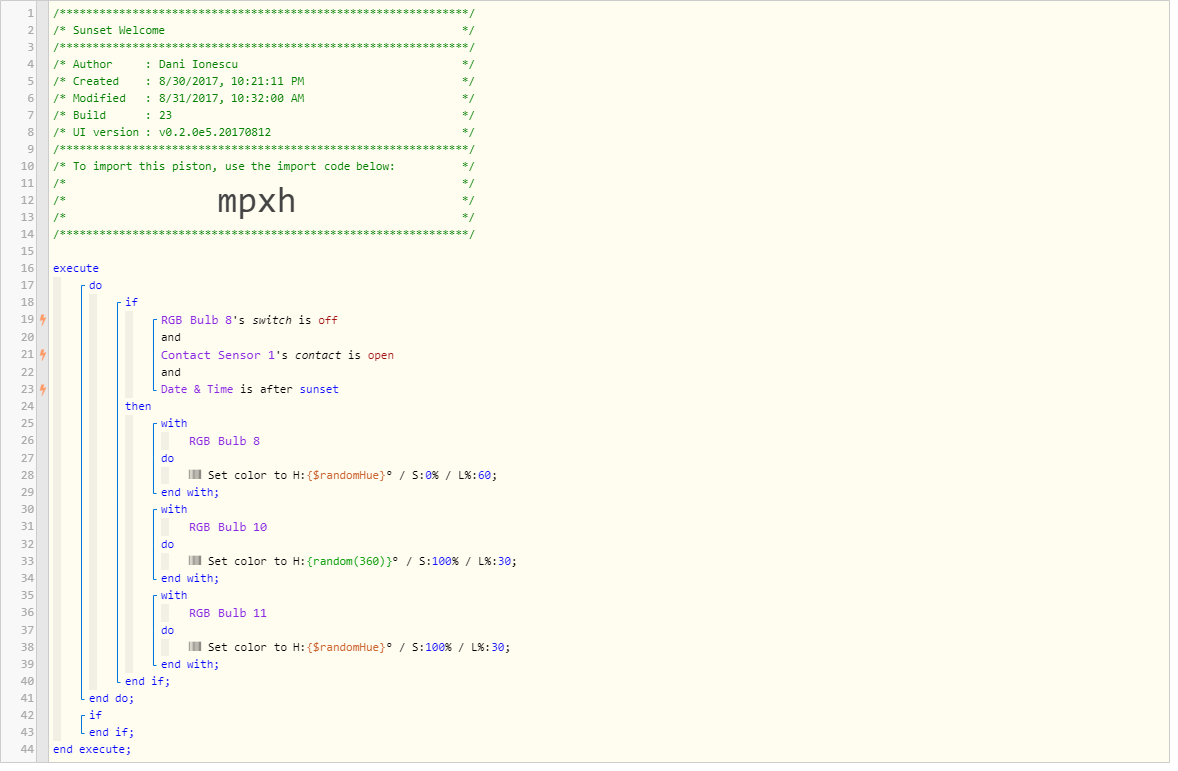

I have not verified but if hue is 0-360, you can just use an expression random(360) instead of $randomHue
Edit: it worked the first I tried, now I’m getting the same values lol
Edit2: Much better…

Setting a color from 2 moves (color and level) is not my favorite approach.
Hi eibyer.

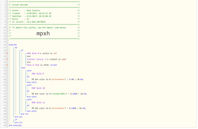

I modified the piston like bellow (line 31) and now it does what I wanted.
Thank U.
