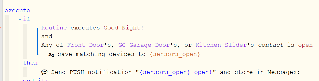

You can write what device caused the trip to a variable and then send a notification:
This is what I was looking for, thanks, I’ll try that.
Won’t $currentEventDevice do that as well?
