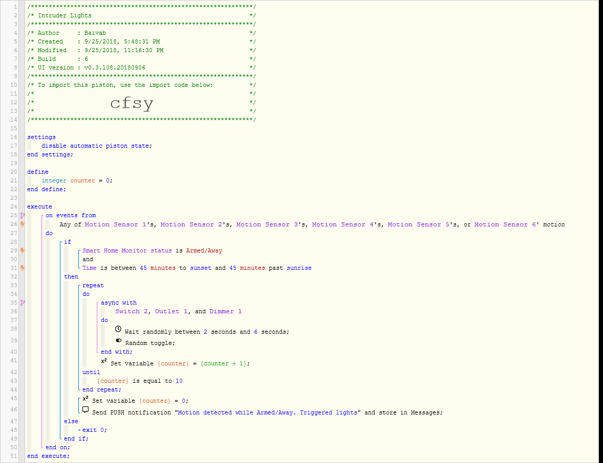

What is wrong with my 1st. piston - vacation lights (intruder) alarm
Its causing the default SHM to fail and become un-responsive.
In vacation mode, if intruder randomly toggle available lights.
Not working
You’re probably better off using
If any of Motion1, Motion2, etc... becomes active
  do stuff
