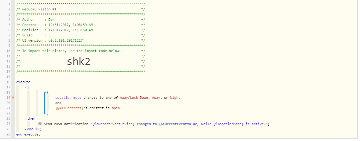

What variables should I using for this PUSH?
My PUSH is not what I want it to say. If the mode changes and a contact is open. I want to know what contact is open during which mode.
If the mode changes and a contact is open, “I want it to say Contact #1 changed to open/closed while current mode is active.”
I guess instead of “changed to” I should put “currently” since it already changed but whatever.
If I change from Home to Night it says:
“Home changed to Night while Night is Active.”
It doesn’t provide the sensor that is open and the status of the sensor, which would be “open.”
$currentevent* represents values from the device that triggers the piston. the piston uses location as trigger so the values you are seeing represent a location event.

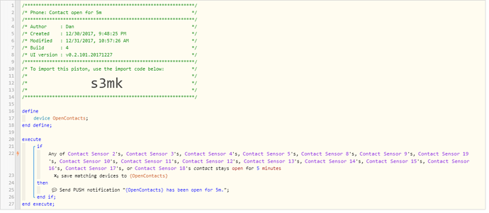

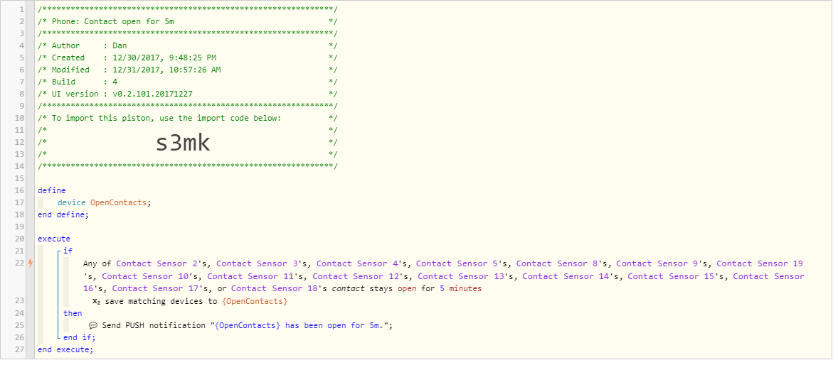

look under options to save the list of contacts that match the if condition of open to a device variable then use that device variable in the notification.

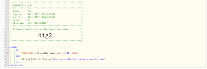

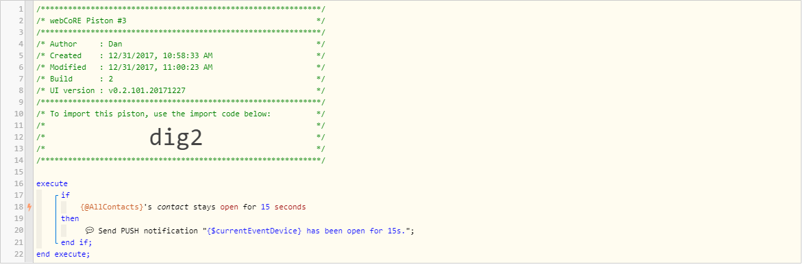

I basically want a PUSH when any contact is open for 15s.
The problem I have is that if there are five contacts open, I get 5 PUSHs that say the same contact has been open for 15s - it won’t tell me the different contacts that are open, only one contact and I get as many PUSHs as there are contacts open:

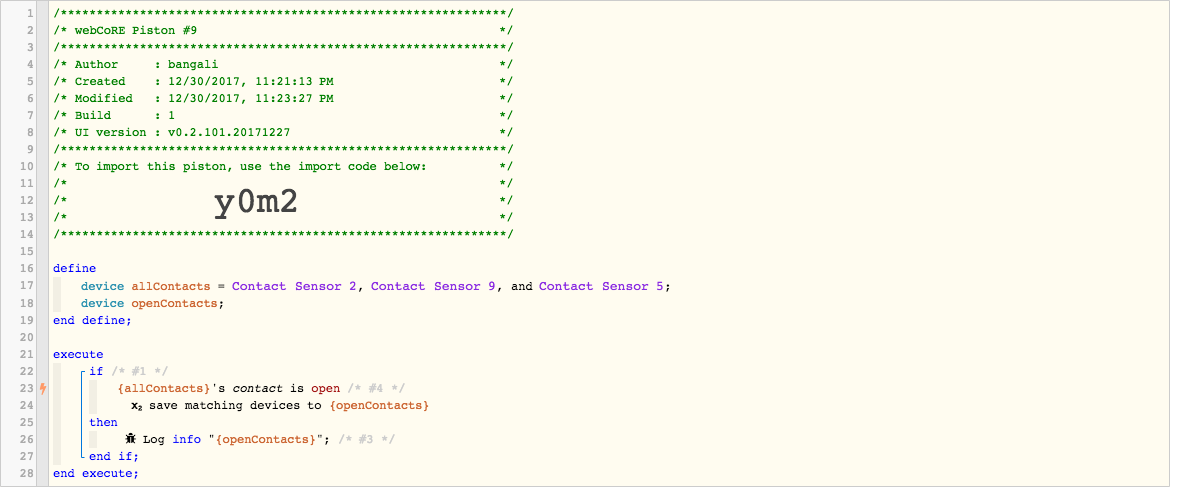

I tried a different way, log all the contacts that are open and store in variable. But if 5 contacts are open, I get the the same PUSH 5 times when I only need it once. I was thinking I put a WAIT after the PUSH but if a contact changes, it would cancel the WAIT.

in the first piston don’t save to opencontacts instead use $currenteventdevice
That’s what the first piston is doing.
I am using $currentEventDevice - then I get multiple PUSHs for the same contact.
not the first piston. in the other 2 pistons you posted afterwards.

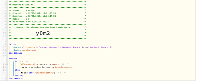

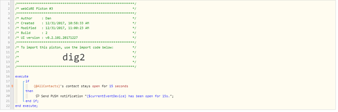

This one? I’ not saving.
Do you have a sample?
33af2acd51a863ebae98fe3007a14ef3ae20e96a_1_690x230
yes that one.
rather than using 15 secs try a longer interval like 3 mins and open a couple of contacts 30 secs apart and wait 3 mins.
The problem I have is that if there are five contacts open, I get 5 PUSHs that say the same contact has been open for 3m - it won’t tell me the different contacts that are open.
not sure what you mean. just tried this experiment and it seems to report each one correctly:
