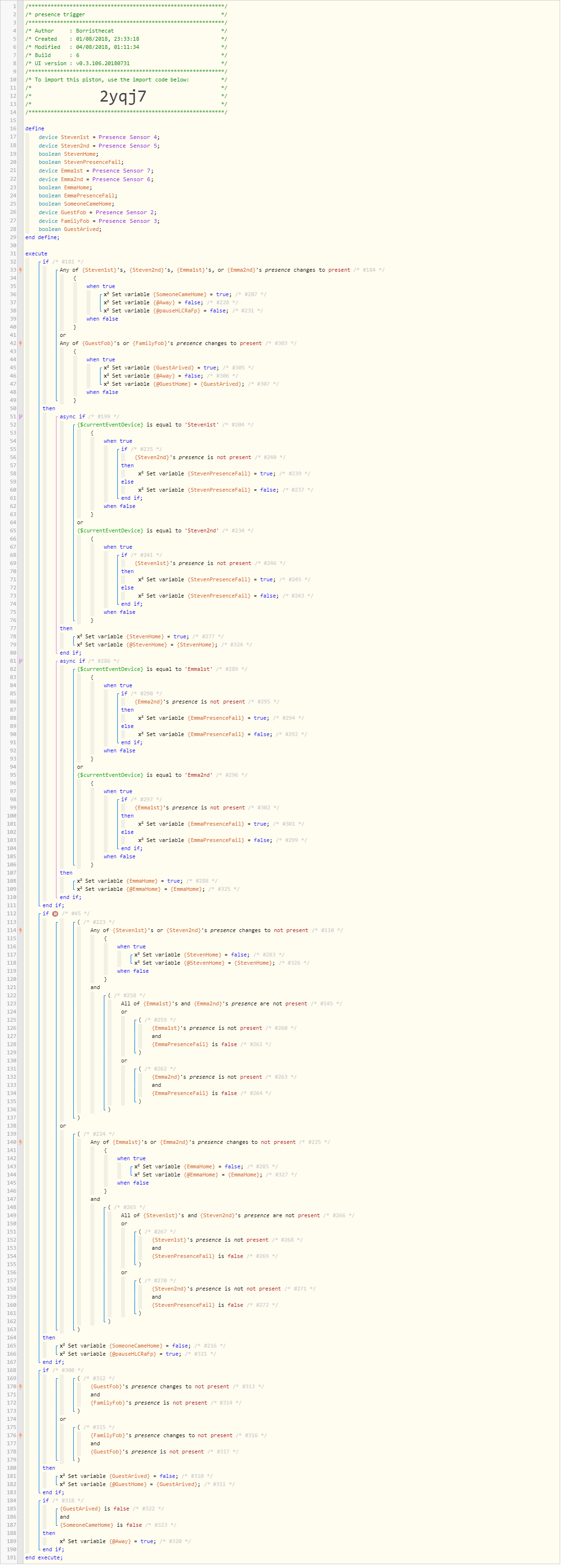

Cant get $currentEventDevice to work when I have my devices in variables
I want to find out what device triggered so I can set different variables depending
piston is triggering correctly, but $currentEventDevice isn’t working with them
I know its this as it works if I use the devices directly.

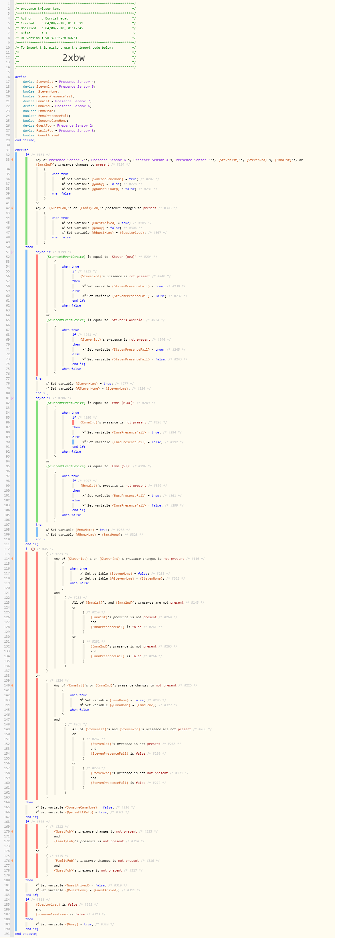

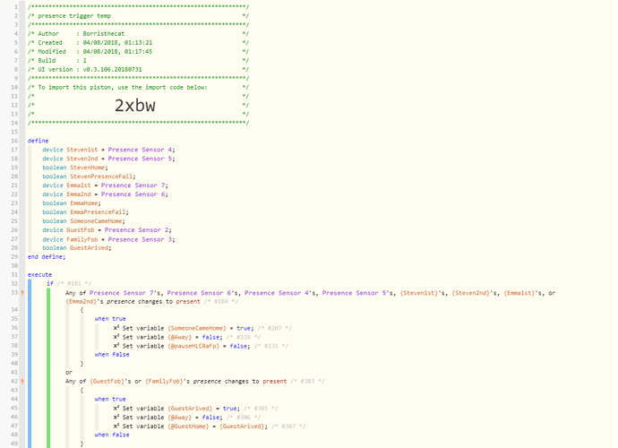

It does seem to be subscribing, it’s just not recognising the name. I will post my temp fix for it in a bit, but the idea was to make the piston neater with variables.

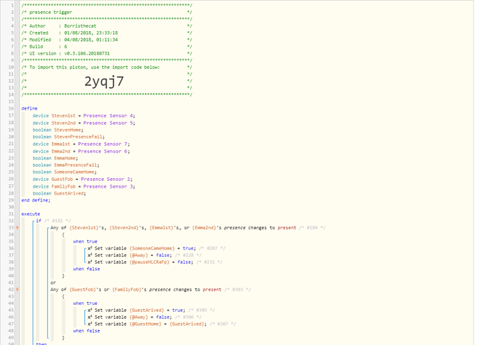

Just a guess, but in your original piston, it looks like you’re comparing $currentEventDevice to the string name of your device variable instead of the value of the device variable in lines: 52, 65, 82, 95.
Use {device variable} instead of ‘device variable’ and see if that works. For example, use {Steven1st} instead of ‘Steven1st’ in line 52.
