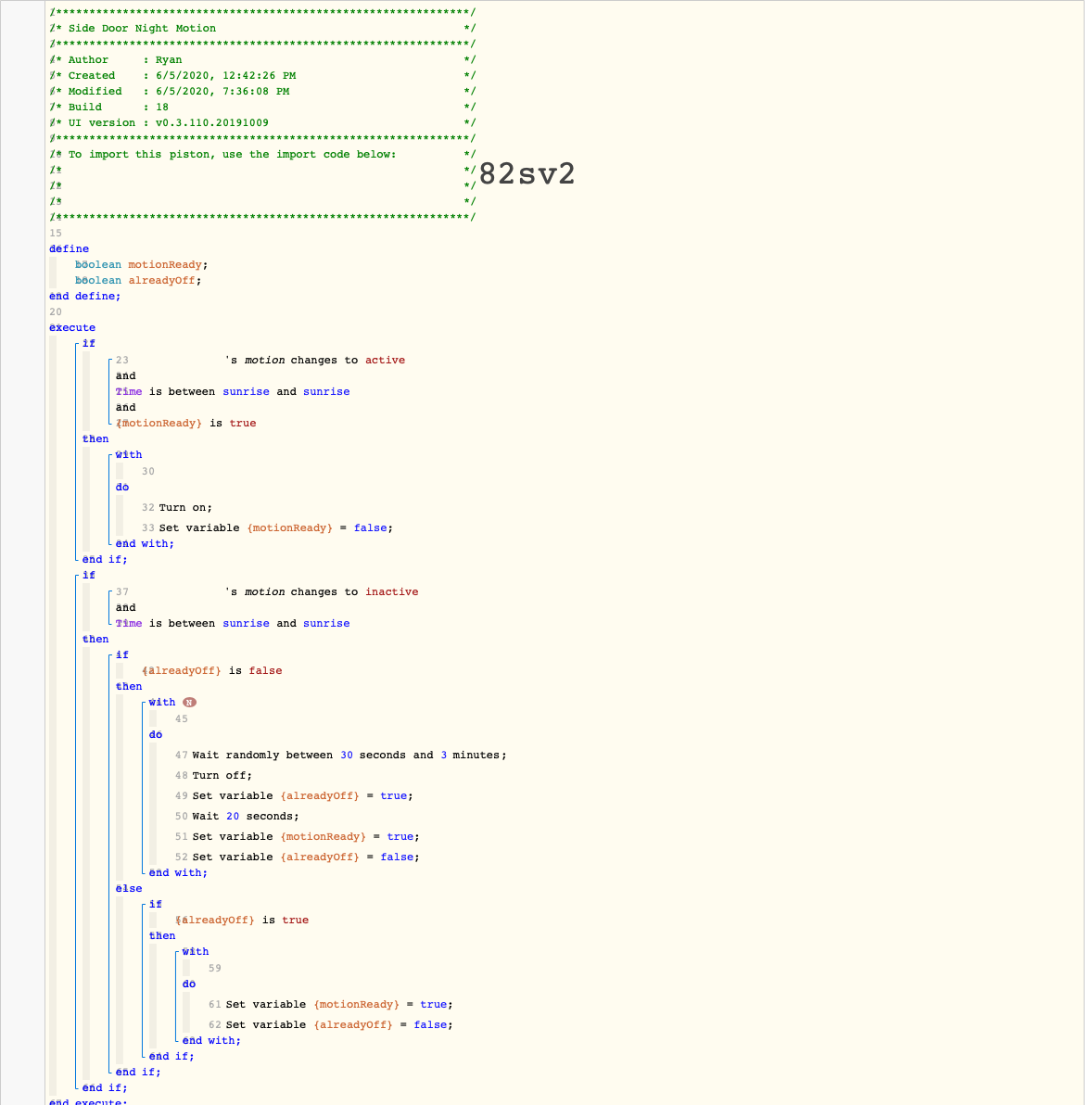

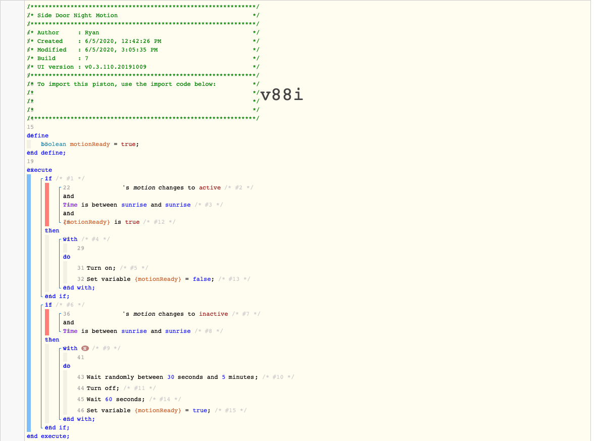

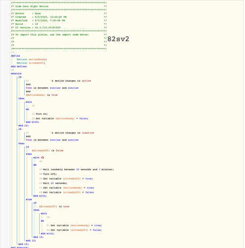

When motion is detected then light turn on/off
Overall goal is to setup a light to turn on when there is motion is detected. I’m trying to use an boolean to wait 1 minute after the light is turned off before trying to detect motion or my motion detector will think that the light turning off is motion.
PS. It should be midnight to sunrise. But my code is using sunrise to sunrise so I could test it.
It doesn’t appear that the boolean is ever set so if I go outside, the first IF statement is still triggered even though the WAIT is counting down.

OK, don’t laugh, but the easiest way is to angle your motion sensor a bit so the light will not fool it.
(although using a heat based motion sensor also works)
For example, this is bad logic for SmartHomes:
If DeviceA changes
    Then do something that changes DeviceA again
END IF
Every action will potentially create an additional trigger, meaning the piston will start all over at the top each time… (and infinite loops are no fun)
Note: I tidied up your log (but I did not read it)
You have set an initial value for your variable. That will be used every time the piston runs, not just once.
I ended up doing it like this. I also added a 2nd boolean in case there is motion during the “Wait 20s” so it won’t have to tick down the “Wait Random”.
