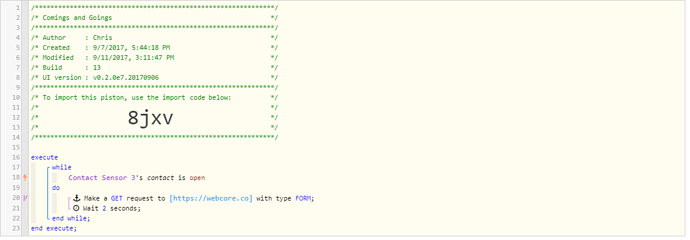

I’m trying to get a camera to take pictures whilst my door is open - the camera points right at it.
My camera can be triggered with a request to username:[email protected]:8080/0/action/snapshot (It’s a webcam, plugged into my router running Motion)
I can navigate to that address (with the right credentials!) from a browser, and I see a .jpg file pop up into my router’s shared storage. All good. However trying to write that into a while loop doesn’t work so well.
(note - nicely, WebCoRE has swapped the URL containing my password with webcore.co - not sure why, but in reality I’ve got that 196.168.0.1 address in there)
I want it to start taking 2-second interval pictures all the time the door is open. What I see in the logs is

No snapshots are taken, and it only seems to run once even though I had the door open for 20 seconds or so.
Try giving it a go wrapping the while loop inside an If statement.
If contact sensor is open
While contact sensor is open
Do
Make a get request xxxxxxx
Wait x seconds.
Why did you change the actions to asychronus?
Swap that back to synchronous.
Well spotted. I missed that one!
Aaah, I’d changed it as a very technical “let’s just press buttons and see”. I’ve since changed it back and it still doesn’t work.
I’ll try the If loop as a wrapper.
Also - it doesn’t even take one snapshot, even though the log says it runs through the While once. Nothing. Nada.
Nope - still exactly the same, just the logs show a few more steps as the logic navigates the If first and then the While
