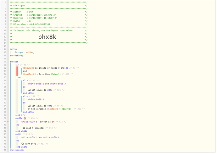

The piston is executing from the top line of code when it exits the While loop.
What I want this to do is:
When the TV is switched off, set the family room lights to 20% and turn on the master bedroom lights. [The TV switch was removed from this code for testing purposes]
Monitor the master bedroom lights, and when that switch is turn off, turn off the lights in the family room.
When the master bedroom lights are switched off, it executes the code from the top. What I want it to do is simply execute the code beneath the While Loop and complete the piston. How do I do this?

I have not looked at the piston in detail but the first thing I noticed is your WHILE only has the Wait 5 secs in it and nothign else. If you want White Bulb 2 and 3 to turn off, they need to be inside the WHILE, you can probably drag it in.

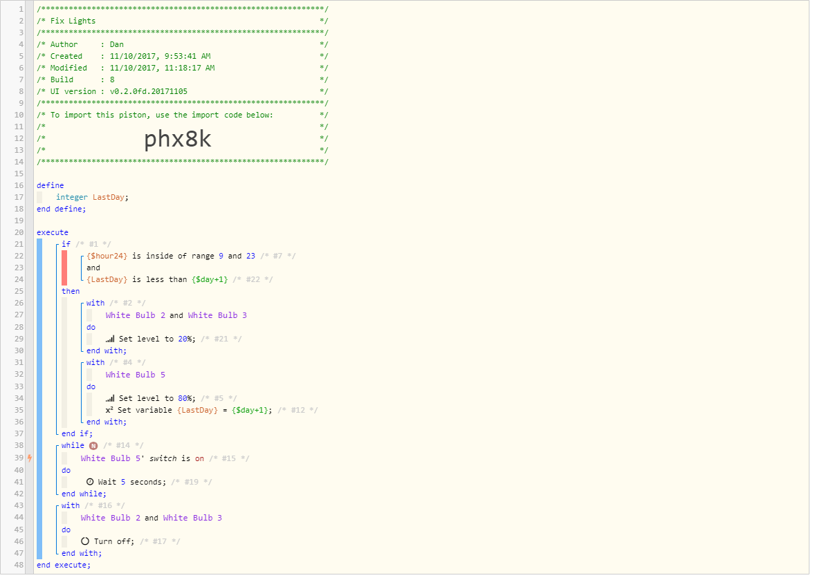

Thank you for the quick response! At the top of the while statement it checks to see if Bulb 5 has been turned off; I just put a wait statement in there so it didn’t run constantly - only checking the status of the bulb every 5 seconds.
Once that bulb is turned off, I want bulbs 2 and 3 to turn off. Those commands come immediately after the while loop, so I thought they’d be executed once the bulb 5 switch is determined to be off.
Based on the log details, my understanding of a while loop is incorrect. I’ve also tried other loops but end up with the same result.
Try it with something simple like this… the piston will subscribe to events from Bulb 5, so when it sees it turn off, it should turn off bulb 2 and 3 also without needing a loop. That is if I understood what you need correctly :smiley:

That makes sense - I didn’t think about it subscribing to events, so I thought I had to keep polling the switch until it changed.
The statement you wrote does what I want it to do, the only catch is I only want that executed if White Bulb 5 is on because the if statement above turned it on.
Is there a way to do that? Maybe I can create another variable like I did for “last day” so it only executes once per day…
Thanks so much for your help!
