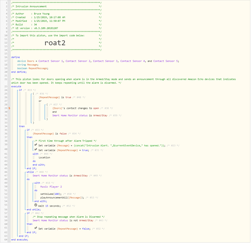

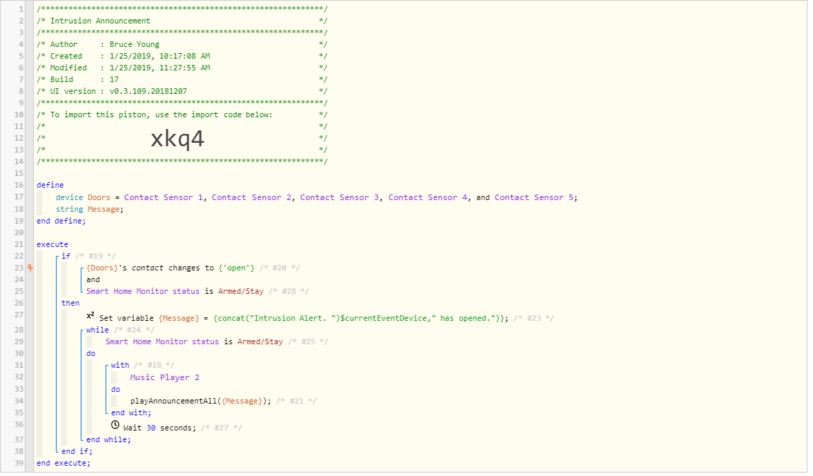

While loop not repeating when using Smart Home Monitor Status
While loop not working as expected when using Smart Home Monitor Status as the condition.
The While loop has an announcement that plays through Echo devices that I want to repeat every few seconds as long as the Smart Home Monitor status is still Armed/Stay.
In the current configuration snapshot shown. The announcement plays once but never repeats. But if I use a physical switch for the condition of the While statement, it works as expected. I can see that the $shmStatus variable is still Armed/Stay and the ST Classic app also shows that it is still in Armed/Stay mode. I have also tried using the state of $shmTripped for the While condition and it didn’t work either. I read in some other threads that the While statement might not be the best to use, but it works when a physical switch state is used for the condition, which I find confusing.

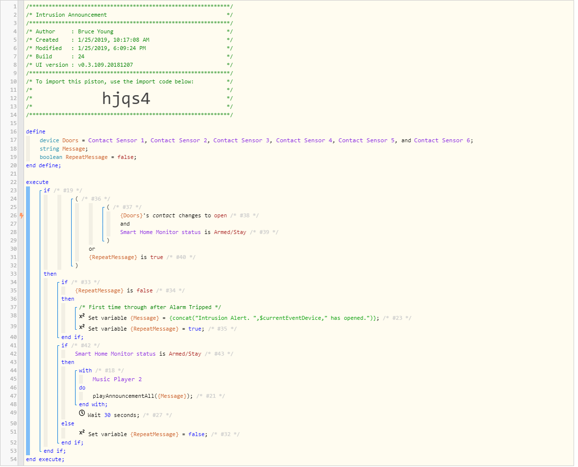

You need to group with your ‘changes to open’ an ‘or is open’. the second time through, this if will fail because the sensor will no longer be in the changed to open state. If you want it to keep going even if the door is closed, you will need to add a Boolean variable you set to true and then false as soon as shm is turned off.

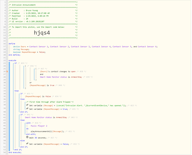

I modified the piston to include a Boolean as you suggested. But it only plays the message once. When the piston is triggered the second time after the 30s wait, nothing happens. The trace doesn’t show that anything was evaluated at all.

Just a few observations about piston HJQS4:
  • Line 19 will force the variable to be false each time the piston runs.
  • Also, line 42 is pointless because for the code to reach that line, SHM must be Armed/Stay.
  • This also means line 51 will never execute.
Thanks for your help (again) @WCmore
The piston seems to be doing what I want it to do now.
