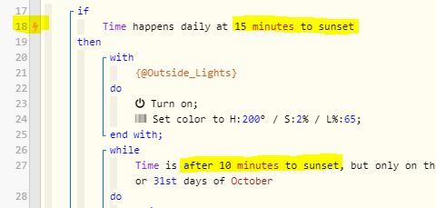

Sorry about that, I thought it was attached before, but I’ve uploaded a new screenshot of the code.
I really think my While Loops aren’t executing at all, but that could just be because of user error in interpreting the code.
They aren’t…here’s why…
A piston can start by a Trigger or in the absence of all Triggers it will use conditions. But when you have both Triggers and conditions, only the Triggers will start the piston.
So…you can see from the screen grab I took here that Line 18 is a Trigger. The lightning bolt signifies that it is a line which will cause this piston to run. So at 15 minutes to sunset, the piston will fire off. Then it will run through and when it does it gets to Line 27 and determines that the Time of day check is not satisfied, so it quits there.
The piston does not run both at 15 minutes to sunset and then again at “after 10 minutes to sunset”. You’d need more Triggers to get that to happen.
Seeing what you’re doing though, I still don’t think you need While statements for that. I think IF’s would probably work better… Or maybe even separate Time statements for the various holidays. Just a thought.

Thanks for the help everybody. I ended up using a combination of the BEFORE while loops and setting up individual IF statements for each loop. I ran a test last night and it seems like everything is working for me now.
