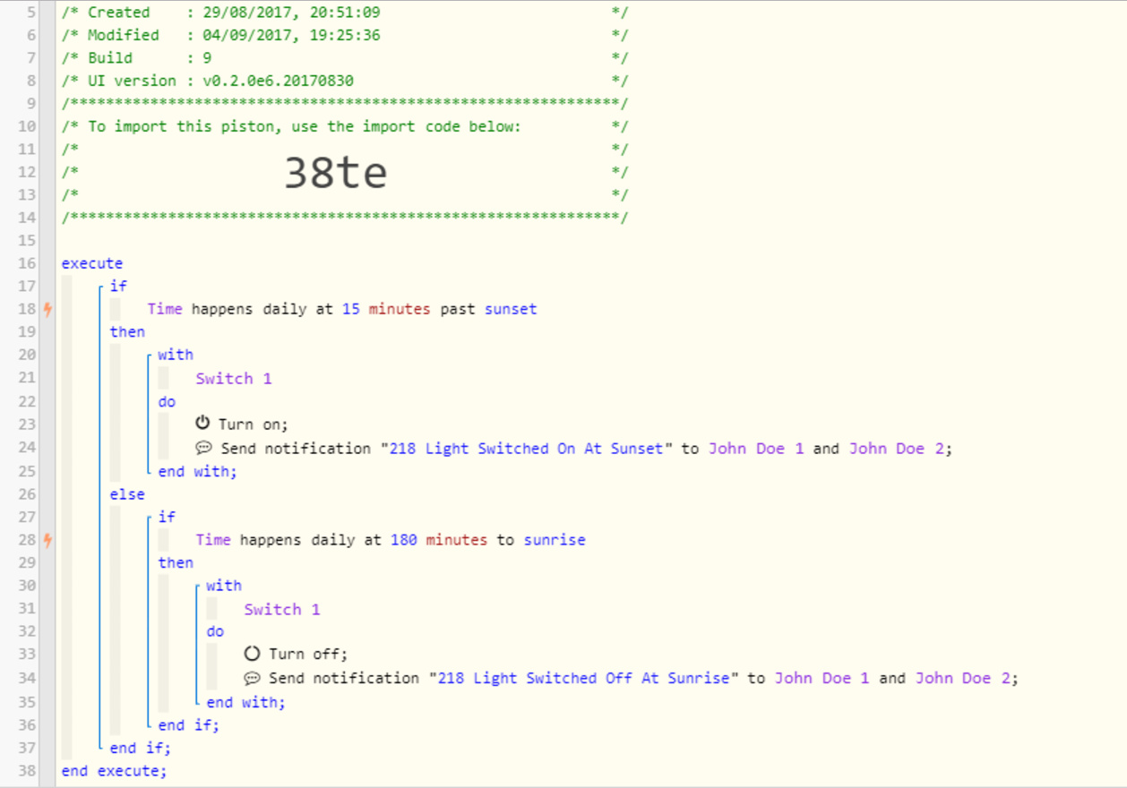

One of the pistons I’ve created is to control an outdoor light by turning it on 15 minutes after sunset and turning it off 3 hours before sunrise. I’ve included some logic to send the mrs and I a notification when the light is turned on and off but the issue I’m having is that for the switch off scenario, I’m getting two of the same notifications. Does anyone know why?

Any other ideas anyone? I’m still getting this issue and can’t for the life of me work out why it’s happening. I thought it might be the way my logic is structured but the time ‘180 minutes to sunrise’ only happens once so that shouldn’t be the cause either…

It may be because you have a trigger within a trigger.
I think I would make them 2 separate, IFS, within the same piston.
So instead of
IF .
ELSE
I would do
IF
Then a new if.
Still doesn’t answer your question though.

@freddyq are you still using your original piston or the one I suggested?. Because like @bobbles said. Your first one had a trigger within a trigger,

Oh good point. This is the piston I’m using…

Yes actually I’ve just realised I am using the updated version @Baz2473 suggested which has two IF statements…so actually the only other thing I can try is change the if to every…
