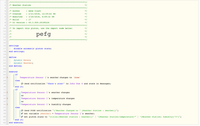

Why am I getting duplicate notifications?
Can anyone tell me why I’m getting duplicate push notifications for when the weather changes. It’s the notification that says “Weather changed to…”. I’m not very good at interpreting logs so maybe it’s in there.
Sorry if this is a stupid mistake.

+285ms ║║Calculating (string) Mostly Cloudy | 44 + (string) ° | >> (string) Mostly Cloudy | 44° |
+288ms ║║Calculating (string) Mostly Cloudy | 44° | + (string) 42 >> (string) Mostly Cloudy | 44° | 42
+290ms ║║Calculating (string) Mostly Cloudy | 44° | 42 + (string) % >> (string) Mostly Cloudy | 44° | 42%
+293ms ║║Executed virtual command setState (1ms)
+295ms ║╚Execution stage complete. (95ms)
+296ms ╚Event processed successfully (296ms)
3/23/2018, 3:10:45 PM +291ms
+1ms ╔Received event [Weather Station].humidity = 43 with a delay of 128ms
+223ms ║RunTime Analysis CS > 25ms > PS > 81ms > PE > 117ms > CE
+226ms ║Runtime (41759 bytes) successfully initialized in 81ms (v0.3.000.20180224) (224ms)
+227ms ║╔Execution stage started
+240ms ║║Condition #18 evaluated false (8ms)
+241ms ║║Condition group #5 evaluated false (state did not change) (9ms)
+249ms ║║Condition #22 evaluated false (5ms)
+255ms ║║Condition #25 evaluated false (5ms)
+258ms ║║Comparison (integer) 43 changes = true (1ms)
+259ms ║║Condition #26 evaluated true (3ms)
+260ms ║║Condition group #19 evaluated true (state did not change) (16ms)
+262ms ║║Cancelling statement #20’s schedules…
+270ms ║║Calculating (string) Weather Changed to + (string) Mostly Cloudy >> (string) Weather Changed to Mostly Cloudy
+282ms ║║Executed virtual command sendPushNotification (9ms)
+291ms ║║Executed virtual command setVariable (2ms)
+302ms ║║Calculating (string) Mostly Cloudy + (string) | >> (string) Mostly Cloudy |
+309ms ║║Calculating (string) Mostly Cloudy | + (string) 44 >> (string) Mostly Cloudy | 44
+312ms ║║Calculating (string) Mostly Cloudy | 44 + (string) ° | >> (string) Mostly Cloudy | 44° |
+315ms ║║Calculating (string) Mostly Cloudy | 44° | + (string) 43 >> (string) Mostly Cloudy | 44° | 43
+317ms ║║Calculating (string) Mostly Cloudy | 44° | 43 + (string) % >> (string) Mostly Cloudy | 44° | 43%
+320ms ║║Executed virtual command setState (0ms)
+322ms ║╚Execution stage complete. (95ms)
+323ms ╚Event processed successfully (323ms)
3/23/2018, 2:55:44 PM +607ms
+1ms ╔Received event [Weather Station].humidity = 42 with a delay of 117ms
+10449ms ║RunTime Analysis CS > 208ms > PS > 10095ms > PE > 146ms > CE
+10450ms ║Piston waited at a semaphore for 10034ms
+10452ms ║Runtime (41840 bytes) successfully initialized in 10095ms (v0.3.000.20180224) (10450ms)
+10453ms ║╔Execution stage started
+10466ms ║║Condition #18 evaluated false (7ms)
+10467ms ║║Condition group #5 evaluated false (state did not change) (8ms)
+10474ms ║║Condition #22 evaluated false (4ms)
+10479ms ║║Cancelling condition #25’s schedules…
+10480ms ║║Condition #25 evaluated false (5ms)
+10483ms ║║Comparison (integer) 42 changes = true (0ms)
+10485ms ║║Cancelling condition #26’s schedules…
+10485ms ║║Condition #26 evaluated true (4ms)
+10486ms ║║Condition group #19 evaluated true (state did not change) (17ms)
+10489ms ║║Cancelling statement #20’s schedules…
+10496ms ║║Calculating (string) Weather Changed to + (string) Overcast >> (string) Weather Changed to Overcast
+10508ms ║║Executed virtual command sendPushNotification (9ms)
+10517ms ║║Executed virtual command setVariable (3ms)
+10529ms ║║Calculating (string) Overcast + (string) | >> (string) Overcast |
+10535ms ║║Calculating (string) Overcast | + (string) 44 >> (string) Overcast | 44
+10538ms ║║Calculating (string) Overcast | 44 + (string) ° | >> (string) Overcast | 44° |
+10541ms ║║Calculating (string) Overcast | 44° | + (string) 42 >> (string) Overcast | 44° | 42
+10544ms ║║Calculating (string) Overcast | 44° | 42 + (string) % >> (string) Overcast | 44° | 42%
+10546ms ║║Executed virtual command setState (0ms)
+10549ms ║╚Execution stage complete. (96ms)
+10550ms ╚Event processed successfully (10551ms)
3/23/2018, 2:55:44 PM +575ms
+1ms ╔Received event [Weather Station].temperature = 44 with a delay of 109ms
+359ms ║RunTime Analysis CS > 23ms > PS > 226ms > PE > 111ms > CE
+362ms ║Runtime (41766 bytes) successfully initialized in 226ms (v0.3.000.20180224) (360ms)
+363ms ║╔Execution stage started
+376ms ║║Condition #18 evaluated false (7ms)
+377ms ║║Condition group #5 evaluated false (state did not change) (8ms)
+386ms ║║Condition #22 evaluated false (6ms)
+389ms ║║Comparison (decimal) 44.0 changes = true (1ms)
+390ms ║║Cancelling condition #25’s schedules…
+391ms ║║Condition #25 evaluated true (4ms)
+392ms ║║Cancelling condition #19’s schedules…
+393ms ║║Condition group #19 evaluated true (state changed) (13ms)
+395ms ║║Cancelling statement #20’s schedules…
+402ms ║║Calculating (string) Weather Changed to + (string) Overcast >> (string) Weather Changed to Overcast
+431ms ║║Executed virtual command sendPushNotification (26ms)
+441ms ║║Executed virtual command setVariable (4ms)
+454ms ║║Calculating (string) Overcast + (string) | >> (string) Overcast |
+458ms ║║Calculating (string) Overcast | + (string) 44 >> (string) Overcast | 44
+461ms ║║Calculating (string) Overcast | 44 + (string) ° | >> (string) Overcast | 44° |
+466ms ║║Calculating (string) Overcast | 44° | + (string) 42 >> (string) Overcast | 44° | 42
+468ms ║║Calculating (string) Overcast | 44° | 42 + (string) % >> (string) Overcast | 44° | 42%
+471ms ║║Executed virtual command setState (1ms)
+473ms ║╚Execution stage complete. (110ms)
+474ms ╚Event processed successfully (474ms)
3/23/2018, 2:40:44 PM +602ms
+1ms ╔Received event [Weather Station].humidity = 43 with a delay of 133ms
+242ms ║RunTime Analysis CS > 31ms > PS > 94ms > PE > 117ms > CE
+245ms ║Runtime (41757 bytes) successfully initialized in 94ms (v0.3.000.20180224) (243ms)
+246ms ║╔Execution stage started
+261ms ║║Condition #18 evaluated false (9ms)
+262ms ║║Condition group #5 evaluated false (state did not change) (10ms)
+270ms ║║Cancelling condition #22’s schedules…
+271ms ║║Condition #22 evaluated false (6ms)
+276ms ║║Cancelling condition #25’s schedules…
+277ms ║║Condition #25 evaluated false (5ms)
+280ms ║║Comparison (integer) 43 changes = false (0ms)
+282ms ║║Cancelling condition #26’s schedules…
+282ms ║║Condition #26 evaluated false (4ms)
+283ms ║║Cancelling condition #19’s schedules…
+284ms ║║Condition group #19 evaluated false (state changed) (19ms)
+287ms ║╚Execution stage complete. (40ms)
+288ms ╚Event processed successfully (288ms)
3/23/2018, 2:10:45 PM +152ms
+2ms ╔Received event [Weather Station].weather = Overcast with a delay of 248ms
+294ms ║RunTime Analysis CS > 29ms > PS > 93ms > PE > 171ms > CE
+298ms ║Runtime (41783 bytes) successfully initialized in 93ms (v0.3.000.20180224) (294ms)
+299ms ║╔Execution stage started
+311ms ║║Comparison (string) Overcast changes_to (string) Snow = false (1ms)
+312ms ║║Condition #18 evaluated false (6ms)
+313ms ║║Condition group #5 evaluated false (state did not change) (8ms)
+318ms ║║Comparison (string) Overcast changes = true (0ms)
+320ms ║║Cancelling condition #22’s schedules…
+320ms ║║Condition #22 evaluated true (4ms)
+321ms ║║Condition group #19 evaluated true (state did not change) (5ms)
+324ms ║║Cancelling statement #20’s schedules…
+328ms ║║Calculating (string) Weather Changed to + (string) Overcast >> (string) Weather Changed to Overcast
+341ms ║║Executed virtual command sendPushNotification (8ms)
+347ms ║║Executed virtual command setVariable (4ms)
+356ms ║║Calculating (string) Overcast + (string) | >> (string) Overcast |
+364ms ║║Calculating (string) Overcast | + (string) 43 >> (string) Overcast | 43
+367ms ║║Calculating (string) Overcast | 43 + (string) ° | >> (string) Overcast | 43° |
+373ms ║║Calculating (string) Overcast | 43° | + (string) 44 >> (string) Overcast | 43° | 44
+375ms ║║Calculating (string) Overcast | 43° | 44 + (string) % >> (string) Overcast | 43° | 44%
+377ms ║║Executed virtual command setState (0ms)
+380ms ║╚Execution stage complete. (82ms)
+381ms ╚Event processed successfully (381ms)
3/23/2018, 1:55:44 PM +434ms
+2ms ╔Received event [Weather Station].temperature = 43 with a delay of 139ms
+250ms ║RunTime Analysis CS > 30ms > PS > 95ms > PE > 124ms > CE
+254ms ║Runtime (41782 bytes) successfully initialized in 95ms (v0.3.000.20180224) (250ms)
+255ms ║╔Execution stage started
+270ms ║║Condition #18 evaluated false (9ms)
+271ms ║║Condition group #5 evaluated false (state did not change) (10ms)
+279ms ║║Condition #22 evaluated false (5ms)
+283ms ║║Comparison (decimal) 43.0 changes = true (1ms)
+284ms ║║Cancelling condition #25’s schedules…
+285ms ║║Condition #25 evaluated true (5ms)
+286ms ║║Condition group #19 evaluated true (state did not change) (12ms)
+288ms ║║Cancelling statement #20’s schedules…
+297ms ║║Calculating (string) Weather Changed to + (string) Mostly Cloudy >> (string) Weather Changed to Mostly Cloudy
+312ms ║║Executed virtual command sendPushNotification (12ms)
+502ms ║║Executed virtual command setVariable (4ms)
+517ms ║║Calculating (string) Mostly Cloudy + (string) | >> (string) Mostly Cloudy |
+523ms ║║Calculating (string) Mostly Cloudy | + (string) 43 >> (string) Mostly Cloudy | 43
+528ms ║║Calculating (string) Mostly Cloudy | 43 + (string) ° | >> (string) Mostly Cloudy | 43° |
+536ms ║║Calculating (string) Mostly Cloudy | 43° | + (string) 44 >> (string) Mostly Cloudy | 43° | 44
+539ms ║║Calculating (string) Mostly Cloudy | 43° | 44 + (string) % >> (string) Mostly Cloudy | 43° | 44%
+543ms ║║Executed virtual command setState (0ms)
+546ms ║╚Execution stage complete. (291ms)
+547ms ╚Event processed successfully (547ms)
3/23/2018, 1:55:44 PM +445ms
+1ms ╔Received event [Weather Station].humidity = 44 with a delay of 114ms
+193ms ║RunTime Analysis CS > 22ms > PS > 65ms > PE > 106ms > CE
+196ms ║Runtime (41779 bytes) successfully initialized in 65ms (v0.3.000.20180224) (193ms)
+197ms ║╔Execution stage started
+210ms ║║Condition #18 evaluated false (8ms)
+211ms ║║Condition group #5 evaluated false (state did not change) (9ms)
+219ms ║║Condition #22 evaluated false (5ms)
+225ms ║║Condition #25 evaluated false (5ms)
+228ms ║║Comparison (integer) 44 changes = true (1ms)
+229ms ║║Condition #26 evaluated true (3ms)
+230ms ║║Condition group #19 evaluated true (state did not change) (16ms)
+233ms ║║Cancelling statement #20’s schedules…
+241ms ║║Calculating (string) Weather Changed to + (string) Mostly Cloudy >> (string) Weather Changed to Mostly Cloudy
+252ms ║║Executed virtual command sendPushNotification (8ms)
+261ms ║║Executed virtual command setVariable (4ms)
+273ms ║║Calculating (string) Mostly Cloudy + (string) | >> (string) Mostly Cloudy |
+280ms ║║Calculating (string) Mostly Cloudy | + (string) 43 >> (string) Mostly Cloudy | 43
+283ms ║║Calculating (string) Mostly Cloudy | 43 + (string) ° | >> (string) Mostly Cloudy | 43° |
+287ms ║║Calculating (string) Mostly Cloudy | 43° | + (string) 44 >> (string) Mostly Cloudy | 43° | 44
+289ms ║║Calculating (string) Mostly Cloudy | 43° | 44 + (string) % >> (string) Mostly Cloudy | 43° | 44%
+292ms ║║Executed virtual command setState (0ms)
+294ms ║╚Execution stage complete. (98ms)
+295ms ╚Event processed successfully (295ms)
3/23/2018, 1:40:45 PM +174ms
+1ms ╔Received event [Weather Station].humidity = 43 with a delay of 116ms
+212ms ║RunTime Analysis CS > 22ms > PS > 74ms > PE > 116ms > CE
+215ms ║Runtime (41778 bytes) successfully initialized in 74ms (v0.3.000.20180224) (213ms)
+216ms ║╔Execution stage started
+229ms ║║Condition #18 evaluated false (7ms)
+230ms ║║Condition group #5 evaluated false (state did not change) (8ms)
+237ms ║║Cancelling condition #22’s schedules…
+238ms ║║Condition #22 evaluated false (5ms)
+243ms ║║Condition #25 evaluated false (5ms)
+246ms ║║Comparison (integer) 43 changes = true (1ms)
+247ms ║║Condition #26 evaluated true (4ms)
+248ms ║║Condition group #19 evaluated true (state did not change) (16ms)
+250ms ║║Cancelling statement #20’s schedules…
+257ms ║║Calculating (string) Weather Changed to + (string) Mostly Cloudy >> (string) Weather Changed to Mostly Cloudy
+268ms ║║Executed virtual command sendPushNotification (7ms)
+276ms ║║Executed virtual command setVariable (3ms)
+287ms ║║Calculating (string) Mostly Cloudy + (string) | >> (string) Mostly Cloudy |
+293ms ║║Calculating (string) Mostly Cloudy | + (string) 44 >> (string) Mostly Cloudy | 44
+296ms ║║Calculating (string) Mostly Cloudy | 44 + (string) ° | >> (string) Mostly Cloudy | 44° |
+300ms ║║Calculating (string) Mostly Cloudy | 44° | + (string) 43 >> (string) Mostly Cloudy | 44° | 43
+302ms ║║Calculating (string) Mostly Cloudy | 44° | 43 + (string) % >> (string) Mostly Cloudy | 44° | 43%
+304ms ║║Executed virtual command setState (0ms)
+307ms ║╚Execution stage complete. (91ms)
+308ms ╚Event processed successfully (308ms)
3/23/2018, 1:14:08 PM +598ms
+1ms ╔Received event [Weather Station].weather = Mostly Cloudy with a delay of 106ms
+203ms ║RunTime Analysis CS > 23ms > PS > 67ms > PE > 113ms > CE
+207ms ║Runtime (41769 bytes) successfully initialized in 67ms (v0.3.000.20180224) (204ms)
+208ms ║╔Execution stage started
+217ms ║║Comparison (string) Mostly Cloudy changes_to (string) Snow = false (1ms)
+218ms ║║Condition #18 evaluated false (5ms)
+219ms ║║Condition group #5 evaluated false (state did not change) (6ms)
+225ms ║║Comparison (string) Mostly Cloudy changes = true (1ms)
+226ms ║║Cancelling condition #22’s schedules…
+227ms ║║Condition #22 evaluated true (5ms)
+228ms ║║Condition group #19 evaluated true (state did not change) (6ms)
+230ms ║║Cancelling statement #20’s schedules…
+235ms ║║Calculating (string) Weather Changed to + (string) Mostly Cloudy >> (string) Weather Changed to Mostly Cloudy
+246ms ║║Executed virtual command sendPushNotification (6ms)
+252ms ║║Executed virtual command setVariable (3ms)

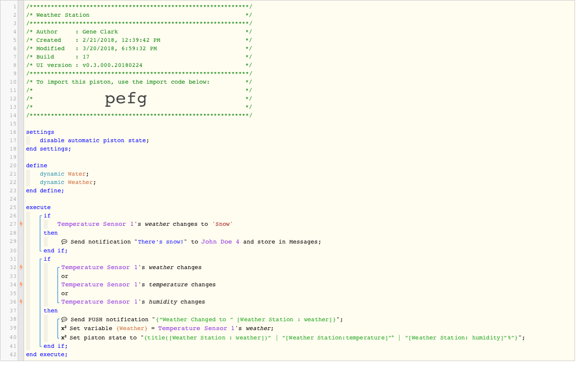

Line 27 and 32 are both sending you the notifications.
Shouldn’t line 27 only send notifications? That’s the way I thought I’d set it up. I was wondering if Ted because I’ve got three different triggers on lines 32, 34 and 36 if it might be an issue. This is using the smart weather tile device as a source of weather information.
Example:
At 06:10:44PM both temperature and humidity changed… what you can’t see are the milliseconds. Nothing in ST happens at the exact same moment, everything is synchronous, so they are seen as two seperate events causing two seperate notifications.
My reccomendation would be to use a variable to store the time the last notification was sent, and restrict the notifications to only send when the last notification was more than x minutes ago.
You also have 2 IFs being evaluated right after the other, it won’t stop when the first one becomes true.
