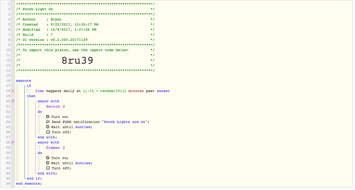

I have a piston that turns on my outside lights at a random time within 15 minutes of sunset. Sometimes, when it runs, I get multiple push notifications for the event. I have it set to send them just once. Any ideas why I’m getting multiple?

@c1arkbar adding the switch off condition unfortunately made it so that my lights did not turn off at sunrise. It seems to have cancelled the whole event, after the first fire. I added the condition to the if statement.
Is there no way to make it so that the piston only runs once, but runs the whole thing? My logic would say that a variable would have the same result as the switch off condition.
Can you share your updated version and if you have logs from it not working?
I have a few pistons like this that I only want to run one time.

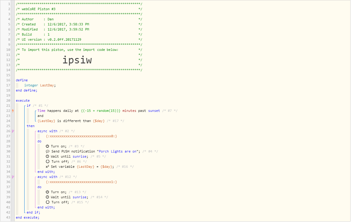

Create variable LastDay (integer) and use that as part of your IF statement:
#15
Thanks! I’m gonna give that a try.
