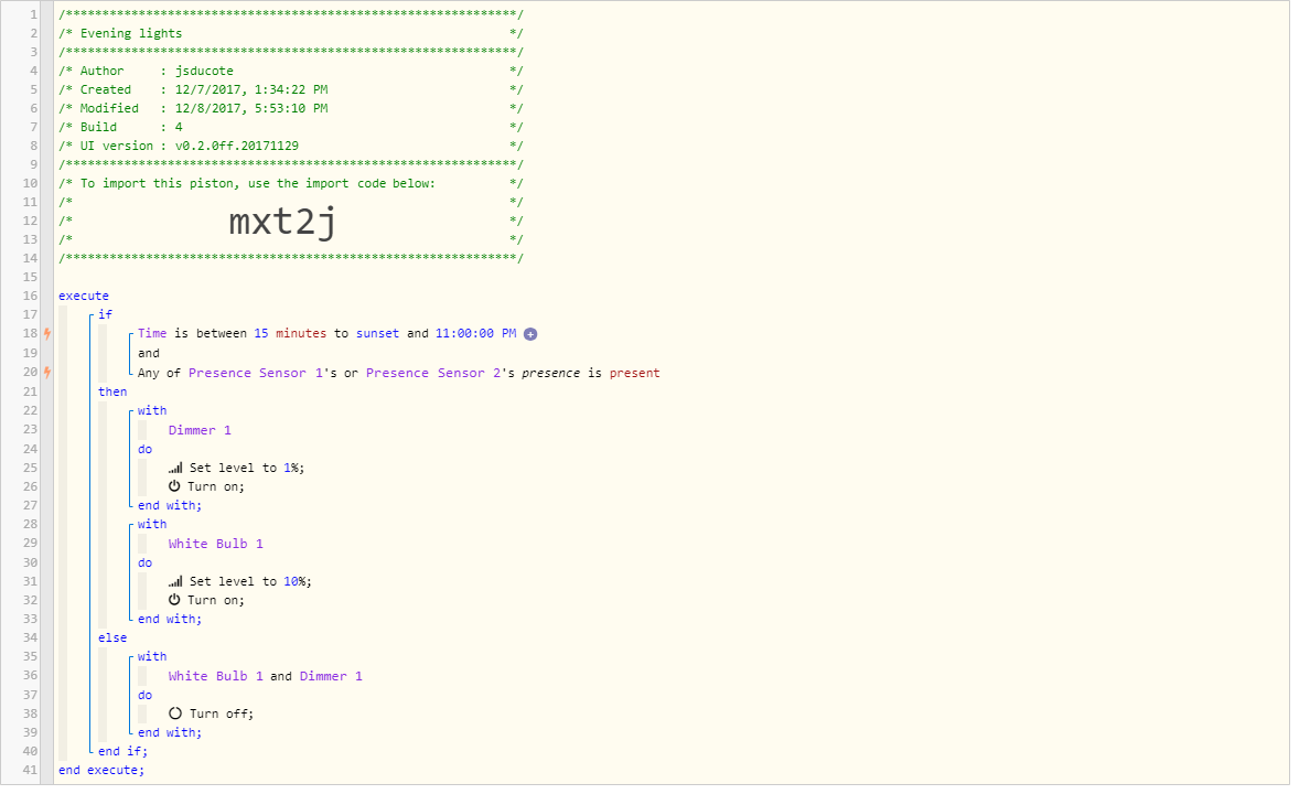

The real problem is that even after reading the ‘Conditions & Triggers’ thread, I still don’t understand how they work. Why don’t pistons continuously look at conditions and act upon them once they become true?
The lights should have come on once I was home, even if I came home after the beginning of the condition range.

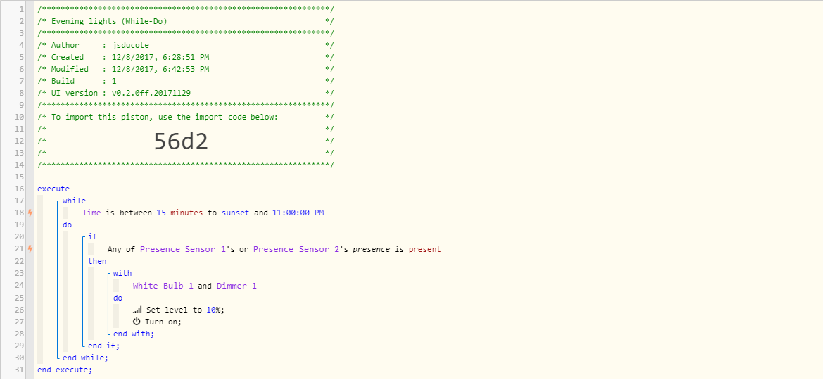

According to the log, it executed at sunset-15, saw that no one was home so it did nothing. The problem is that it scheduled the next execution for 11PM, so while I came home shortly after this executed, the lights did not come on. Why doesn’t the condition still apply? Do I have to use the condition in a While-Do loop with the presence condition nested inside? I don’t want to change the presence condition to a trigger (presence change) because if I get home just before the time range I still want them to come on.
12/8/2017, 5:07:59 PM +73ms
+2ms
╔Received event [Home].time = 1512774480000 with a delay of -928ms
+95ms
║RunTime Analysis CS > 29ms > PS > 46ms > PE > 21ms > CE
+109ms
║Runtime (37797 bytes) successfully initialized in 46ms (v0.2.0ff.20171129) (106ms)
+110ms
║╔Execution stage started
+165ms
║║Comparison (time) 61679191 is_between (time) 1512775380000 … (time) 82800000 = true (23ms)
+166ms
║║Time restriction check passed
+168ms
║║Cancelling condition #10’s schedules…
+169ms
║║Condition #10 evaluated true (51ms)
+186ms
║║Cancelling statement #10’s schedules…
+199ms
║║Requesting time schedule wake up at Fri, Dec 8 2017 @ 11:00:00 PM CST
+215ms
║║Comparison (enum) not present is (string) present = false (3ms)
+217ms
║║Comparison (enum) not present is (string) present = false (1ms)
+219ms
║║Cancelling condition #11’s schedules…
+220ms
║║Condition #11 evaluated false (18ms)
+221ms
║║Condition group #1 evaluated false (state did not change) (104ms)
+223ms
║║Cancelling statement #2’s schedules…
+231ms
║║Skipped execution of physical command [Kitchen].off([]) because it would make no change to the device. (4ms)
+232ms
║║Executed [Kitchen].off (4ms)
+237ms
║║Skipped execution of physical command [Upstairs].off([]) because it would make no change to the device. (2ms)
+238ms
║║Executed [Upstairs].off (4ms)
+241ms
║╚Execution stage complete. (132ms)
+243ms
║Setting up scheduled job for Fri, Dec 8 2017 @ 11:00:00 PM CST (in 21120.685s)
+260ms
╚Event processed successfully (261ms)`
