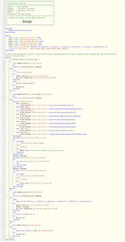

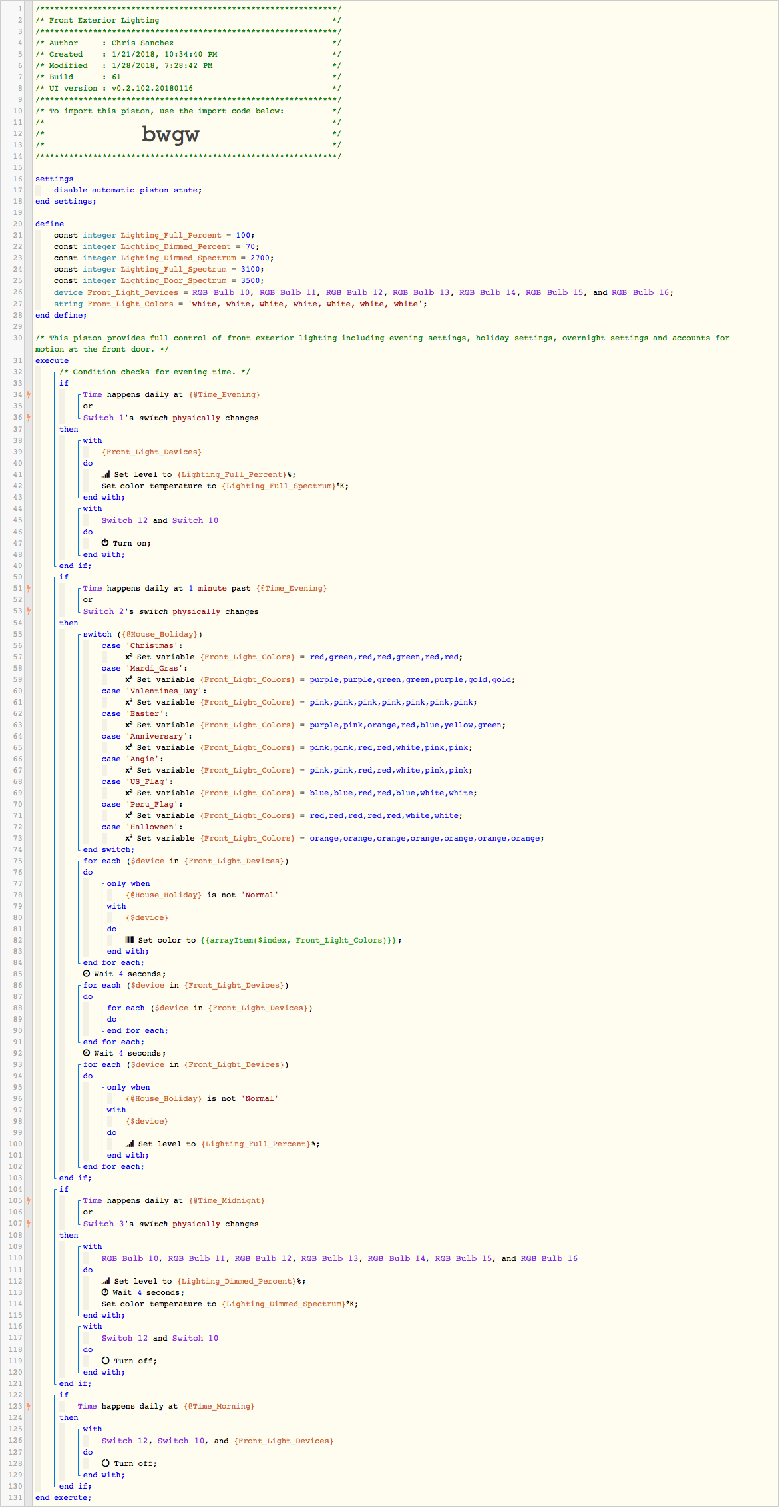

But here is one I set up for my exterior lighting. Its a bit long, but the first half of this is checking for the current holiday and assigning light colors. What you are looking for is the “for each device…” following by “…Set color to {{Array($index, )}}…”
I have found this statement to be solid and I do not get mis-fires or bounces with this one. When I set the devices to any command, I’m more like 90% on target.
