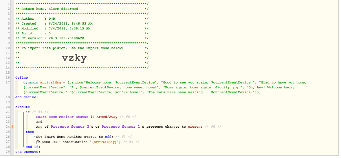

Why don't my variables variate?
Everything works well except I cannot get the $currentEventDevice command to populate the actual device name in the arrival message.
Return [Presence Sensor 1] in lieu of $currentEventDevice in arrival message.
THe command executes and I get the push notification, but I get the $currentEventDevice variable, not my expected [Presense Sensor 1].
Any help is appreciated!
You need to concatenate the variable to the text, at the moment you are telling it to literally print the text “$currentEventDevice” which it is doing.
Try: concat("Welcome home, ", $currentEventDevice)
Or: "Welcome home, " + $currentEventDevice
If you want an example I modified your piston the backup code is: 36x4
I think there was an issue with variables inside a random() function… @bangali had a work around for it, somewhere in here.
Ha! Solved. Thank you my good man (or woman, I won’t judge).
