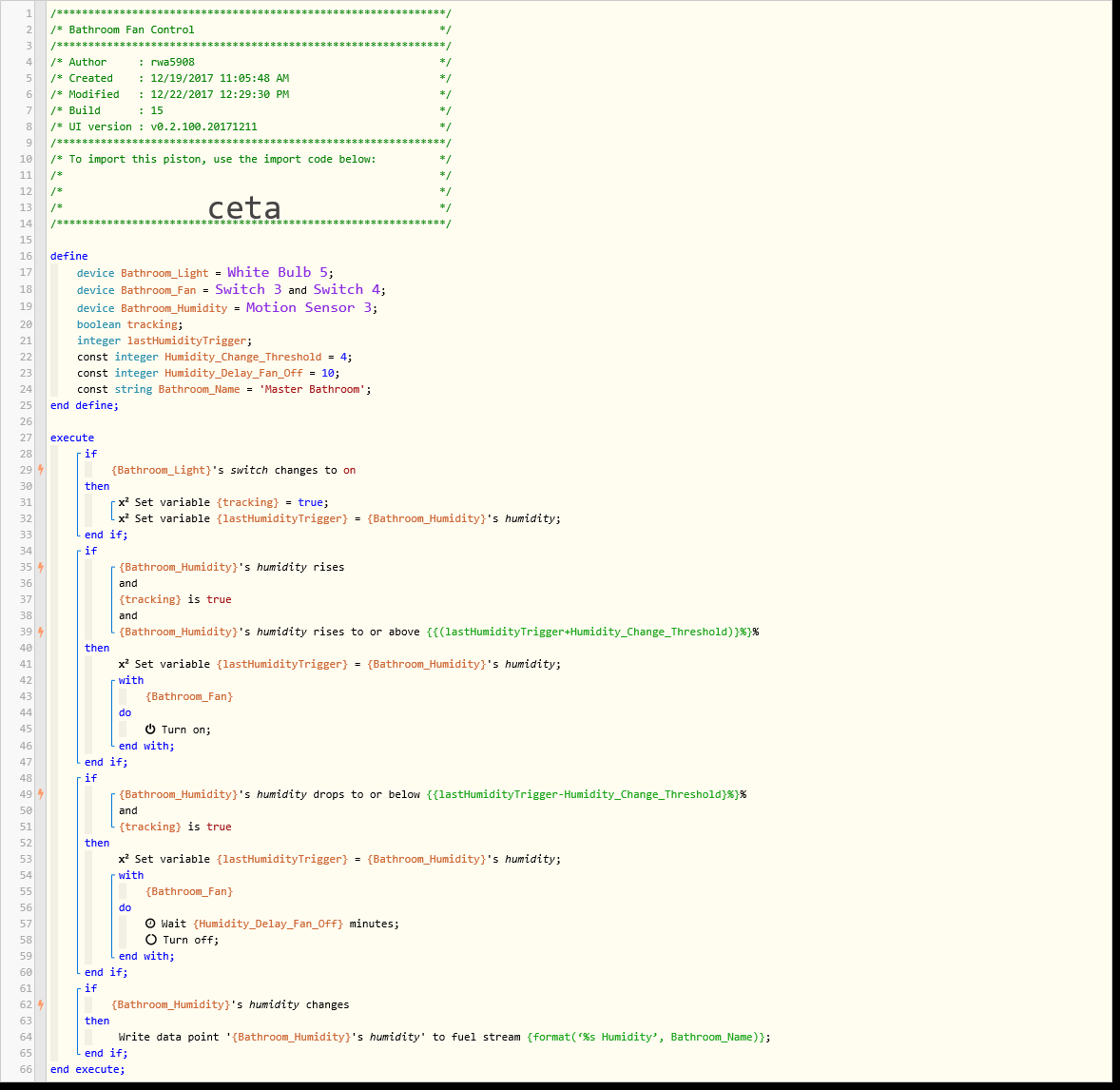

Why is fan not shutting off?
I’m using a Monoprice multi-sensor for the humidity sensor in this piston. I have it configured to report humidity changes of 1% or greater. It seems to report changes no more than once every 3 minutes. Sometimes the fan is not turned off.
Fan should turn off when humidity does not drop by at least Humidity_Change_Threshold within Humidity_Delay_Fan_Off minutes. When this happens it appears to be cancelling the scheduled timer but the timer event still occurs but nothing happens.
If the last humidity change is less than the threshold so it doesn’t trigger the “drops to or below” condition then when the wait timer expires the fan is not turned off.
ST IDE logs aren’t really relevant here. Webcore logs show the issue.

Try changing the Task Cancellation Policy (TCP) to Never in line 54 so that succeeding humidity events do not cancel the Wait timer. Click the With and then the cog icon.
Will that keep the timer from being reset when the humidity does drop below the threshold?
It should let the timer go on the full 10 minutes even if the humidity continues to drop.
The intent is for the 10 minute timer to be reset if the humidity drops below the threshold.
