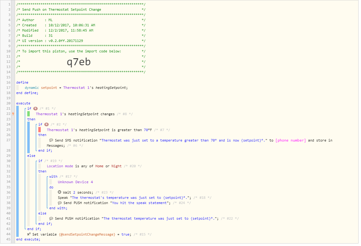

In the attached piston, LANnoucer should speak if someone adjusts the thermostat and the location mode is home or night. For some reason, that statement is either being ignored or is evaluating to false even when the location mode is home. When I look at the log, I can’t correlate the log info to the numbered statements in the piston.
The piston should announce the thermostat change if the location mode is home or night and send a push notification if the location mode is away.
The speak statement is never being executed, nor is the push notification being sent if the location is away.

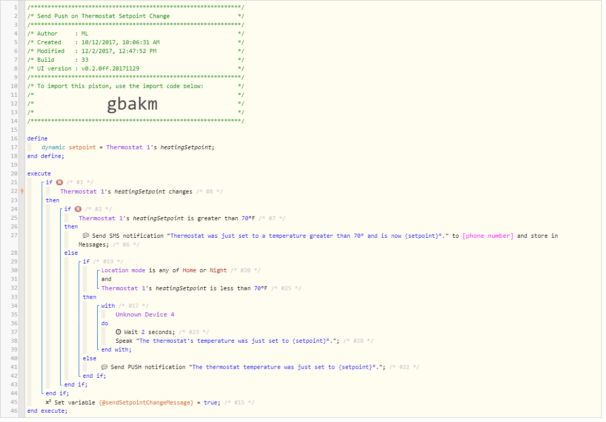

Place the 3rd IF within the first THEN, not within an ELSE.
An ELSE after a trigger won’t ever fire, when the piston fires (through a temp change), it will only fire the THEN.
Thank you, that was it. Here’s the working version:
