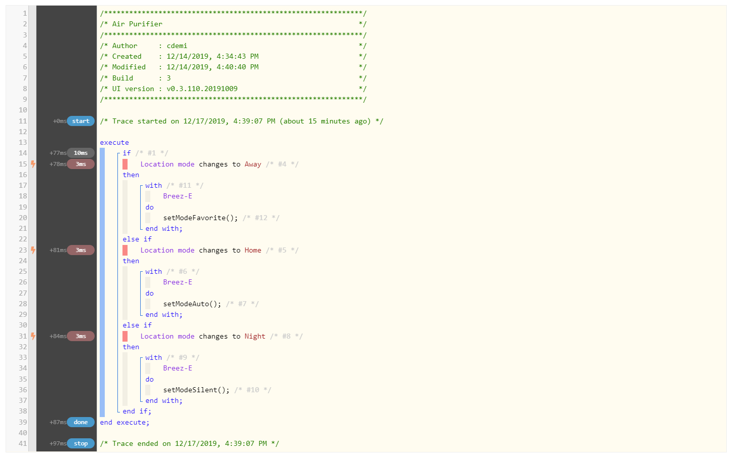

I have a piston that is running correctly. However, in the logs I am receiving events from devices that are not being used in that piston
I should receive only events that trigger the piston
I am posting a red screenshot to keep the device names

The device Dust-E is another device that I own but I am not using in the current piston.
FYI: Dust-E = Roborock S50 and Breez-E is Xiaomi Air Purifier Pro
