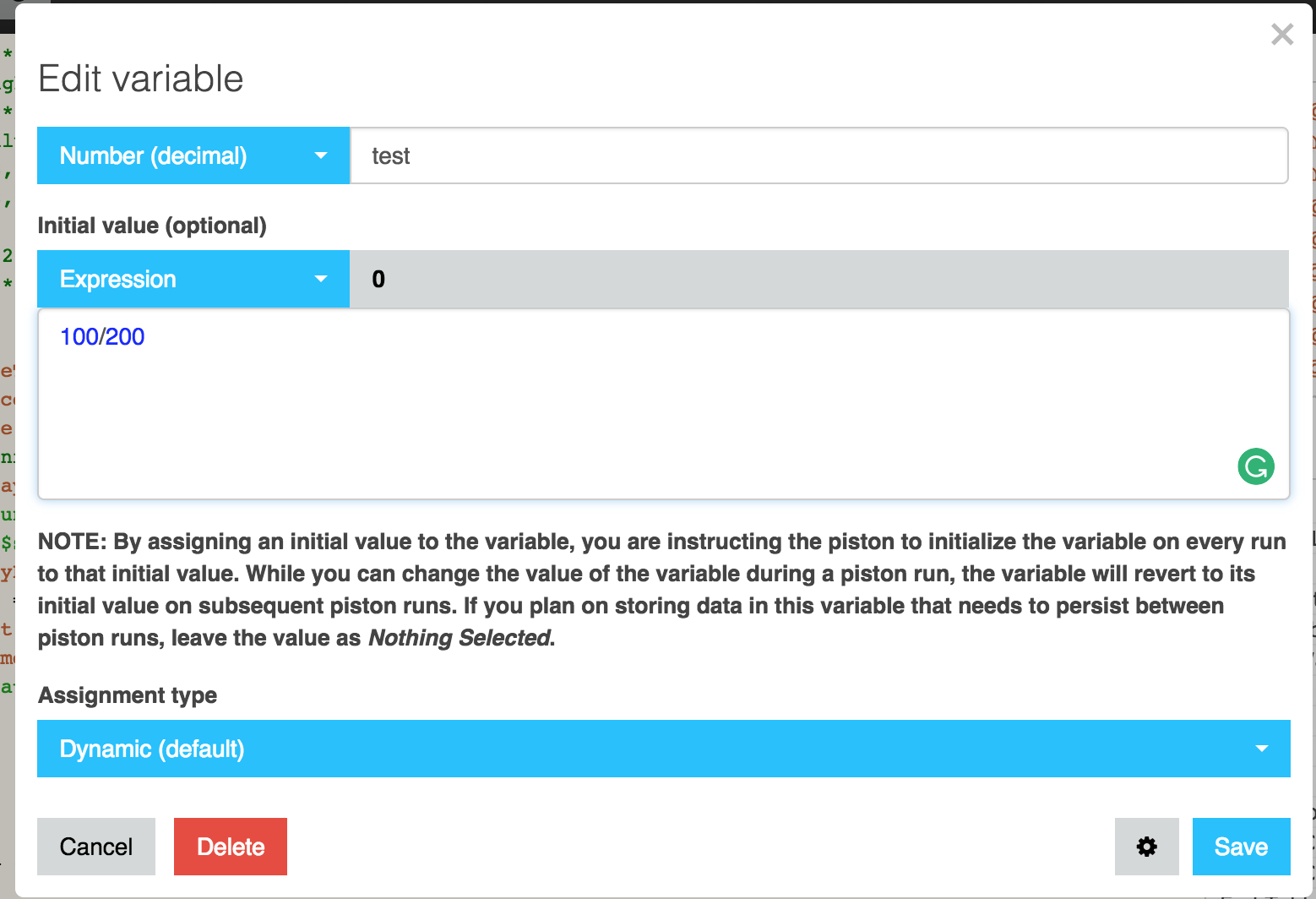

I’m trying to use an Expression to return a decimal value (which I’ve done dozens of times in other much more complicated examples) but for some reason webCoRE won’t return anything other than a whole number. Even something so simple as 100/200 returns a value of 0. Any idea what’s going on? Pic attached.

Now that seems silly, doesn’t it? Surely the result of 100/200 isn’t zero. The trouble is that I’m referencing 2 variables that have been assigned elsewhere, so it’s actually A/B. I’ve tried setting A and B as both integer variables and decimal variables, but it doesn’t make a difference. Even if I have the A and B variables set for “decimal” type, when I enter “100.0” as their value they default back to “100”.

That seems like such a mickey mouse way to hack it together though! My pistons are messy enough as it is…

Dealing with types in groovy is a pain. If you encounter cases like this where integer math is giving unexpected results you can coerce one or both of your variables to decimals in order to fix it, decimal(varA) / varB
