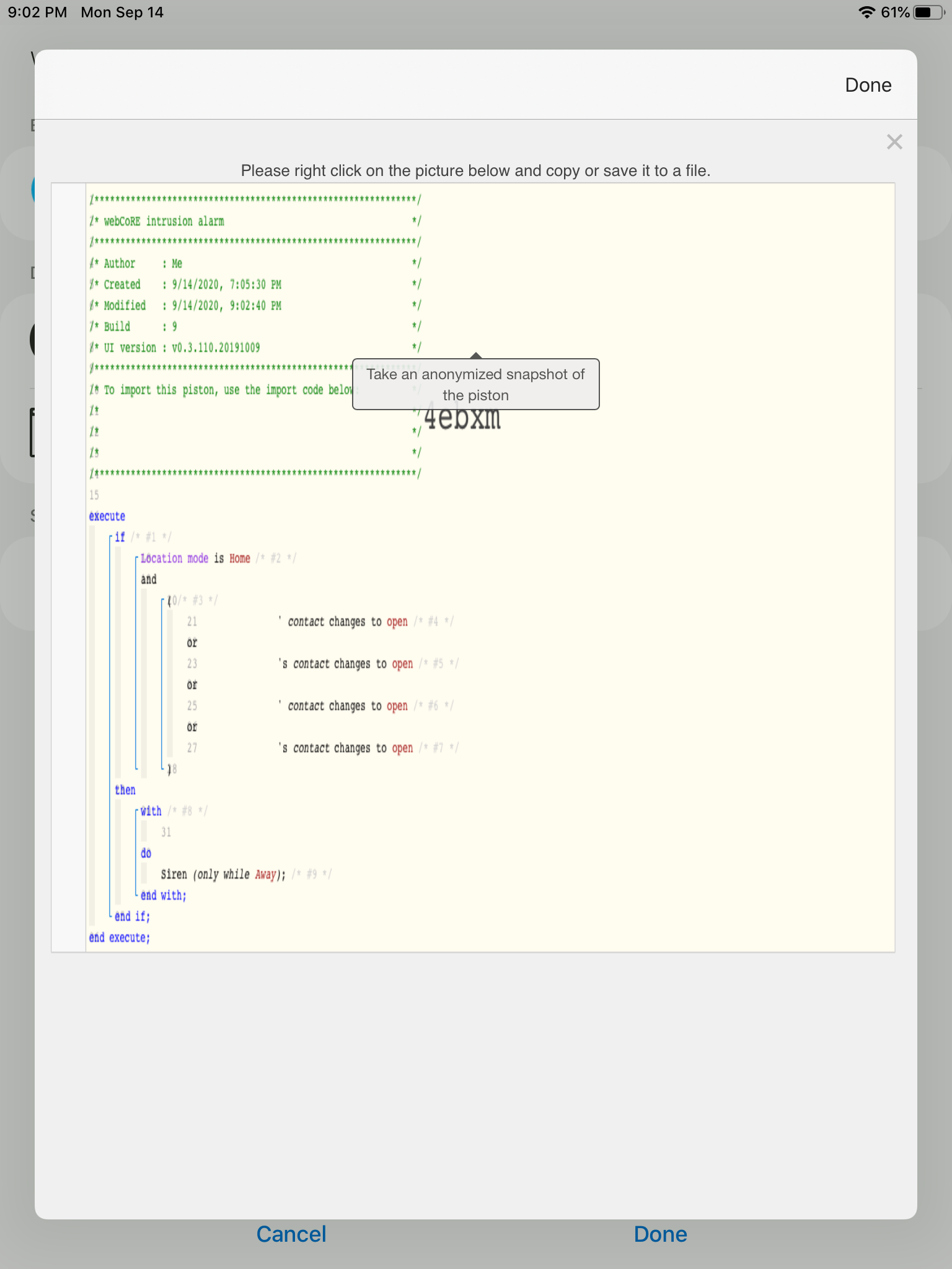

I did try location mode as an alternative but still got “false.” Which could mean that that doesn’t work either, that I did it wrong, or that there is possibly another issue which is leading to “false.”
can you post the screenshot of that piston. You can click on the green camera above the piston to create a safe image to share.

Not all that familiar with webcore, but on the dashboard, where it lists pistons, this was listed briefly as true, then changed to false. That’s all the info i have, unfortunately.
This is normal.

Good to hear it is normal, but the bottom line is, it doesn’t work. To recap, what I am trying to do is create an alarm (on my Sonos speaker, my Amazon Fire tablet, and-or email) if any sensors are opened. Would be very grateful if someone could point me at an existing example of how to do that (I imagine I am hardly the first with this objective). Thank you.
I would create a piston with that as the top level trigger. Something like:
IF any of DeviceA or DeviceB's contact changes to open <-- Trigger
Send PUSH Notification (or whatever)
END IF
If you want location in that logic, I would use an indented condition inside, like:
IF Location is Away (or whatever) <-- Condition
END IF
END IF
