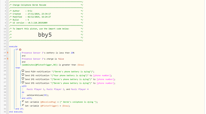

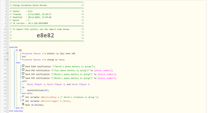

Why won't my piston wait for 30 minutes?
This is a notification piston if my son’s phone battery is dying. I want the warning every 30 minutes until he’s charging it and the charge is over 20%, but many times it’ll warn me every 10-15 minutes, even though the time is still counting down.
Warn me every 30 minutes
Warns me in less than 30 minutes. It could be how Life360 monitors his phone, but I just wanted to be sure. Thanks in advance for taking a look.

TCP set to NEVER but try doing that at line 26 instead of line 17.
The way I am reading this is, it triggers at each percent below 20%. (19, 18, 17, 16 etc)
This means you will get 19 messages before his phone dies.
In this case, I believe the 30 min wait serves no purpose, because there are no commands after the WAIT… (IE: you are waiting to do “nothing”)
Another way to say this: If you are subscribed to a device, you can not prevent a trigger from firing that piston. The way it is currently worded, it will execute when any of the “lightning bolt” lines changes.
I missed that WAIT doing nothing… thanks man… it’s very true… Damn Vodka:))))

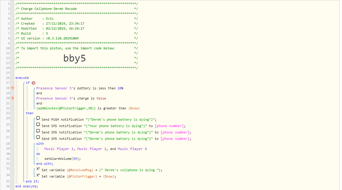

Since you set the variable @Pistontrigger to $now, you could add another statement to your initial IF.
if addminutes(@PistonTrigger,30) > $now. It would then only activate the piston if it’s been more than 30 minutes since the last message. I am going from memory on the function but it’s something like that.
Something like this? I’ll give it a shot and let you know.
Looks right , you may need to initialize the variable the first time not sure what it comes up with if it’s null. You can just edit the variable and manually set it to $now and then you should be good to go from that point on.
The @ suggest PistonTrigger is a global variable so if another Piston is filling that variable that may be an issue as well.
Wouldn’t you know it…THIS time my son actually plugged in his phone after the first warning…figures, lol
Something you might want to consider, since since the new part is a time based statement. It might be better with something like this
if
$now is after addminutes(@PistonTrigger,30)
