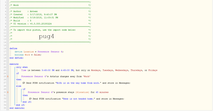

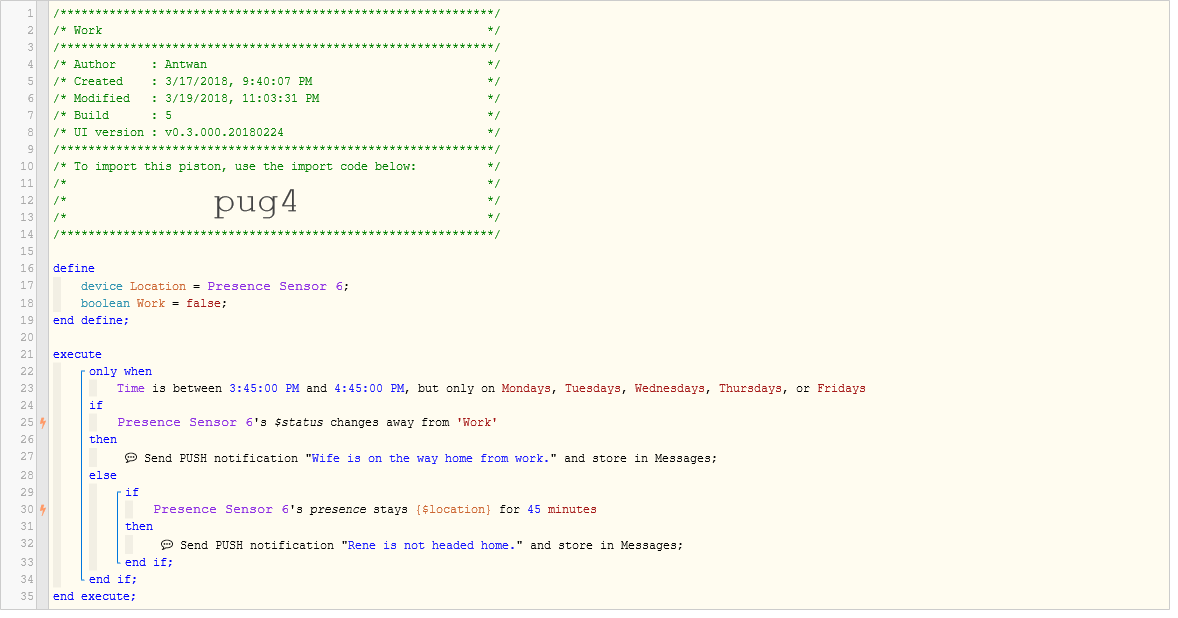

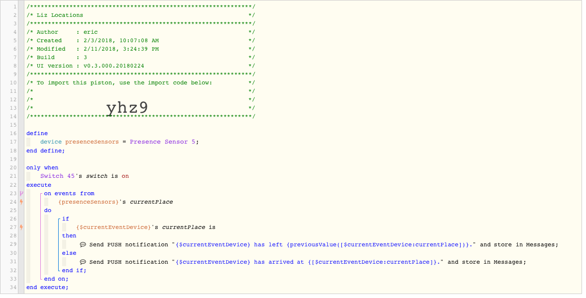

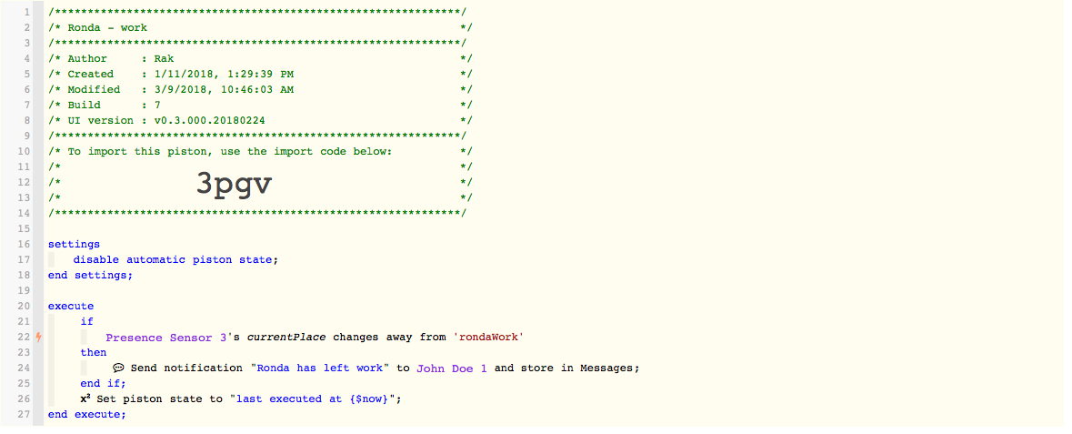

Trying to get a notification when my wife leaves work but it is a no go.
Get notification she left work.
Nothing.
3/19/2018, 11:03:31 PM +643ms
+1ms ╔Starting piston… (v0.3.000.20180224)
+683ms ║╔Subscribing to devices…
+978ms ║║Subscribing to Rene’s IPhone.$status…
+990ms ║║Subscribing to Rene’s IPhone.presence…
+1069ms ║╚Finished subscribing (396ms)
+1109ms ║Comparison (time) 83012733 is_between (time) 56700000 … (time) 60300000 = false (16ms)
+1148ms ║Comparison (enum) present stays (dynamic) Empty device list = false (5ms)
+1162ms ╚Piston successfully started (1162ms)
3/19/2018, 7:35:10 PM +145ms
+345ms ║╔Subscribing to devices…
+601ms ║║Subscribing to Rene’s IPhone.$status…
+671ms ║╚Finished subscribing (339ms)
+698ms ║Comparison (time) 70510835 is_between (time) 56700000 … (time) 60300000 = false (6ms)
+713ms ╚Piston successfully started (713ms)
3/17/2018, 9:52:30 PM +72ms
+208ms ║╔Subscribing to devices…
+218ms ║║Subscribing to Rene’s Iphone.$status…
+270ms ║╚Finished subscribing (74ms)
+301ms ║Comparison (time) 78750363 is_between (time) 56700000 … (time) 60300000 = false (8ms)
+312ms ╚Piston successfully started (312ms)
3/17/2018, 9:50:17 PM +481ms
+4ms ╔Starting piston… (v0.3.000.20180224)
+207ms ║╔Subscribing to devices…
+217ms ║║Subscribing to Rene’s Iphone.$status…
+270ms ║╚Finished subscribing (79ms)
+303ms ╚Piston successfully started (303ms)
