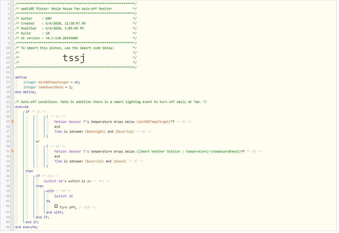

Not a problem per-se, but I am wondering if the way I coded this piston will work as I expect regarding the triggering of the statement #31.
There are two conditions I want to use to turn off a fan (Whole House fan in example). The 2nd case logically is when the outside temp RISES about the indoor temp (Motion Sensor 7 in example). However, I coded the condition to test if the indoor temp drops below the outdoor temp, so that (presumably for efficiency) only the indoor sensor triggers the piston.
What I am wondering is the case where the indoor temp is stable, and the outdoor temp rises – will the piston get triggered to evaluate in this case? Logically the two ways of coding the test are equivalent but I suspect resulting piston triggering behavior may not be… so I thought I’d ask.
Asked more simply: In statement 31 must the Motion sensor’s temperature drop to trigger the piston, or will any change in temperature trigger it (and then evaluate whether it logically dropped vs the evaluated expression that includes the SWS temp).
