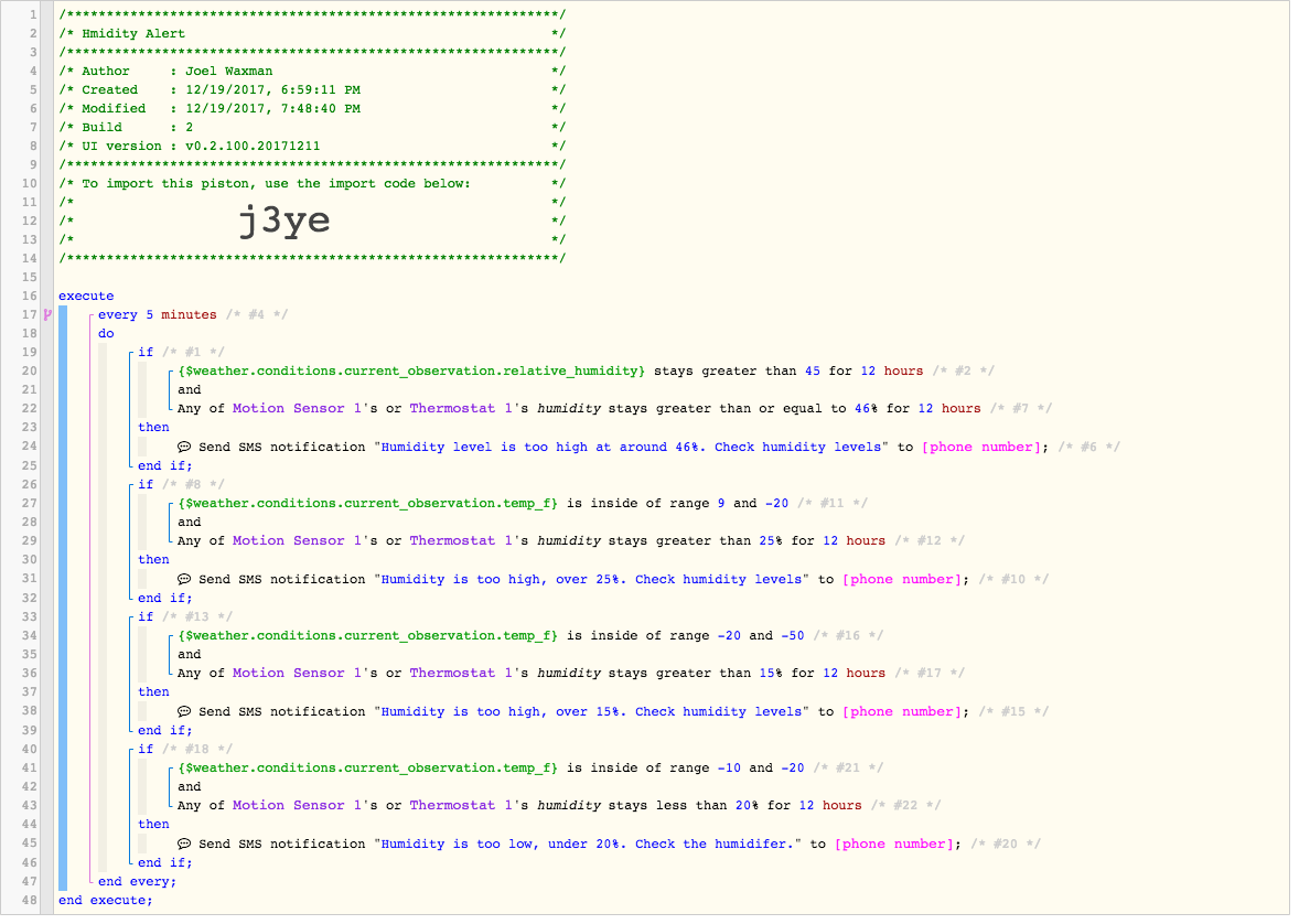

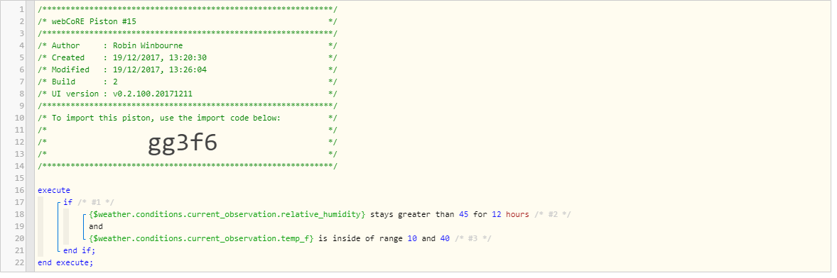

Here is what I need.

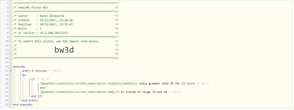

I’ve used the outside humidity as measured by your local station, but for your purposes you will probably need to continue using your inside sensors… just included the $weather as an example.
The temperature expression should be good for you though.
You will also need to add some kind of trigger above this because webCoRE doesn’t subscribe to the weather, it will just check it when asked… maybe use a timer, every x minutes.

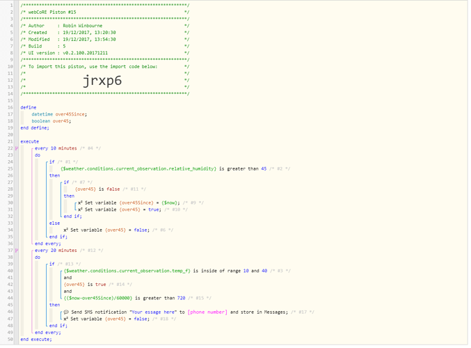

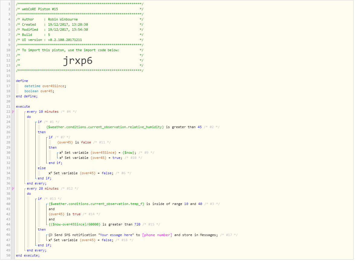

Edit: your stays greater than 45 for 12 hours is tricky… give me a sec to tweak!!
OK thanks. I appreciate this.
Try This:
Though if your’e using inside humidity from your sensors, stays greater than (as per my first example) will work and you don’t need it to be so complicated.
Thank you, I will try both and see which will work better for me.

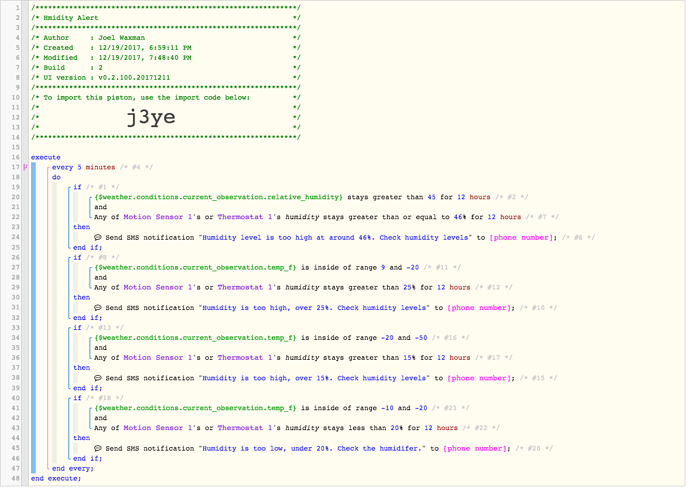

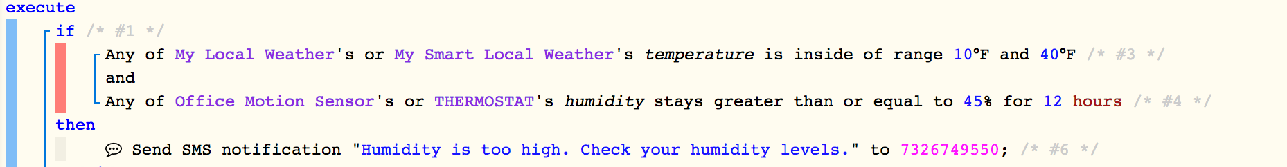

Does this look OK to you?
#15
Looks good, except the first if with ‘$weather… stays over x for 12 hours’… not sure if stays works with weather (we can’t subscribe to what it was before).
Give a try with a shorter duration, maybe I’m wrong.

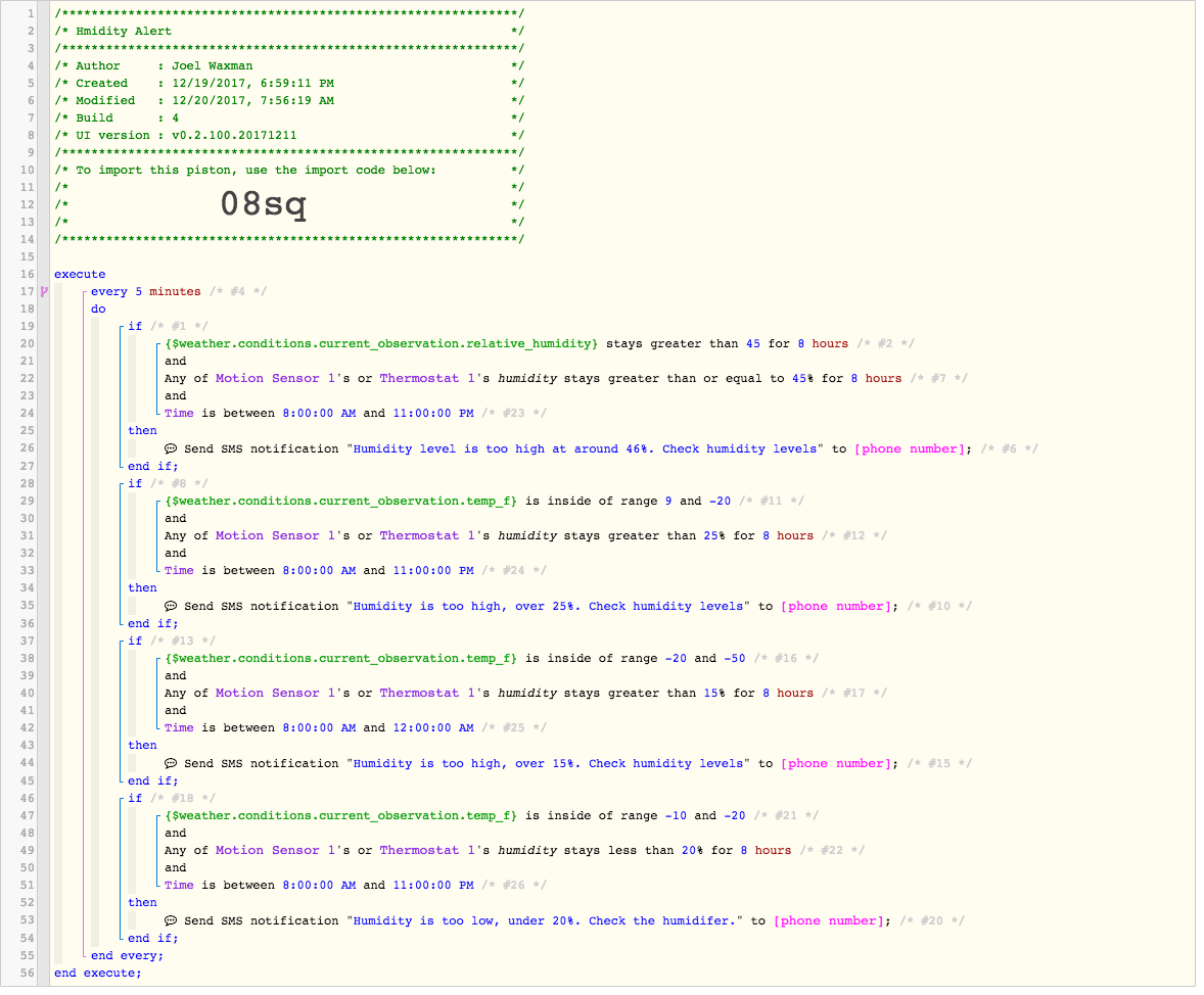

OK should I change all the 12 hour comments? I plan to add a time restriction also so it doesn’t go off in the middle of the night. Bellow is the updated version. How does it look?
#17
Looks fine… But I only mentioned shortening the ‘stays … for 12 hours’ for testing, not production.
