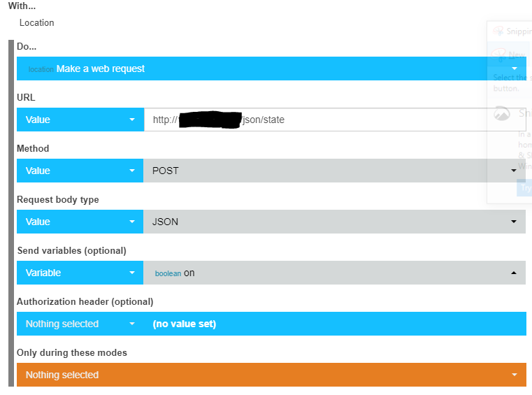

When sending an on or off command to my lights they don’t.
ESP8266 Dev Board
The lights turn on or off
The lights aren’t turning on or off

Yes, many many times. There are no errors which is making it confusing as to why the lights wont respond to the program. The lights work fine through curl in terminal.
The log posted above only appears after the query timeout…
It does not show the initial commands.

I figured that out and it is basically doing the same thing, not saying any errors in the log but not making any actual change to the lights. I’ve been following a tutorial a guy posted on his blog and followed every step exactly yet it just won’t get the lights to change.
When I am trying to make URLs work, I first test them without the piston. Try in an editor putting the URL string together as you think it should be. Then paste it in the address box of a browser to see what it does. There you might see any errors produced. When you get it working in a browser, then you know what to put in your piston.

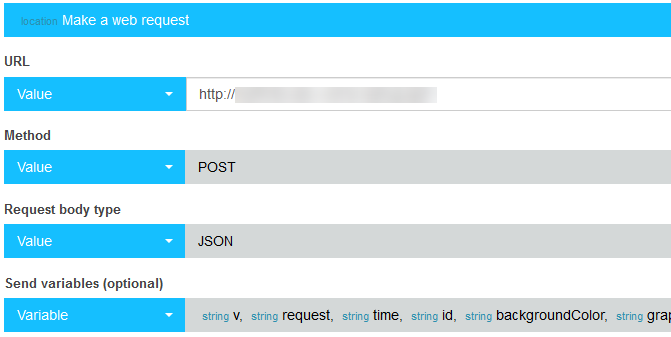

If you are a visual learner, here is an example of one of my posts.
pic
(Note, all of those variables are set prior to the web query)
I tested it in an address bar and it gives me what it’s supposed to. Also, when I put the same IP into a terminal and using curl to send a POST request it turns them on and off. From what I’ve seen, all I should need to do is add on http:// to the IP that I used in the terminal to WebCore yet WebCore doesn’t make any change to the lights. Could there be something I’m missing there?

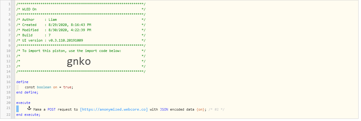

Did you try storing “true” in a string variable called “on”, and sending the way I did above?

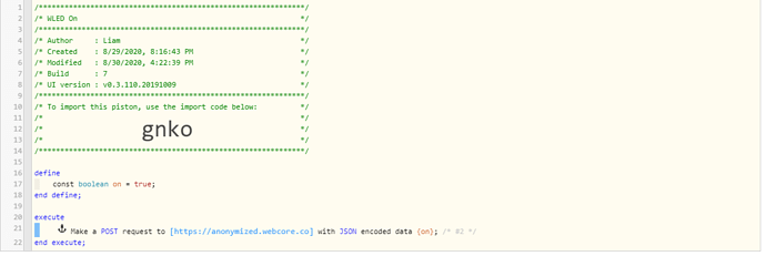

This is what I have
#15
I am not sure if it matters, but up in the define section, I use the variable type “String (text)”
pic
… which spits out:
pic

Just tried that and there’s no change. This is so strange. It should be such a simple task yet it’s all screwy

You can see the code (other than the IP) that i put in in the screen shot i replied with where it says url, what would i need to add/ take away. (The guy who posted the blog hasn’t been answering questions sadly)
