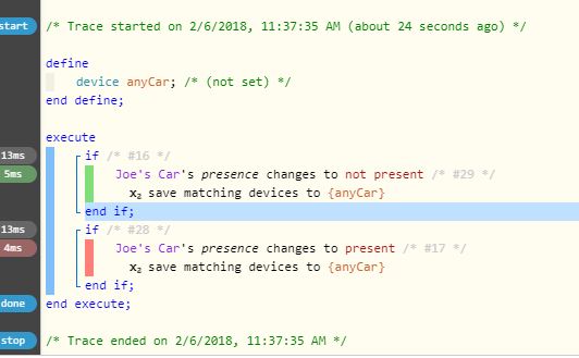

I’m trying to save devices to a variable based on presence. This snip is from a piston I built from scratch that almost works well. Any help would be appreciated.
Store the names of vehicles when presence changes and then use them in notifications,
ie “Joe’s Car has left. Location mode is X. Themostat is Y, etc”

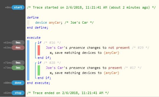

When true, the second IF stores the device name as expected (Joe’s Car),
snip%20b
BUT, when the first IF becomes true, the device ends up being (not set), instead of (Joe’s Car).
snip%20c
I have changed the order of the IF’s and the behavior always works for the second IF but not the first. That should tell me something, but at this point, I’m at a loss.
Log from “Not Present”:

Each time your piston run, it executes both IF statements.
When your car is NOT PRESENT, the first condition evaluates TRUE and saves “Joe’s Car” to the variable. Then your second condition evaluates FALSE, and saves its matching devices (none) to the same variable.
When you car is PRESENT, the inverse is true and the 2nd statement saves “Joe’s Car” to the variable.
In reality, you’re only ever going to see the result of the 2nd IF statement in this piston.

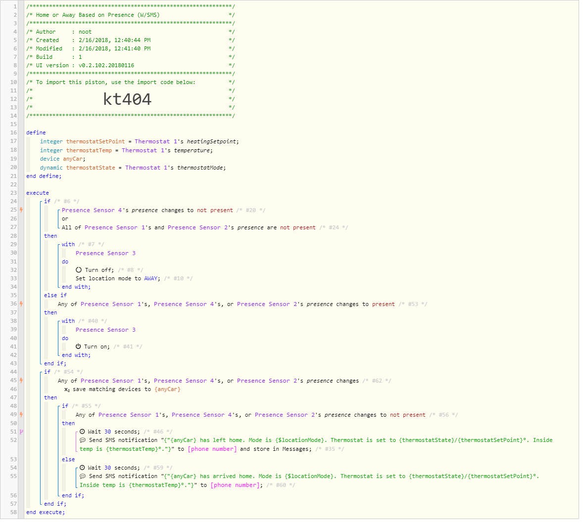

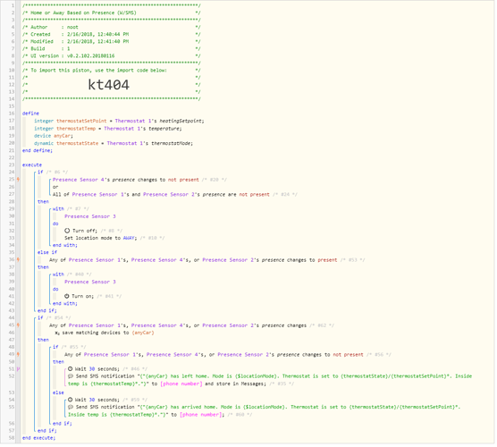

I have a total of 3 physical sensors that I’m trying to integrate. Sensor 3 is a virtual switch.
Sensor 4 is a sensor on a fob that one of us will grab when we’re getting in the others car (or we’re both going for a walk) that overrides what #1 and #2 do.
The first “if” is the original piston. The second “if”, which seems to be now working, is what I’m trying to add to the piston. I’m going to roll up my sleeves and try to integrate the two “if”'s together. Any additional input is greatly appreciated.
