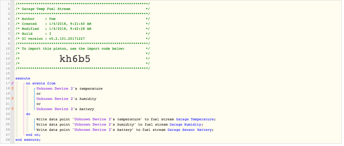

I am trying to generate a fuel stream using the Xiaomi barometric pressure measurement, but it is not available to use for some reason. I am using the bspranger device handlers, and barometric pressure is reporting in. Is this an issue with the device handlers or webcore?

Barometric pressure isn’t showing up in the drop down menu. I have had this fuel stream running for weeks already on another xiaomi sensor, so it should be fine.

I haven’t defined it because it wasn’t available. It is reporting in SmartThings properly is what I meant. Sorry for the confusion.
