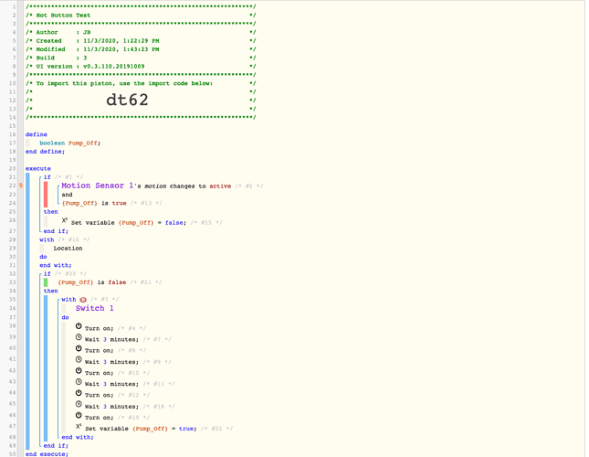

1) Give a description of the problem
Motion triggers seem to expire when motion stops
2) What is the expected behaviour?
I’d like to when motion is seen, press a button via a Zooz multirelay, and repeat every 15 minutes for a period of time.
3) What is happening/not happening?
It presses the button once, and then while in “wait” motion stops and it stops the piston all together
**4) Post a Green Snapshot of the piston![image|45x37]

Thanks for help!

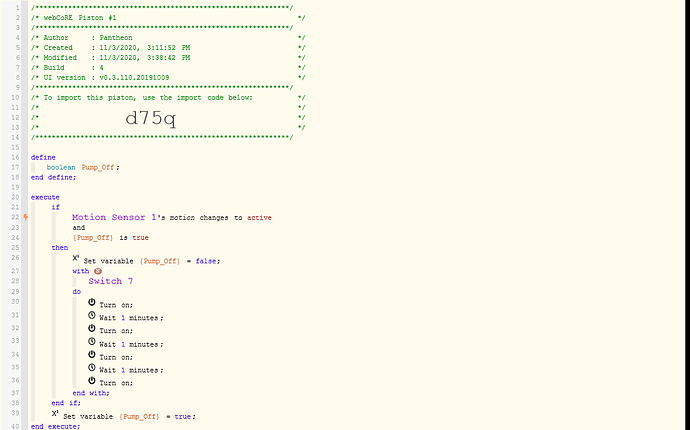

Set TCP (Task Cancellation Policy) to “Never” on your WITH.

Still Canceled itself when motion stopped OR maybe its restarting each motion event? it is possible once it gets passed the IF it will stay locked into the WITH without restarting?

Still restarting on a new event

Yes, if your motion sensor is triggered again before it completes your WAITS, then you will have problems as your piston will run from top to bottom again. And your TCP does not need to be set on the IF.
EDIT: you can use a variable to monitor your pump status.
Try this…keep in mind that it will have to cycle once to set the variable.

Ok, so is there a work around? Because the TCP on the WITH doesnt seem to change the behavior

Still not making it past the motion stopped, and reseting when motion starts again
#10
Yes, the same for my tests too. I’m missing something…
#11
This kinda works, but still resets on new motion event:
similar and also doesn’t work:

What about something like this? You should only have to change the three variables at the top to test this out.
#13
it seems to be running kinda randomly… but looks promising will continue to test and see what its doing
Thanks
EDIT: So this mostly does work, but I have some random On commands outside of the interval… kinda hard to figure out why
#14
I’ve written code just like this many times before, but I cannot get this to work. I am still working on it.
#15
Not sure why I had to do it this way but I think this works. I’m sure I am missing something here and someone will chime in.

Why not using a single WAIT, for 4 minutes?
And using a motion sensor for something like this is very tricky…
#17
Testing this now on the second relay to see how it compares. Thanks for taking the time to mess with this.
#18
I was just using WAIT for my first attempt, but it would reset the clock on new motion events.
I assume a vibration sensor would have the same issues as a motion sensor, but if I just set up a button to fire it, I am sure my wife will forget to press it before running the machines, so I am trying to make it automatic somehow
#19
You are welcome. That is why many of us are here.
#20
Is your other piston paused? I can’t tell you how many times I create a piston to test an idea and forget to pause the other one so things appear to turn on and off randomly. lol
