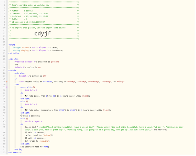

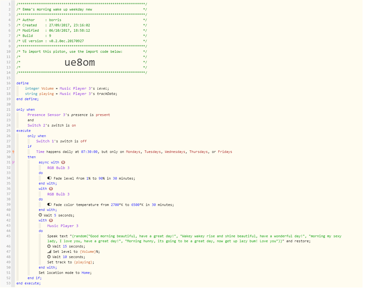

Evething else tends to work but no mater how I write it eather it doesn’t change the temperature at all or it skips to the end. The other thing is there track variable I can’t get that to work correctly.

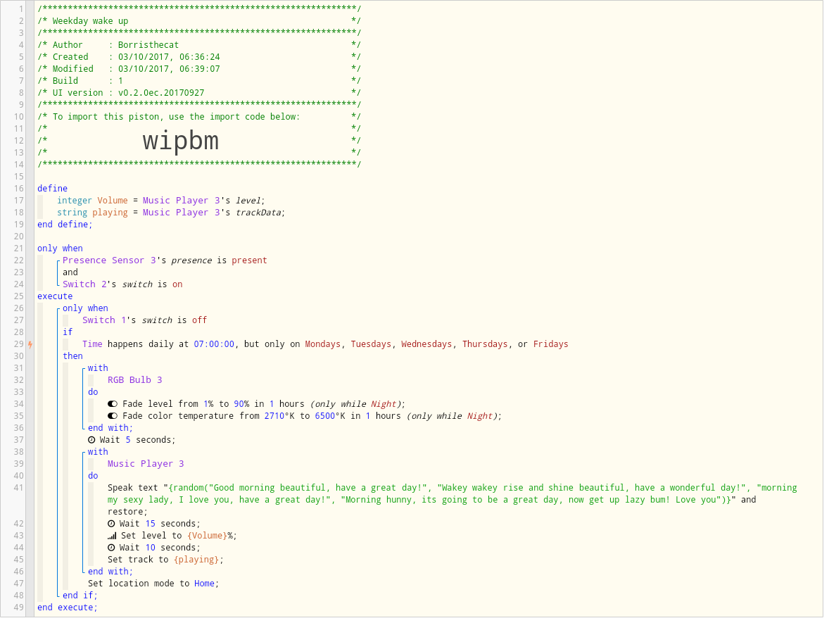

When the wife is there at a certain time the light comes on at Min and at 2710k, then over a hour gets brighter and changes temperature to 6500k. Then after the hour speak the random text on the Sonos then restore the Sonos level and track to what was in the que before (what I actually want it to do is speak a set of random text depending on if the weather is going to be nice or not using two sets of random text)
Can get it to brighten but not change temperature

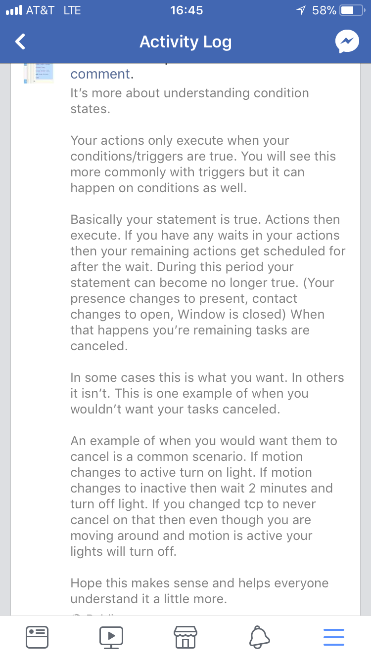

Select all your actions (with statements) and change the TCP to never cancel.

Ok will try that

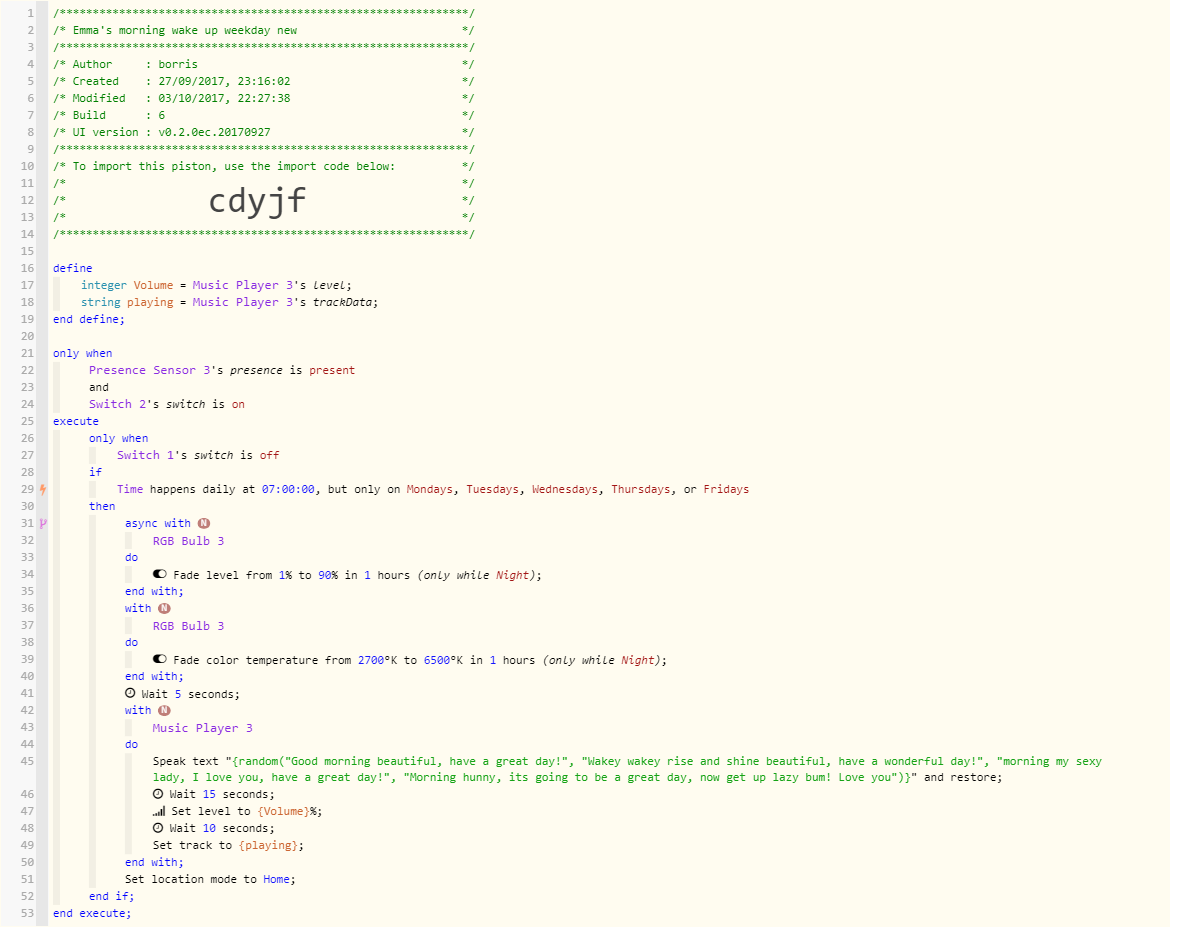

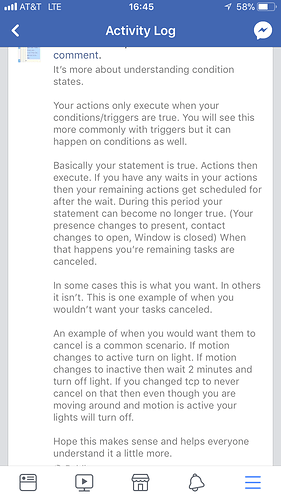

Edit: had to make a few more tweaks to how i had it before i put it on here, as i must have been slightly on the right lines but thanks @c1arkbar you got me over the line! Why does having never cancel set make such a difference, surely it shouldn’t have been canceling in the first place?
This is my tested piston but only for 5 mins so ill let you know after tomorrow morning if anything else didn’t work.

Gonna copy paste an answer to this question from the Facebook group. Couldn’t get the Facebook app to open the actual comment or let me copy this so a screenshot will have to do

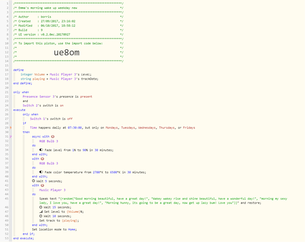

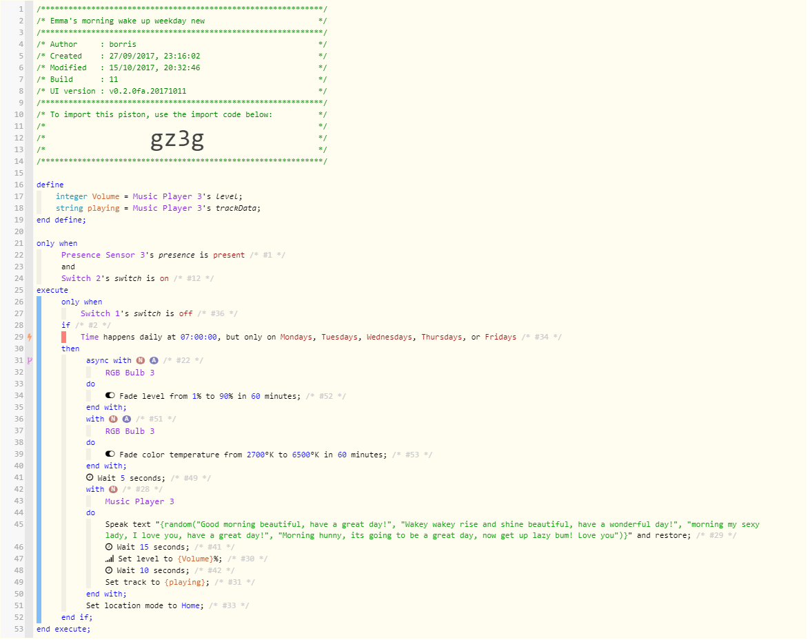

Still having issues but it seems to be to do with the fade time. It works for 5 mins 6 mins and 30 mins but not for 50 mins, 1 hour or 60 mins.

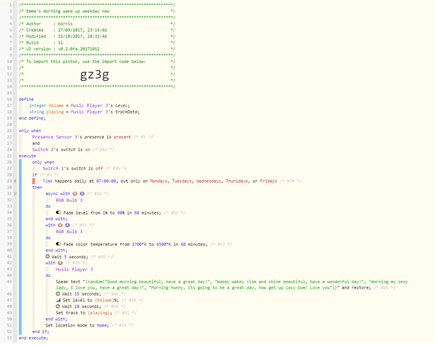

Hi @ady624 have you had chance to look into the timer? If it helps, I will edit a piston again and put it back in for a hour and put trace and stuff on .
not @ady624 :slight_smile: but set TSP to allow multiple for both with groups with fade tasks and it will work as expected.
It works as expected as it is (is there something else i have missed though?), the issue is if i change the timer from 30 mins to 50 mins or 60 mins or 1 hour it doesn’t work?
right, have you already tried setting TSP to allow multiple with 60 min timers and it doesnt work?
I think I tried it at the beginning, but I will try it again to make sure and let you know the results tomorrow.

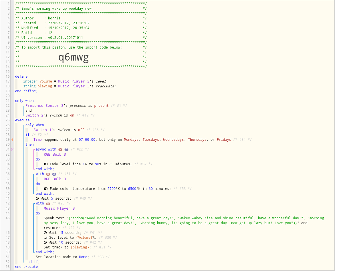

Is this what you mean?
yes please.
Nope, same again it just keeps pending then looking like it worked then pending again, but no logs to say it working. But it was working before without the TSP and if it was set to 30 mins.
