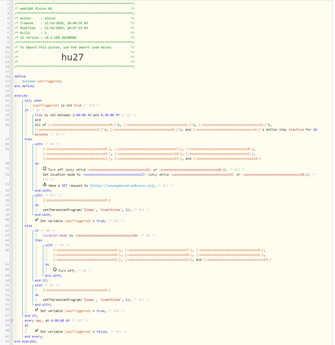

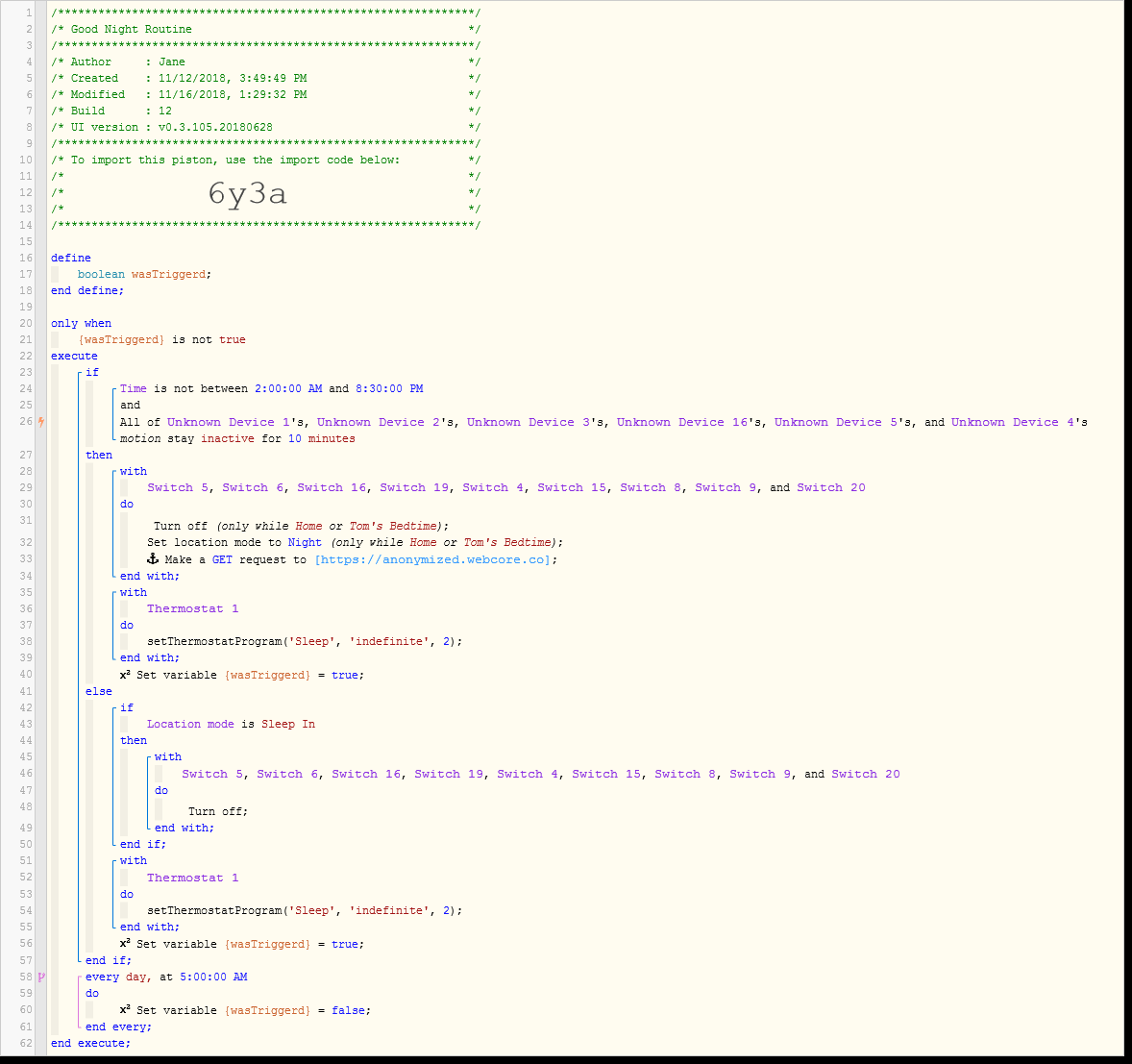

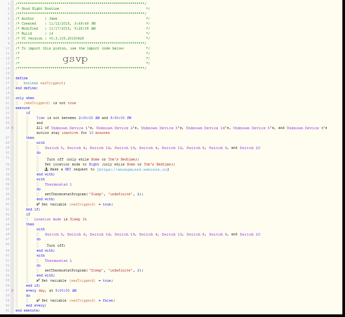

This piston did as expected at about 10:00 last night and then at 1:30 in the morning it did it again and we all got notified on sonos.
For the piston to just do it once at night
Doing it more than once at random time.
Can anyone help with this. I tried to to put a cancel condition on the top “IF” but then it didn’t run at all.
. I do see your point about the Else. The variable is there so that the piston doesn’t run more than once as it did the other night when we were all tucked in bed sleeping it told us again at 1:30 that the house was going to night mode. So by adding the variable it would cancel the piston once it has run.
