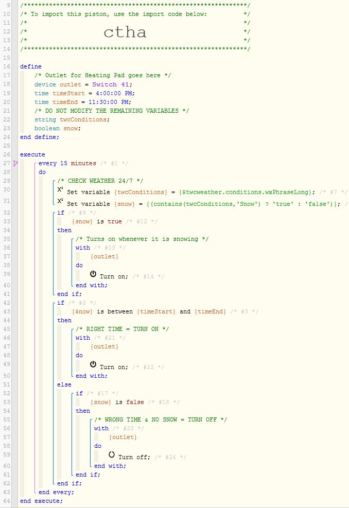

The tricky part is, no $TWC weather occurrence can alert us automatically. We actually have to make a request to see what the current weather is. Here is a piston that runs every 15 minutes, and takes action based on your request:

Hello! This has been humming along beautifully - TWC has so far been accurate for me.
Now, one more thing - the holidays are over! I only want the snow trigger, I want to remove the “turn on if it’s between TIME”.
I THINK I simply need to remove lines 14, 15, 41-55, and remove “WRONG TIME” from line 61.
Is that correct? And - I’m going to make a copy of this as is so I can use it next year.

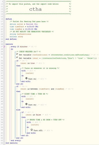

In my picture above, line 14 is:
and line 15 is blank…

Ok, I just want the snow part - I want to remove all the time constraints.
So remove lines 19 and 21, 43-51, move 52 - 61 to above the “else”, and remove the (current) line 55.
Lines 21 & 55 are comments (in green text). These (optional) lines will not execute, but are only notes for your convenience.

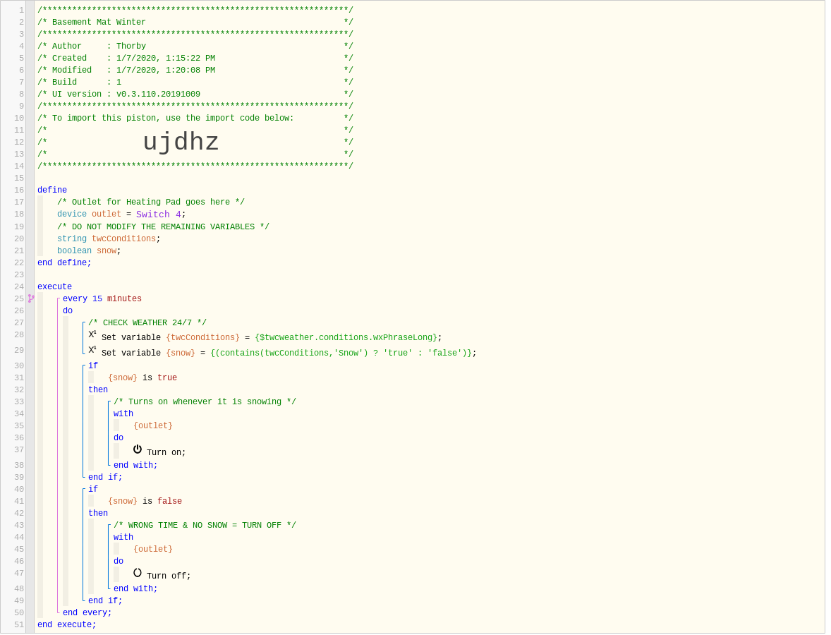

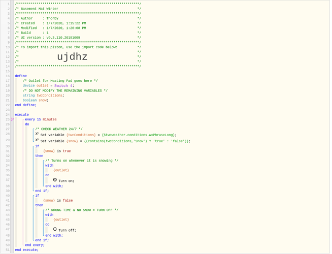

So this is what I ended up with:
I think that’ll do it.
Can you tell me - how to edit green optional text, and how to add it in the future?
Piston ujdhz looks good!
As a safety precaution, I would encourage you to add extra conditions so it does not run when you are asleep or outside the house.

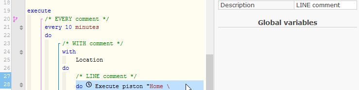

When in Edit mode, you can click to the right of most lines (which selects, as seen in the left margin). Once selected, you can type in the “Description” box in the top right to add a comment.
