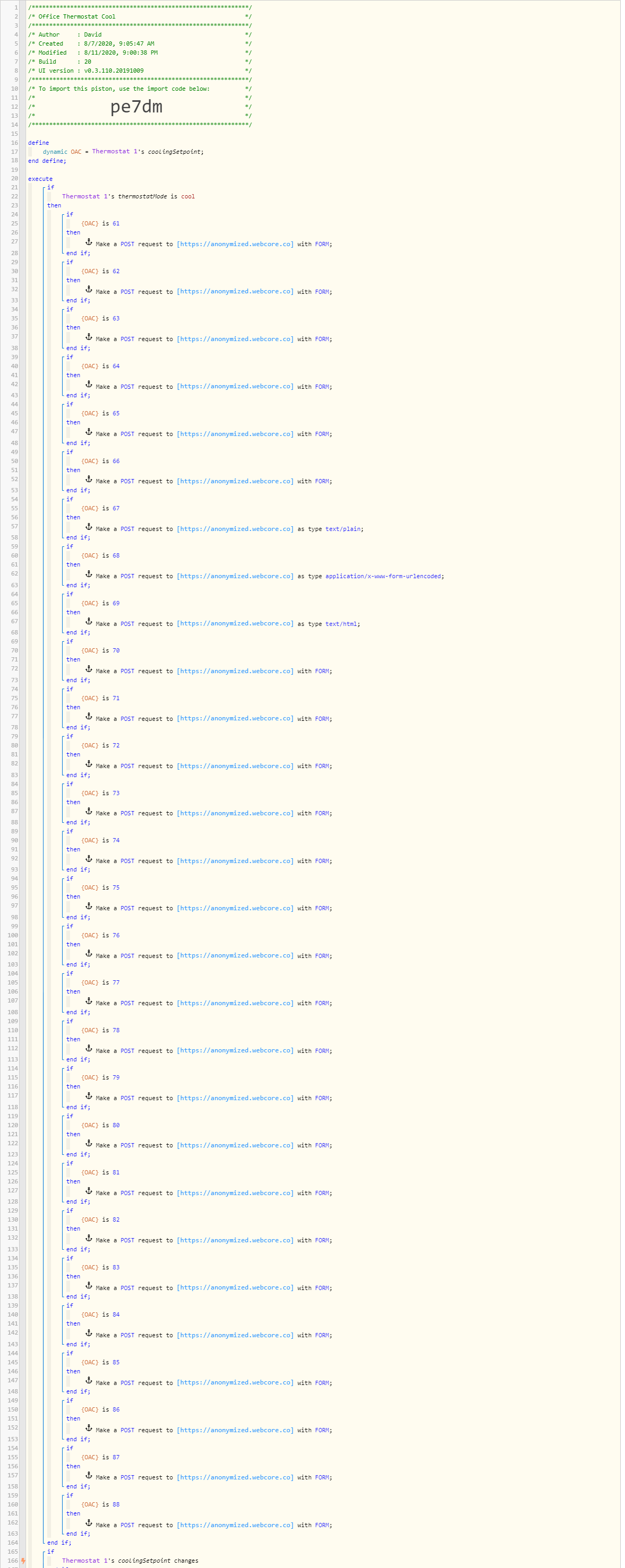

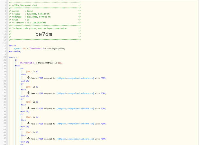

when I make a change on the virtual thermastat it should send a web request POST to my tasmota IR blaster
(PUT YOUR INFO HERE)
the IR Blaster does not seem to receive the command correctly

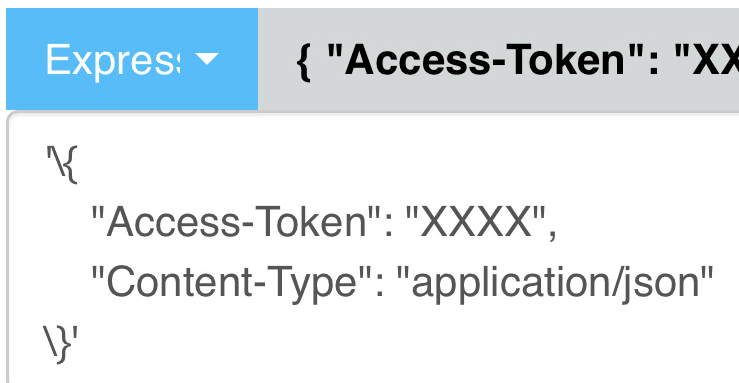

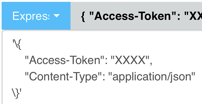

If you are using an Expression box, I believe that { and } must be escaped with a backslash \
… not a forward slash /
For example:
(also note the single quotes vs the double quotes)

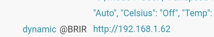

Do I was finally able to get it working with some help on another post
Thanks for reporting back… Perhaps you can share the solution to help others in the future?
Sorry you bet

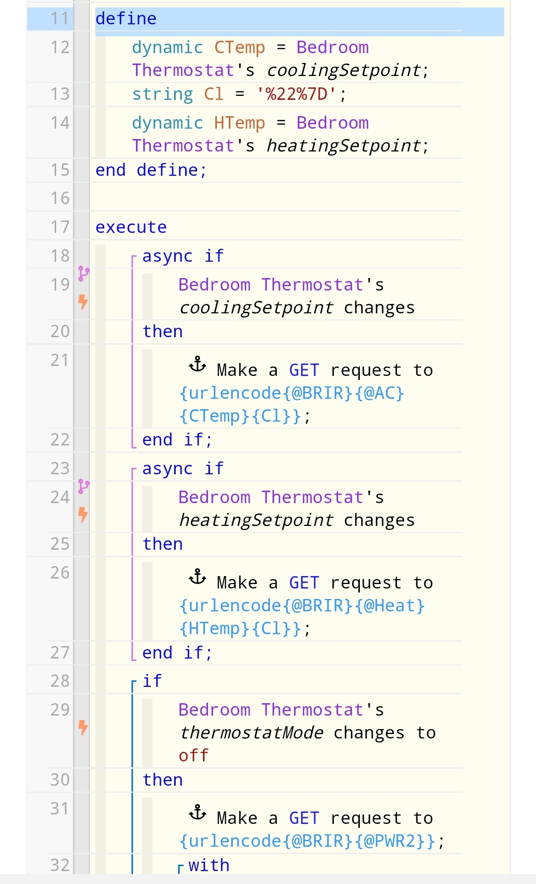

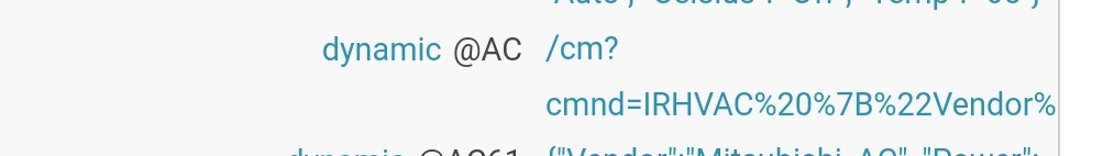

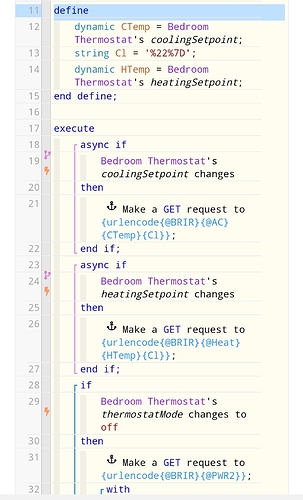

I had to %22 for all double quotes. Once I did that it began working below is the post from Hubitat. Also they are not set to async any longer
Screenshot_20200831-161611_webCoRE
