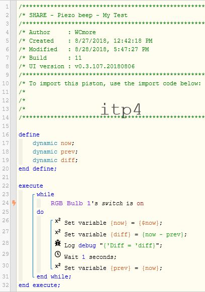

I have a real basic piston. If switch is on, log once every second.
I have tried using a WHILE loop as well as a REPEAT loop with the same results.

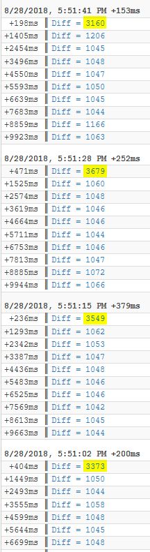

Log should write one line every second while the switch is on
It works great 10 times in a row, and then there is a 3.5 second delay, then works ten times in a row, then a 3.5 second delay… Can anyone please shed some light why there is a hiccup after every ten seconds??
(and more importantly, how to bypass that issue)
4) The variables below are just to make troubleshooting easy
5) The log below was left running for over 30 seconds straight
Notice the highlighted pauses being MUCH more than they should have been.
Is there a workaround for this, or should I file a bug report?

Upon analyzing my FULL log, I notice a pattern.

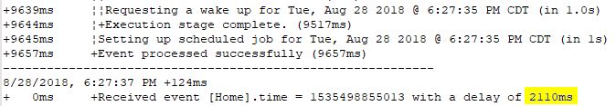

At the end of the 10th log (the last in the cluster) it schedules a wake up for 1 second in the future. But for some reason, in the next cluster, there is an extra delay of more than 2 seconds. This is the EXACT delay that is impacting this piston.
Here is an example focused on the last few lines of one cluster, and the first few lines of the next one.
(Sorted chronological, not the way it displays in webCoRE)
temp
This extra delay repeats every ten seconds, and is the likely culprit.
Any idea why the 6:27:35 wake up did not happen until 6:27:37?
