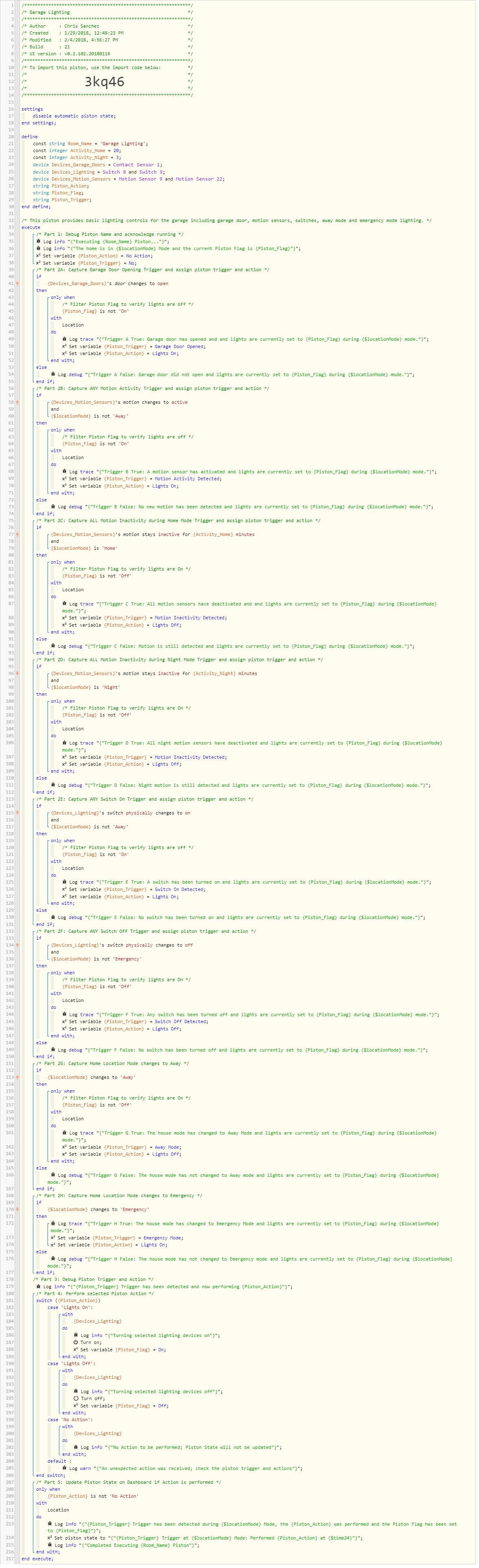

Ok, this makes some sense. I have been heavy handed in my logging statements, not aware that was penalizing me. Also makes sense as to why some of my piston sizes have gotten so large in file size even though my typical chunk sizes are in the 20-22 range. I find my response time on the pistons reasonable and latency to be minimal so I have to have gotten something right. I have also gone through them to make sure I don’t have any busted variables or dead end logic.
My piston layout is, to be honest, not the most efficient in file size. But I write them so the logic is easy to follow so that I can come back at any point and quickly re-understand what I did and edit it later. For example, I have triggers update an “Action” variable and then use a Case Switch to perform the action statements. This came to be because I was having to much repetition where multiple triggers resulted in the same action, and sometimes the action was not consistent with intent as the code was too cumbersome to follow. But I do use a lot of False Trigger logging to help debug and finalize the piston.
Now, do comments also count towards this 100k limit?
Here is one of my sample pistons. I use this logic outline is just about all my pistons. My plan was to develop a piston for all my major lighting groups and have all triggers within a single piston…as opposed to having multiple pistons each with a few triggers controlling a single light group in competition. For the most part it will result in one piston per room. Larger rooms will have multiple pistons though. I find this approach leads to a cleaner dashboard.

I wouldn’t worry too much about piston size / extra logging… WC self regulates and it won’t slow things down by anything noticeable.
Thanks Robin. The only reason I worry about it is if I start expanding on the piston above, I can no longer save it. I get the spinning squares. For example, I wanted to capture double tapping on my switches, but it just won’t take.
