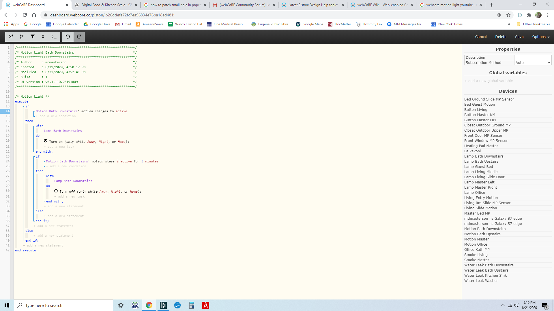

I would like my floor lamp controlled by a smart plug to turn on with motion and off if no motion is detected for three minutes.
Turn on with motion and off with three minutes without motion
Light turns on but not off.

Your logic looks solid, but the second IF should be moved down below…
(Totally outside the other IF)
IF X
    Then Turn on
END IF
IF Y
    Then Turn off
END IF
Also note, that pressing Test will not do anything in this piston.
(you actually have to walk past the motion sensor to test properly)

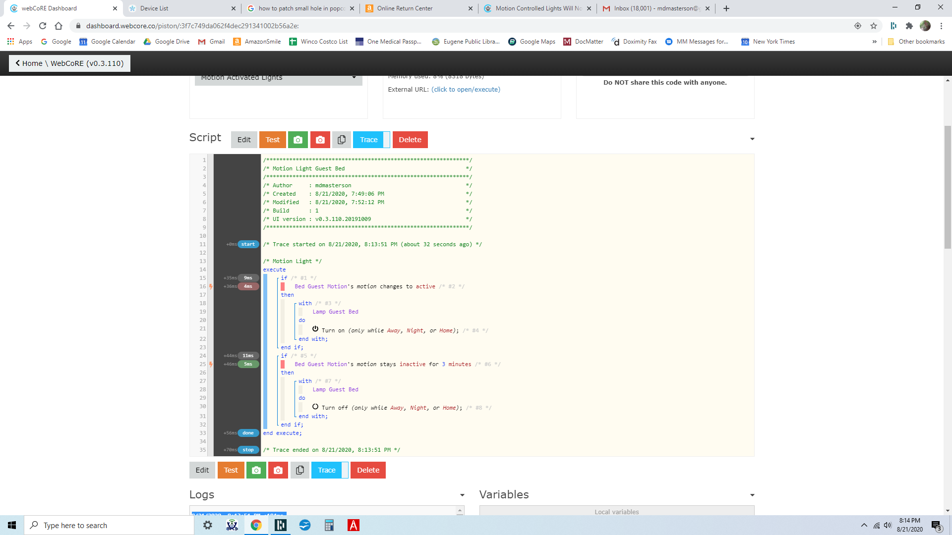

One last question (I hope). It looks like the light turns off at 3 minutes despite being in the room in front of the Smartthings motion sensor prompting me to wave at the motion sensor to reactivate the light. Is there a solution to having the light remain on while present in the room or a better way to program the piston to avoid this from happening?
Thanks for your assistance
Hmmm… Usually “IF motion stays inactive for X minutes” works well.
As long as the sensor sees motion at least once every 179 seconds, the light should remain on.
Can you please turn on Trace, turn Logging to Full, and share your latest piston & log so I can take a closer look?
Note, There are sensors (or locations) where I may increase the STAY to 5 min, instead of 3 min…

Thanks… Let’s take a closer look at the key elements:
8:20:03 = [Motion Guest Bed].motion = active   = Turn on
8:20:32 = [Motion Guest Bed].motion = inactive = Set timer
8:23:31 = Executed [Lamp Guest Bed].off        = 3 min after inactive
According to the log, there was no activity for 3 minutes, so the light was turned off.
Common solutions to a premature shutoff, is to either extend the 3 min to a higher number, or perhaps aim the sensor towards a more “action-packed” direction.

My motion sensors (Bosch) have a wait time of 5 minutes. Meaning, they only check for movement every 5 minutes. So, I cannot set the ‘wait’ time for anything lower than 5 minutes, or it doesn’t work.
I’ve found 10 minutes to be a “magic” number for my home. That way, it catches movement if you leave the room and decide to come back in.
I have many of my motion pistons set to 10 minutes.
#16
I find the second sentence a bit baffling…
In my mind, even a tiny delay would work with a STAY trigger. IE:
IF Sensor's motion STAYS inactive for 6 seconds
From what I have seen, webCoRE’s timer begins the moment the device reports “inactive” to the hub. If you set it to 6 sec, it would fire 6 sec after the status came in. (although, this doesn’t mean the room was only vacant for 6 sec)
The part I am unsure of is whether Bosch starts a new 5 min timer when it switches to “active”, or does it (for example) consistently check every hour at :00, :05, :10, :15, :20 etc… without fluctuation.
(not that any of this really matters, since you are happy with your piston :grin:)
#17
What I mean is: if I set my piston to “stays inactive for 3 minutes”, the lights will turn off on me if there is still motion in the room. Thats because the motion sensor only checks every 5 minutes. So there will not be another “active” until 5 minutes after the one that turned on the lights. So, the “3 minutes” will always be true.
#18
I see… The “active” is limited to once per 5 min, but the “inactive” can come in before that time period…
Peculiar… I wonder why they chose that logic…
(normally sensors that limit updates will also delay on the inactives)
#19
I don’t know. It took me a while to get use to. It becomes “active” on motion for about 5 seconds, and then changes to “inactive” and sets off a “check every 5 minutes for motion”. If there is motion, repeat above, if not, reset, wait for motion, repeat above.
#20
Ahh OK… So even if the whole family was breakdancing in front of it, it only shows “active” for 5 sec out of every 5 min…
I now see why you coded the way you did.
