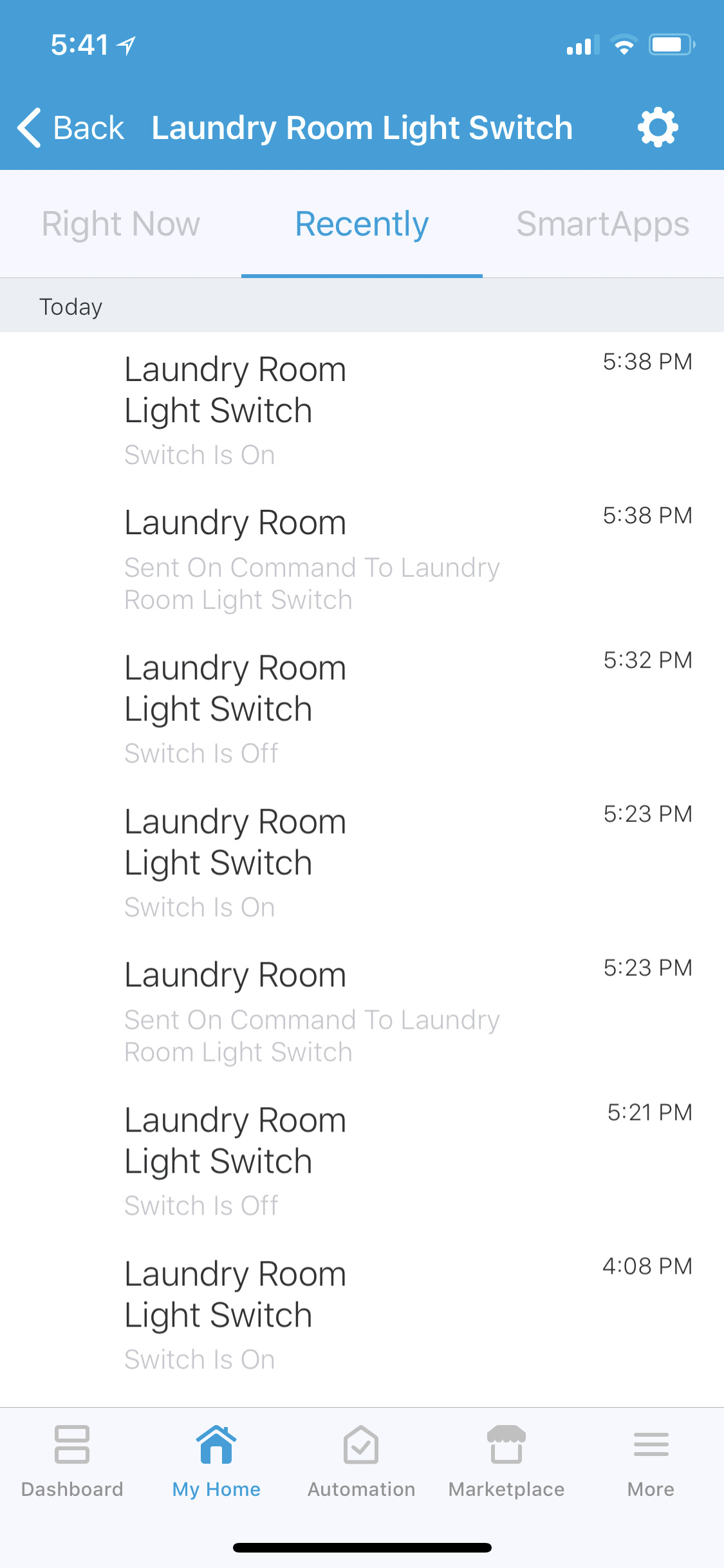

#246
The only other SmartApp I have is a tile piston that tells the switch state.
It actually happened again. First screenshot is my configured motion sensor:
This is the history for the Laundry Room:
At 5:38 I believe the room turned on the switch. Unless I’m looking at this all wrong.
I actually had the logs running at the time.
I can’t understand it. I turned the light off at 5:53 from ST app and the Room is turning it right back on.
Laundry Room is Vacant and no motion.
#247
on the light rule can you please pick the state to be occupied and this should be resolved. without that the lux value dropping is probably triggering it.
#248
Adding the state = occupied, seems to have fixed it for now.
Very strange as I have 3 other rooms defined exactly like the Laundry Room, that does not behave this way.
Thank you though :smile:
#249
do they also have lux setting? if there is a lux setting and no state defined in the rules and any of the rules matches all of the rule conditions, that same thing will happen.

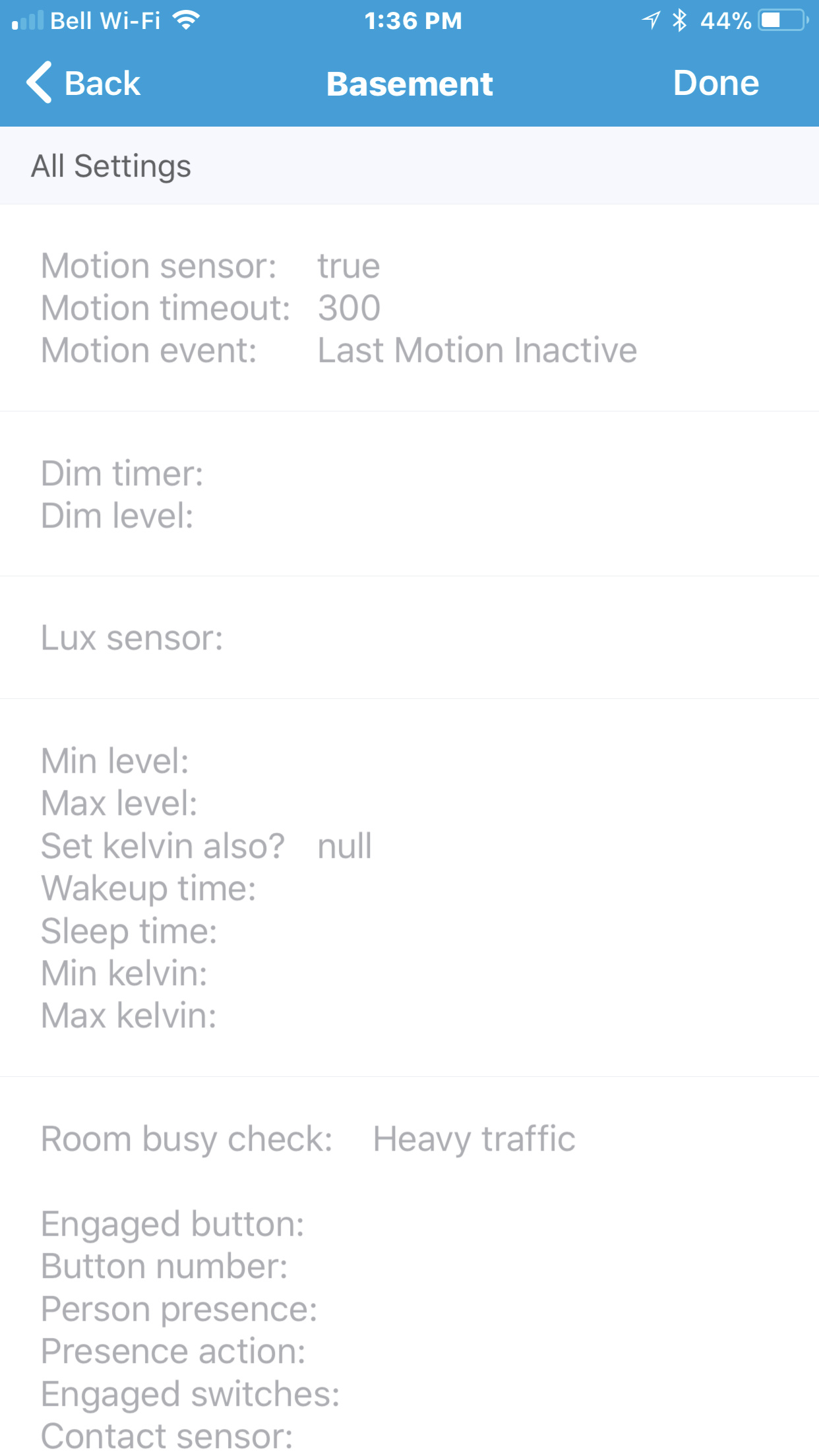

#256
Here are my settings for the basement. Although it says “Heavy Traffic” in these settings, I actually have “Light Traffic” selected. Also, with the Lux setting, does it only work if the Lux is the number that I put in that setting? For instance, I wanted some lights to go on only if the Lux was below 50. When I put 50 in the lights didn’t come on because the lux was 47.7.
#257
thanks for this. could you please scroll up so all the rules are shown and then take the second screenshot?
after creating the rule next time the lux is below 50 and there are switches to turn on they will get turned on. i use the lux feature extensively and it always works that way.
