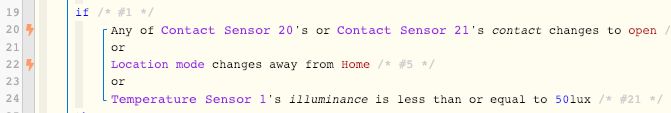

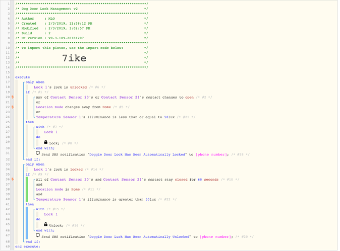

I wrote this simple piston to control the lock on a doggie door, allowing it to remain unlocked when it is safe for the dogs to go outside on their own (we have foxes and coyotes around), and keeping it locked when it’s not safe.
The doggie door is to remain locked when any of the following are true: (1) either of our backyard gates are open; or (2) no one is home (i.e, mode is not HOME); or (3) it’s dark out. In reverse, the doggie door is unlocked when all 3 of the same things are true.
I noticed that when the piston runs, it sets a NEXT SCHEDULED time for the piston to run 24 hours later, It therefore appears to miss important events in the interim. As a webcore newbie, I’ve tried to read up on scheduling policies, but I must be missing something.

Seems straightforward to add a condition that the doggie door has not moved in the last 10-15 mins (I have a sensor on the door flap that counts the number of times the dogs go out, so when my kids lie about it, presto, nailed.)
