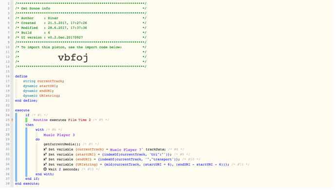

How do you grab the track data as a variable i have tried everything i can think of and i just can’t get it

It’s for these pistons I’m trying to store the playing track in a variable to then return the que or track to how it was.

Hi @Einars I don’t quite understand the piston what does it do?

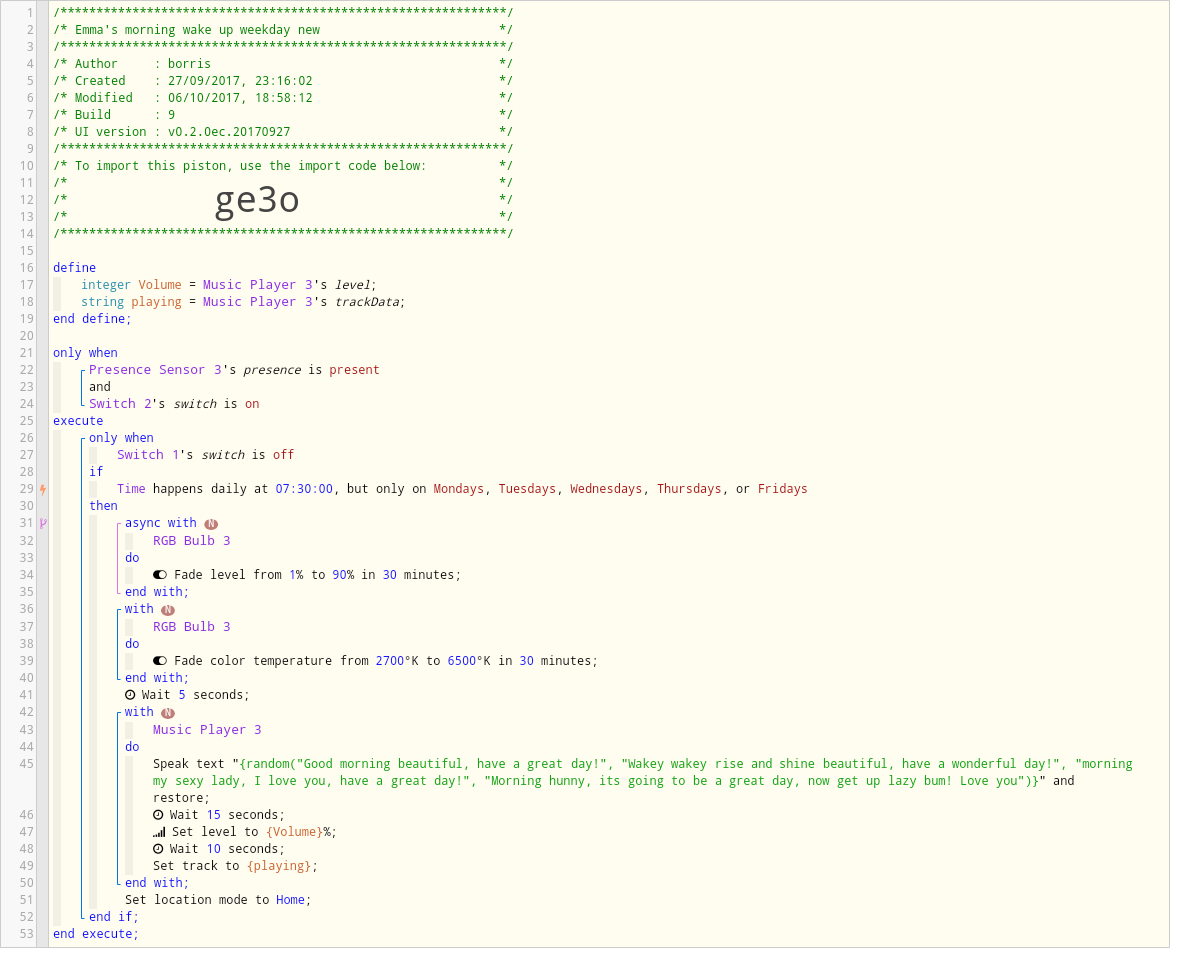

If you edit the trigger so something at yours trigger it. And you set your Sonos speaker as speaker. Then play something on your Sonos speaker and trigger the piston. You will then see the variables get filled with info from the Sonos.
I don’t put it in a variable as I have no need, but no reason why it couldn’t.
