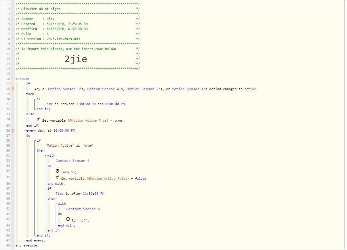

now i cant figure one how you added
Every day at 10
Do
If motion Active is true
I can add happenes every day at
but I dont think that the same
Try clicking on “Add a timer”

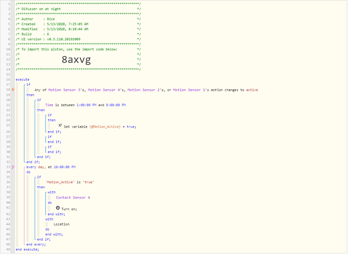

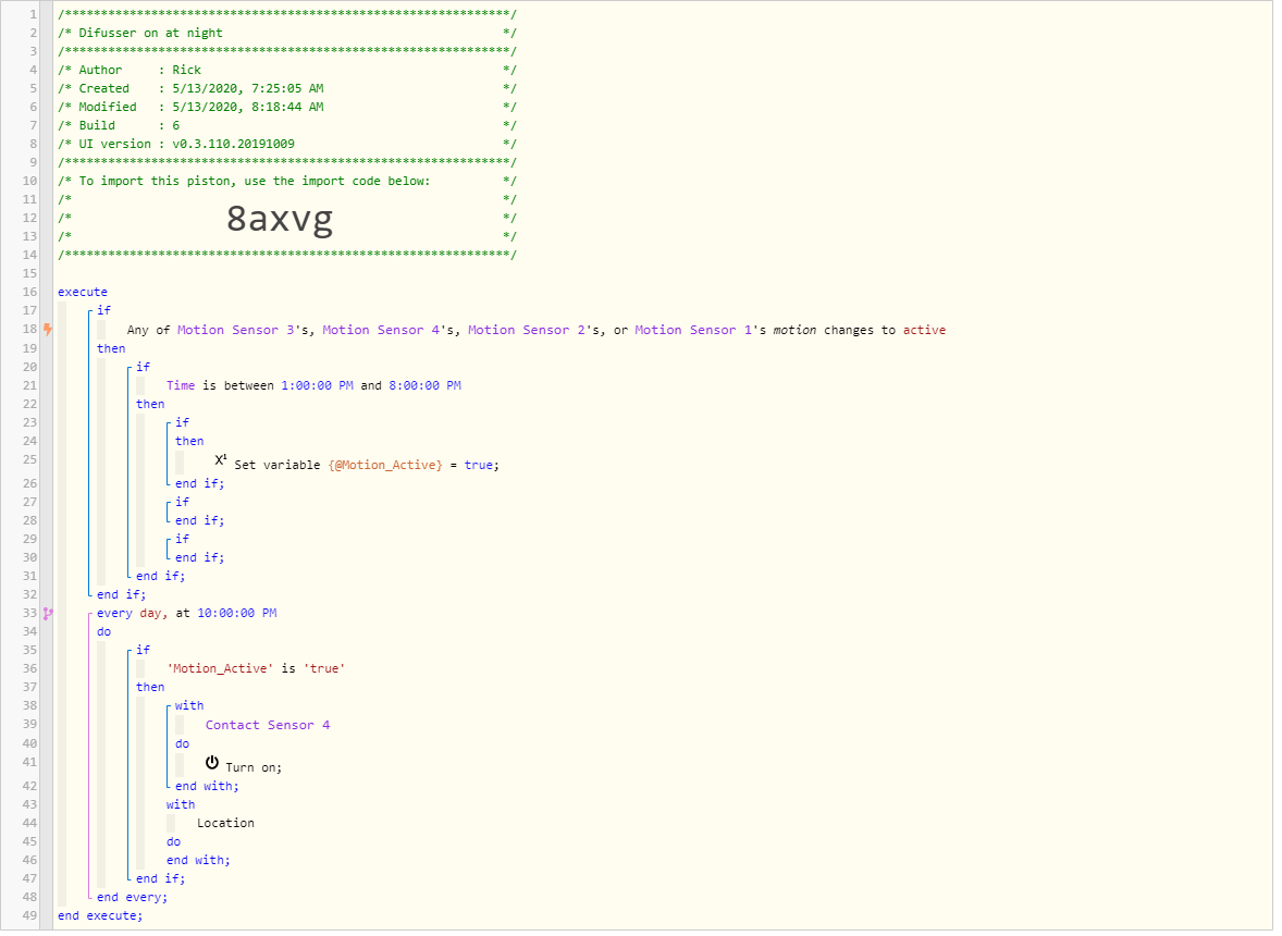

This is what I have so far
When I try to add Set Motion_Active = False
I get an error “invalid variable”

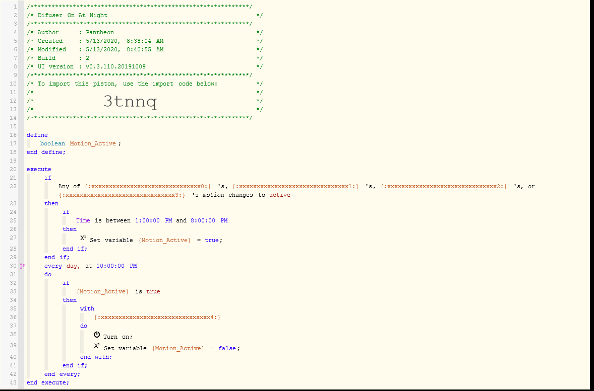

Very good. You are getting there. But you need to make some changes.
  1. Define your variable Motion_Active in the define section at the top of the piston. Go to the top right of your piston and click on Options and check the Show variables.
  2. Under your Time is between 1PM and 8PM, take the set variable statement out from under the IF and have it as a statement by itself.
  3. Remove both blank IF statements below it.
Am i close
Load this piston with the code 3tnnq and insert your devices.
#15
Ok
I see what i was doing wrong. I didnt define the variable at the start of the piston
Also I had the set variables in the wrong place
Thanks for your help Pantheon

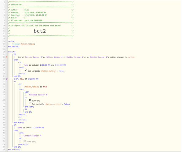

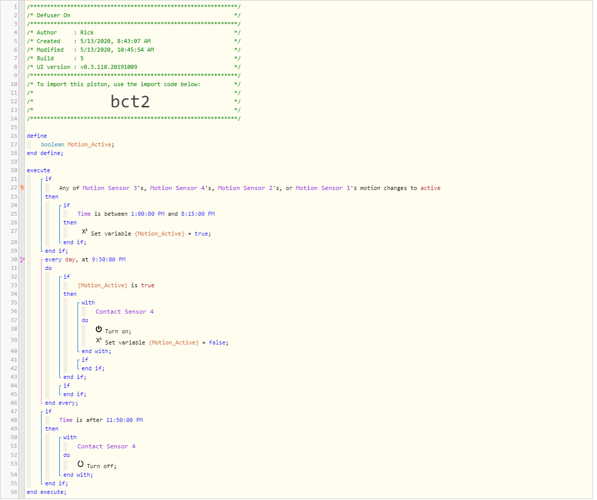

Now I know a little about variables I have a momentary switch on my garage door opener and a contact sensor. (Want it to close at sunset and if open anytime after that for 15 min. The piston does not work on occasion. Maybe I would be better off using the contact sensor in a variable
#18
Looks good. I would delete the empty IF statements at line 41 and 44.
#19
Done thanks
