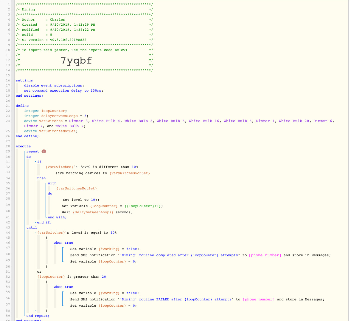

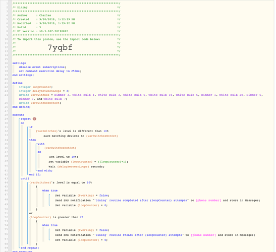

Using a loop to ensure all lights in a routine activate — lights not activating
Piston is not activating lights as intended. Piston developed to address know problem with multi-device automation in ST, where some Devices do not activate during automation.
Most lights get set to 10% brightness, one light is set to 100% brightness
100% light activates, lights that are supposed to get set to 10% do nothing
9/20/2019, 1:39:29 PM +621ms
+1ms ╔Received event [My home].test = 1569004769621 with a delay of 1ms
+178ms ║RunTime Analysis CS &gt; 22ms &gt; PS &gt; 68ms &gt; PE &gt; 88ms &gt; CE
+182ms ║Runtime (45457 bytes) successfully initialized in 68ms (v0.3.10f.20190822) (181ms)
+183ms ║╔Execution stage started
+259ms ║║Comparison (integer) 10 is_different_than (integer) 10 = false (2ms)
+263ms ║║Comparison (integer) 10 is_different_than (integer) 10 = false (1ms)
+266ms ║║Comparison (integer) 10 is_different_than (integer) 10 = false (1ms)
+269ms ║║Comparison (integer) 10 is_different_than (integer) 10 = false (1ms)
+272ms ║║Comparison (integer) 10 is_different_than (integer) 10 = false (1ms)
+275ms ║║Comparison (integer) 10 is_different_than (integer) 10 = false (1ms)
+278ms ║║Comparison (integer) 10 is_different_than (integer) 10 = false (1ms)
+281ms ║║Comparison (integer) 10 is_different_than (integer) 10 = false (1ms)
+284ms ║║Comparison (integer) 10 is_different_than (integer) 10 = false (1ms)
+286ms ║║Comparison (integer) 10 is_different_than (integer) 10 = false (1ms)
+289ms ║║Comparison (integer) 10 is_different_than (integer) 10 = false (1ms)
+296ms ║║Condition #10 evaluated false (106ms)
+298ms ║║Condition group #9 evaluated false (state did not change) (107ms)
+343ms ║║Comparison (integer) 10 is_equal_to (integer) 10 = true (2ms)
+346ms ║║Comparison (integer) 10 is_equal_to (integer) 10 = true (2ms)
+349ms ║║Comparison (integer) 10 is_equal_to (integer) 10 = true (1ms)
+352ms ║║Comparison (integer) 10 is_equal_to (integer) 10 = true (1ms)
+354ms ║║Comparison (integer) 10 is_equal_to (integer) 10 = true (1ms)
+357ms ║║Comparison (integer) 10 is_equal_to (integer) 10 = true (1ms)
+360ms ║║Comparison (integer) 10 is_equal_to (integer) 10 = true (1ms)
+363ms ║║Comparison (integer) 10 is_equal_to (integer) 10 = true (2ms)
+366ms ║║Comparison (integer) 10 is_equal_to (integer) 10 = true (2ms)
+369ms ║║Comparison (integer) 10 is_equal_to (integer) 10 = true (2ms)
+372ms ║║Comparison (integer) 10 is_equal_to (integer) 10 = true (1ms)
+379ms ║║Cancelling statement #234's schedules...
+386ms ║║Executed virtual command setVariable (1ms)
+394ms ║║Calculating (string) 'Dining' routine completed after + (string) 0 &gt;&gt; (string) 'Dining' routine completed after 0
+397ms ║║Calculating (string) 'Dining' routine completed after 0 + (string) attempts &gt;&gt; (string) 'Dining' routine completed after 0 attempts
+426ms ║║Executed virtual command sendSMSNotification (23ms)
+433ms ║║Executed virtual command setVariable (2ms)
+435ms ║║Condition #8 evaluated true (134ms)
+436ms ║║Condition group #7 evaluated true (state did not change) (137ms)
+440ms ║╚Execution stage complete. (257ms)
+442ms ╚Event processed successfully (441ms)
This code is nowhere in the above piston…
It must be another piston or programming that set it to 100%

It’s pointless to look at a log that does not match the piston shown.
Can you post matching logs & screenshots (with Trace turned on) so someone can look a bit closer?

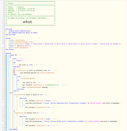

Fair criticism – thank you again for taking a look. Posting the correct screenshot and accompanying log. When this piston is executed the 100% light turns on, but the 10% lights do not.
9/21/2019, 8:22:51 AM +327ms
+1ms ╔Received event [My home].test = 1569072171326 with a delay of 1ms
+156ms ║RunTime Analysis CS &gt; 17ms &gt; PS &gt; 70ms &gt; PE &gt; 68ms &gt; CE
+158ms ║Runtime (45792 bytes) successfully initialized in 70ms (v0.3.10f.20190822) (156ms)
+160ms ║╔Execution stage started
+166ms ║║Cancelling statement #238's schedules...
+200ms ║║Executed physical command [Dining Room Chandelier].setLevel([100]) (27ms)
+451ms ║║Injected a 250ms delay after [Dining Room Chandelier].setLevel([100])
+452ms ║║Executed [Dining Room Chandelier].setLevel (280ms)
+511ms ║║Comparison (integer) 10 is_different_than (integer) 10 = false (1ms)
+513ms ║║Comparison (integer) 10 is_different_than (integer) 10 = false (1ms)
+516ms ║║Comparison (integer) 10 is_different_than (integer) 10 = false (2ms)
+519ms ║║Comparison (integer) 10 is_different_than (integer) 10 = false (1ms)
+521ms ║║Comparison (integer) 10 is_different_than (integer) 10 = false (1ms)
+524ms ║║Comparison (integer) 10 is_different_than (integer) 10 = false (2ms)
+527ms ║║Comparison (integer) 10 is_different_than (integer) 10 = false (1ms)
+529ms ║║Comparison (integer) 10 is_different_than (integer) 10 = false (1ms)
+532ms ║║Comparison (integer) 10 is_different_than (integer) 10 = false (2ms)
+535ms ║║Comparison (integer) 10 is_different_than (integer) 10 = false (1ms)
+537ms ║║Comparison (integer) 10 is_different_than (integer) 10 = false (1ms)
+543ms ║║Condition #10 evaluated false (88ms)
+545ms ║║Condition group #9 evaluated false (state did not change) (89ms)
+586ms ║║Comparison (integer) 10 is_equal_to (integer) 10 = true (1ms)
+588ms ║║Comparison (integer) 10 is_equal_to (integer) 10 = true (2ms)
+590ms ║║Comparison (integer) 10 is_equal_to (integer) 10 = true (1ms)
+593ms ║║Comparison (integer) 10 is_equal_to (integer) 10 = true (2ms)
+595ms ║║Comparison (integer) 10 is_equal_to (integer) 10 = true (1ms)
+598ms ║║Comparison (integer) 10 is_equal_to (integer) 10 = true (2ms)
+600ms ║║Comparison (integer) 10 is_equal_to (integer) 10 = true (1ms)
+603ms ║║Comparison (integer) 10 is_equal_to (integer) 10 = true (1ms)
+605ms ║║Comparison (integer) 10 is_equal_to (integer) 10 = true (1ms)
+608ms ║║Comparison (integer) 10 is_equal_to (integer) 10 = true (1ms)
+610ms ║║Comparison (integer) 10 is_equal_to (integer) 10 = true (1ms)
+615ms ║║Cancelling statement #234's schedules...
+620ms ║║Executed virtual command setVariable (1ms)
+626ms ║║Calculating (string) 'Dining' routine completed after + (string) 0 &gt;&gt; (string) 'Dining' routine completed after 0
+629ms ║║Calculating (string) 'Dining' routine completed after 0 + (string) attempts &gt;&gt; (string) 'Dining' routine completed after 0 attempts
+685ms ║║Executed virtual command sendSMSNotification (52ms)
+691ms ║║Executed virtual command setVariable (2ms)
+693ms ║║Condition #8 evaluated true (146ms)
+694ms ║║Condition group #7 evaluated true (state did not change) (147ms)
+698ms ║╚Execution stage complete. (538ms)
+699ms ╚Event processed successfully (699ms)
Sorry, that was not meant as criticism. It is just that with freetime being so precious, it would be a waste of time trying to match up contradictory clues…

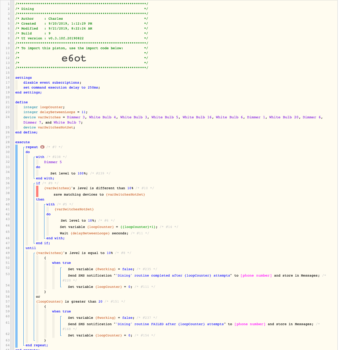

For the log analysis, would you please turn on Trace before taking a green snapshot?
That adds numbers that coincide with the numbers seen in the log
No worries! Here’s the green snapshot with Trace.
Thank you for this!
That log looks solid.
  • You pressed Test
  • Dimmer 5 went to 100%
  • Line 37 was all false so it did NOT send a 10% level command
  • Line 49 was all true so it continued to
  • Line 53 sent SMS
  • etc.
Pro Tip:
With most bulbs, if the level is 10%, and you turn it off, the hub will continue to see the level as 10%… (Even though the bulb is technically off) This is why line 37 registered as false, and the “Set level to 10%” was skipped.
Thanks! Interesting about the 10%! Thoughts on what the minimum effective level would be for this piston?
That number could be anything from 1-99, and the results would be the same.
If the level is X, and the bulb is turned off, then the level will still be X (until you send a different level)
In other words, the level only changes when a “Set level” command is sent…
(not a turn on/off command)
Got it – any other alternatives you can see to get to the desired outcome?
Do you want both off and on lights to all go to 10%?
Good question! As this is a scene, yes, I would like both off and on lights to go to 10%.
In that case, lines 36-47 can be condensed to:
With {varSwitches}
    Set level to 10%
    Set variable {loopCounter} = {loopCounter+1}
    Wait 11+ seconds
END WITH
(Notice there is no need for an IF block here)
#15
Thank you very much!
Okay – so probably flip flopping a bit, but I know that when I automate, sometimes outcomes are not always what I envisioned. Going back to you previous question, if I were to apply this piston only to those switches that were turned on (the ‘off’ switches would be excluded), what should the code look like?
#16
If you want the code to only touch the lights that are on, then the IF block on line 37 should reference the “switch” instead of the “level”.
#17
Thank you — this working as intended now. Appreciate your help!
#18
Sure thing… Glad to be able to help.
#19

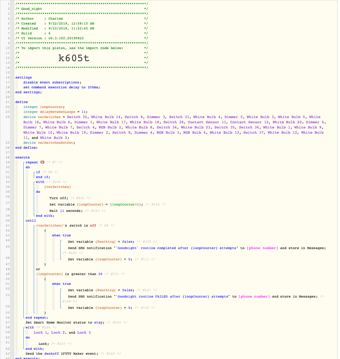

Could you help me out with one that is similar? I want to use the same idea, but this time to ensure all of my lights are out.
The following is not getting the desired result – It never gets to the point of arming SHM, and I get the error SMS that it failed due to looping more than 20 times.
Any thoughts on this?
Seems like {varswitches} is not registering as being ‘turned off’ despite the lights being off.
The following logs repeat several times.
Log:
9/26/2019, 10:07:06 PM +126ms
+0ms ╔Received event [My home].time = 1569553627690 with a delay of -1564ms
+183ms ║RunTime Analysis CS &gt; 45ms &gt; PS &gt; 80ms &gt; PE &gt; 57ms &gt; CE
+187ms ║Runtime (54297 bytes) successfully initialized in 80ms (v0.3.10f.20190822) (185ms)
+188ms ║╔Execution stage started
+400ms ║║Comparison (enum) off is (string) off = true (2ms)
+403ms ║║Comparison (enum) off is (string) off = true (2ms)
+407ms ║║Comparison (enum) off is (string) off = true (2ms)
+410ms ║║Comparison (enum) off is (string) off = true (2ms)
+413ms ║║Comparison (enum) off is (string) off = true (2ms)
+416ms ║║Comparison (enum) off is (string) off = true (2ms)
+419ms ║║Comparison (enum) off is (string) off = true (2ms)
+421ms ║║Comparison (enum) off is (string) off = true (1ms)
+423ms ║║Comparison (enum) off is (string) off = true (1ms)
+426ms ║║Comparison (enum) off is (string) off = true (2ms)
+429ms ║║Comparison (enum) off is (string) off = true (2ms)
+431ms ║║Comparison (enum) off is (string) off = true (1ms)
+434ms ║║Comparison (enum) off is (string) off = true (2ms)
+437ms ║║Comparison (enum) off is (string) off = true (1ms)
+439ms ║║Comparison (enum) off is (string) off = true (2ms)
+442ms ║║Comparison (enum) is (string) off = false (1ms)
+450ms ║║Condition #8 evaluated false (213ms)
+454ms ║║Comparison (integer) 21 is_greater_than (integer) 20 = true (1ms)
+455ms ║║Cancelling condition #151's schedules...
+458ms ║║Cancelling statement #236's schedules...
+461ms ║║Executed virtual command setVariable (1ms)
+467ms ║║Calculating (string) 'Goodnight routine FAILED after + (string) 21 &gt;&gt; (string) 'Goodnight routine FAILED after 21
+470ms ║║Calculating (string) 'Goodnight routine FAILED after 21 + (string) attempts &gt;&gt; (string) 'Goodnight routine FAILED after 21 attempts
+494ms ║║Executed virtual command sendSMSNotification (19ms)
+499ms ║║Executed virtual command setVariable (3ms)
