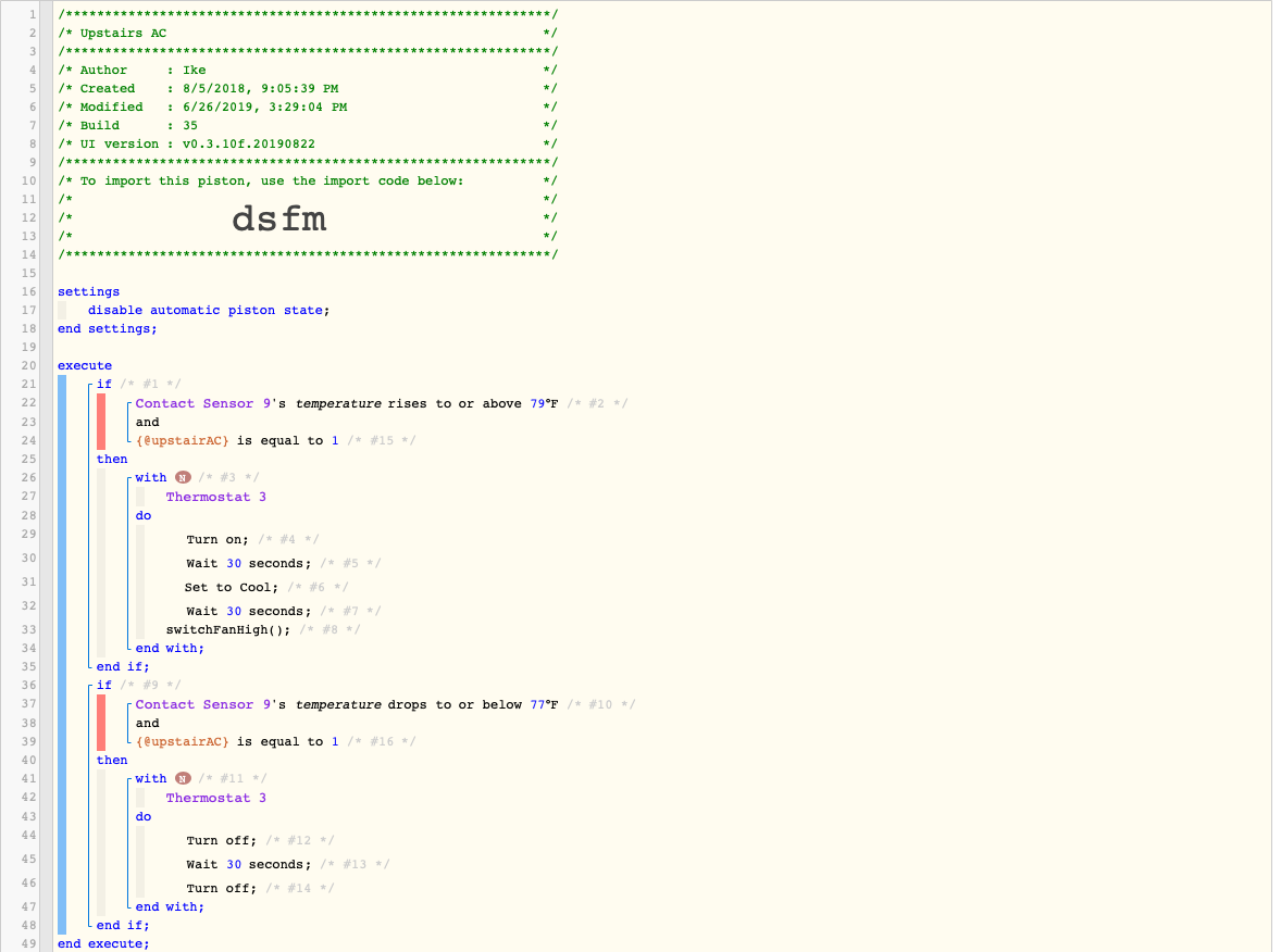

Here is an idea, I’m not sure if this is what you need but this is what I use for my AC in the house.
(I like to keep the house around 72,73)
Since you have Temp sensors you can use them, you just need to make sure that they are calibrated correctly.
IF sensor X temp rises to or above 72
With AC
Do turn ON
IF sensor X temp drops to or below 71
With AC
Do turn OFF

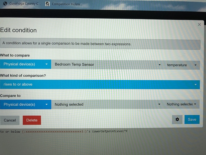

Is there a meathod of calibrating the sensors in webCore? @webCoRE_Minions
I would use a simulated device, with two slider tiles, one to set min, one to set max
that sound great one for upper set point and the other for lower set point.
Do you know how to knock that up? I have examples but they are vastly more complicated than just two sliders.

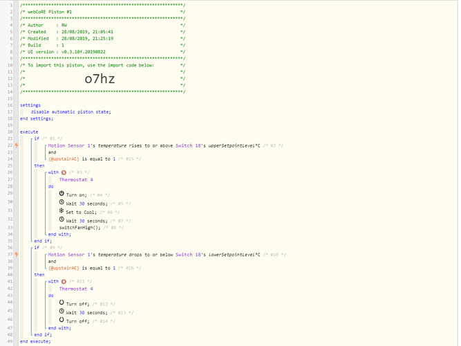

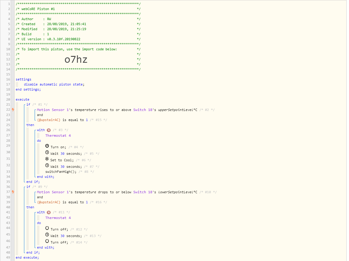

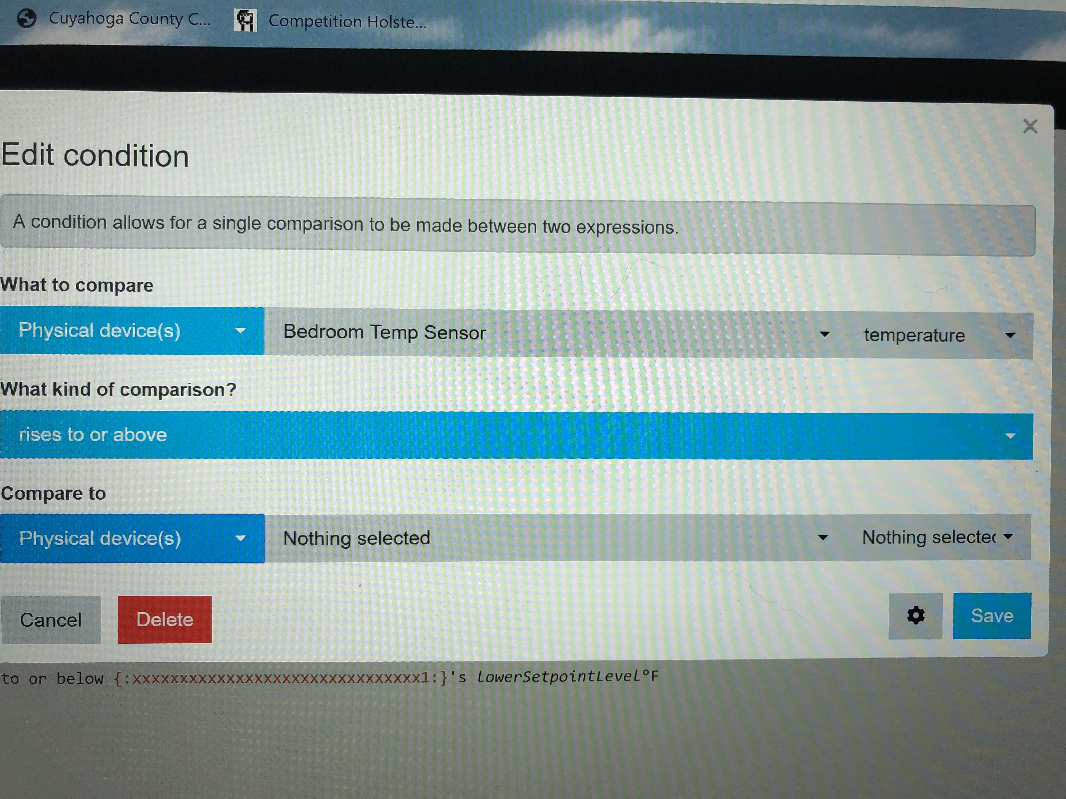

Sure thing,
Don’t mind the variable, that has a different purpose, you can do this wihtout it.
Robin, I put your script in my device handlers. Please tell me whats the next step. I have the piston I have the DH. i just need them to work together.
See below, switch 18 is my version of the virtual device.
Compared to what? I dont have a switch18. I cant find a virtual device.

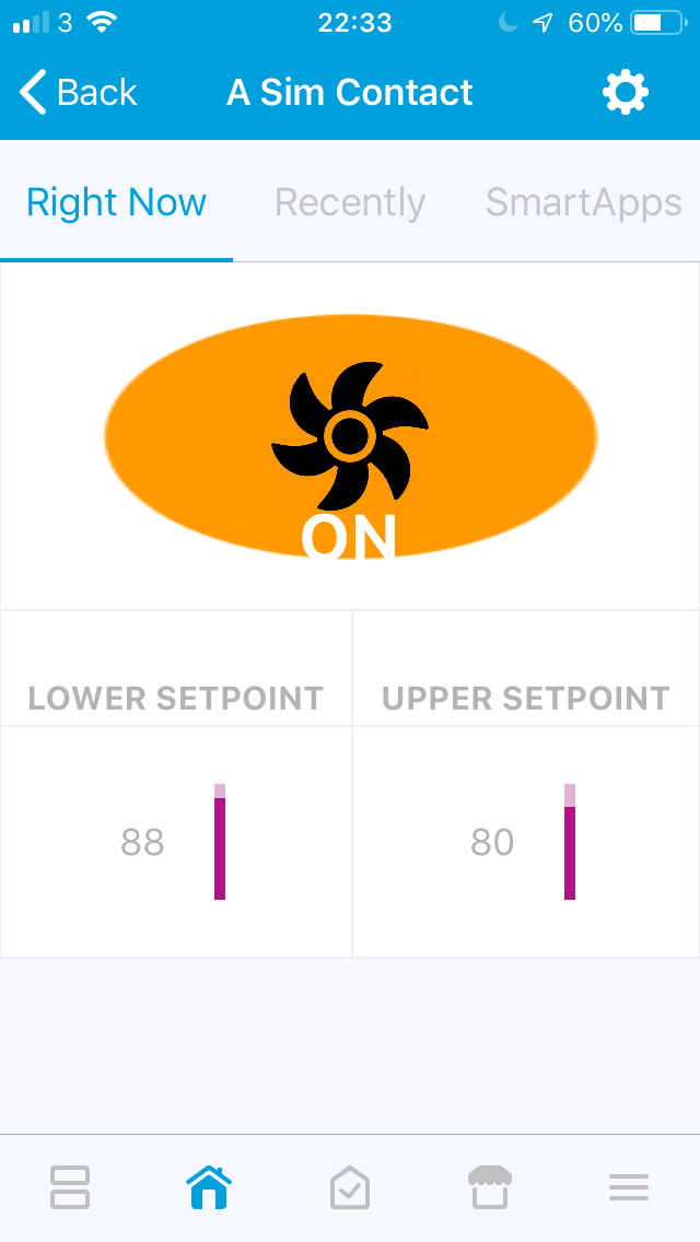

Hang on, have you installed the virtual device?
after adding the code to the device handlers tab in the ST IDE, go to my devices and add a new device, choose the ‘fan setpoints’ handler as the device ‘type’, something random for the network ID.
Note that the webcore dashboard and the ST IDE conflict with eachother when adding new devices manually, use a different browser.
After adding the device, go to the webcore smartapp in the ST mobile app, and add the device to webcore.
Then refresh the webcore dashboard and select your new device where it currently says ‘nothing selected’

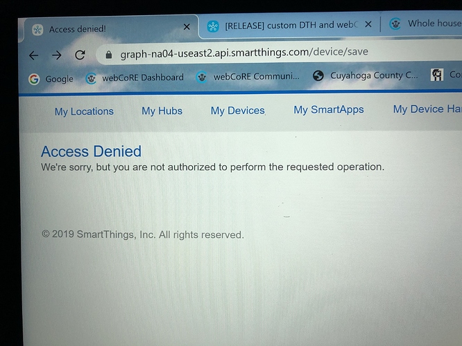

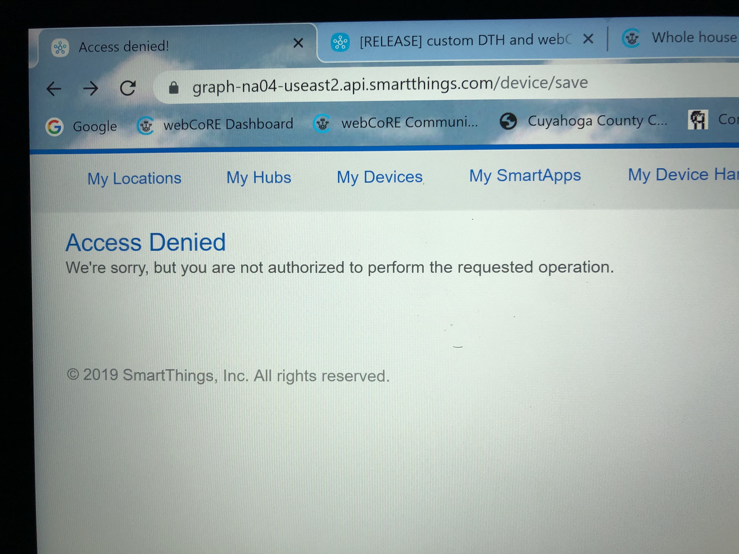

#15
I used the laptop as IDE and my phone as webCoRE
#16
That is the error you get when webcore dashboard is running on the same browser… try clearing cookies or go to dashboard.webcore.co and click log out
#17
… or use an Incognito / Private browsing window…
(my preferred method)
#18
is that working again? last few times I tried it wouldn’t let me log in to the IDE
I use Chrome for everything, but crappy Microsoft edge for the IDE lol
#19
temp
has never failed for me… (Firefox)
#20
yep, working for me again now… they deployed incognito recognition software a while back and started blocking login attempts… but I read somewhere that Google were working on a fix to prevent detection… must be fixed now I guess
