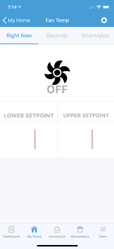

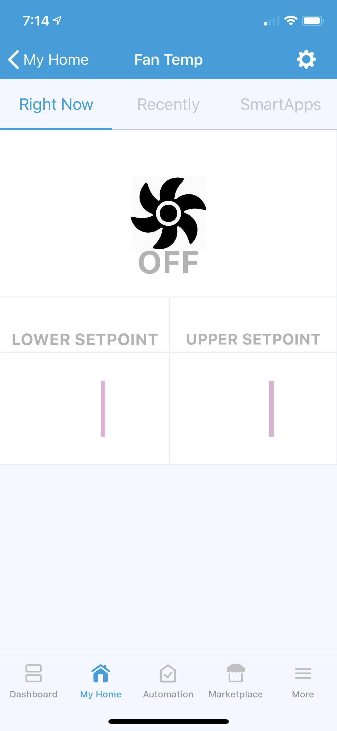

Something is missing. There is no sliders
Edit: I see you have to tap on the sliders to enter a value.

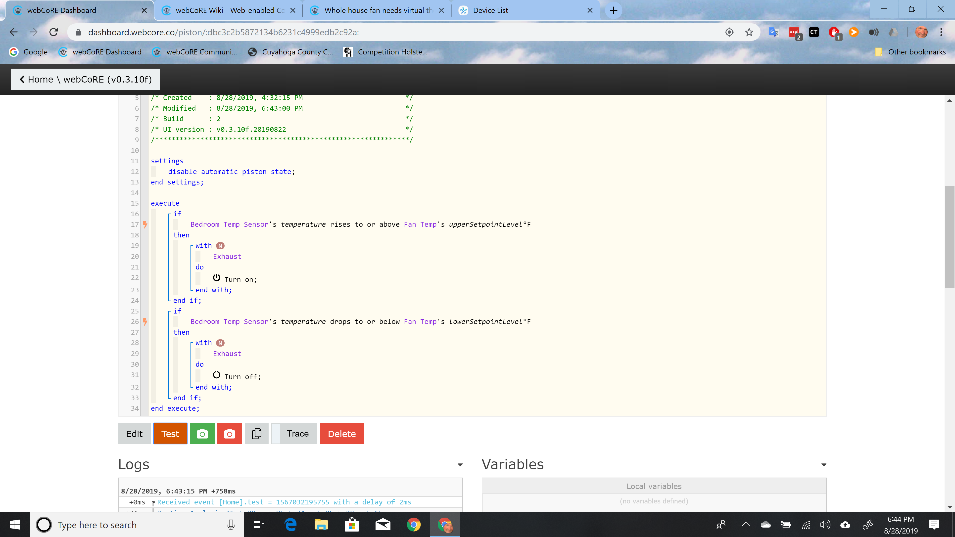

Edit the piston, then click âadd a new conditionâ in the position of line 28.
Choose âIF switch is onâ

I am having zero luck with this.

Comparison 74.0 is definitely above 69.
I apologize for interrupting, but a quick observation:
The command:
IF X "rises to or above" Y
is a trigger. (a precise moment in time)
This means for it to fire, it has to first be the opposite.
(IE: For the state to change, X must begin less than Y)
The piston will run when X rises above Y, and will not be true again until a full cycle has happened
Same with:
IF X "drops to or below" Y
will not fire unless X starts out greater than Y
This logic functions similarly to the command:
IF Lamp switch changes to on
Which will only trigger when going from off to on.
(not when there is no change going from on to on)
Basically, with your current code:
- When X changes, the comparison will be made
- If the IF block stays true (or false), then no commands are executed
- When the temp crosses the threshold, the commands beneath will execute once
- Furthur commands will not run until the the
conditionshave inverted
If what youâre saying is true then itâs not a very good thermostat piston. The room would have to cool down below the set point and then rise to or above to work. My wife is kickn my but because I canât get the fan to work the right way so she puts it in manual and by 3am itâs 62° in the bedroom and we are both shivering.
This was exactly what you asked for in the original post
The only time you might not be happy is shortly after a recently edited piston. Depending on the current temperature, it may temporarily get out of sync. (the piston has to be functioning at the moment the threshold is crossed to capture the change)
Pro Tip:
If you make your edits when the temp is inside the â5 degree windowâ, your fan will never get out of sync.
If it ever does get out of sync because of an edit, you can just manually turn the fan on or off once⌠The piston can take it from thereâŚ
