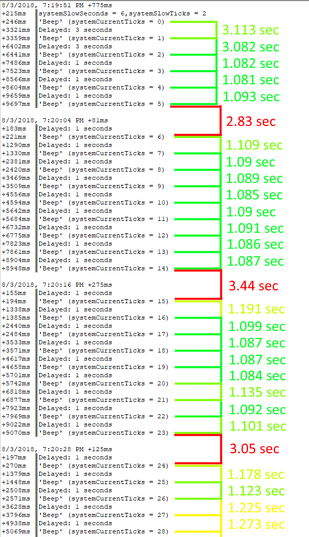

You can see this clearly in the log, which I’ve linked at the end of the post. To make it even more obvious where the problem lies I rearranged the logs to be completely chronological (I don’t understand why they’re printed in the fashion they are), calculated the delay between each piezo beep, and marked each delay on the logs themselves:
As you can clearly see the extended delay occurs every time that webCoRe pauses to dump the next set of logs. To see if this was slowdown sheerly due to the fact I was printing debug info for this piston, similar to using the expensive printf in any real language, I tried removing all of the logging statements from the piston, turning off the trace button, and closing the browser tab for that piston that was monitoring it yet the problem is still present, exactly the same.
Like I said previously, I have linked the full logs if you need to see anything else, but the above picture pretty much covers it. Again, it seems to me that unless there is a way to customize how webCoRE handles logging that this is simply a limitation that can’t be worked around except by jury rigging the crap out of my piston code so that it accounts for this delay every 10 seconds, which would also limit how quickly I could beep the piezo and is overall just non-viable.
